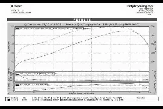

Pulling the heads in one hour but I found a dyno slip from the PO. Shows the car making about 450HP and 500ft-lb of torque... Dear God. This seems like too much for a 302. Could that power output be block splitting territory? This thing is setup with an on3 turbo kit

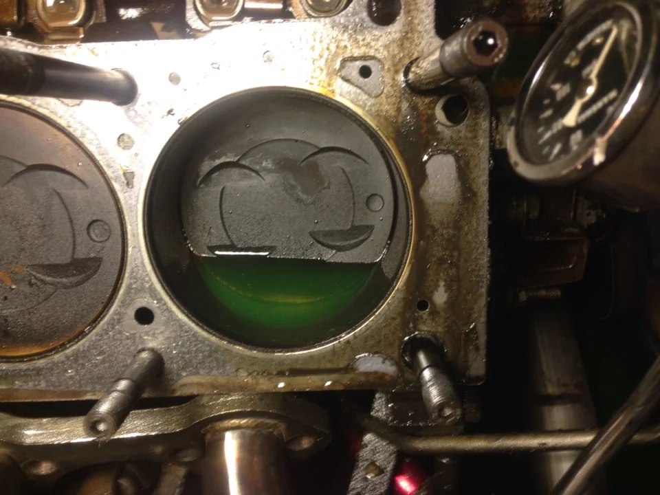

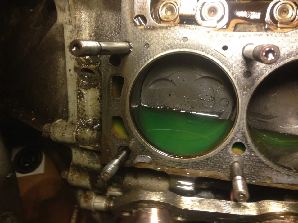

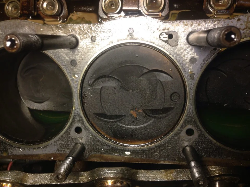

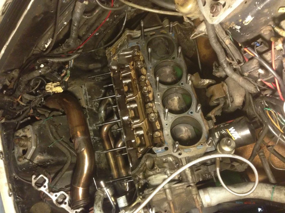

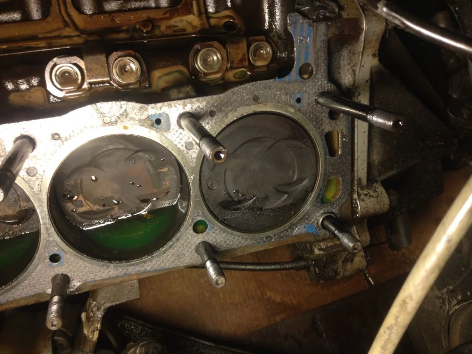

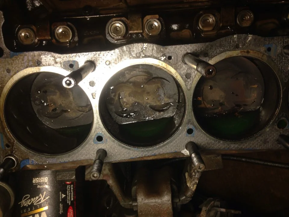

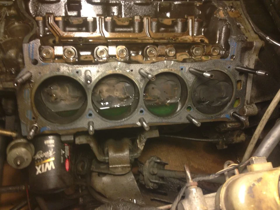

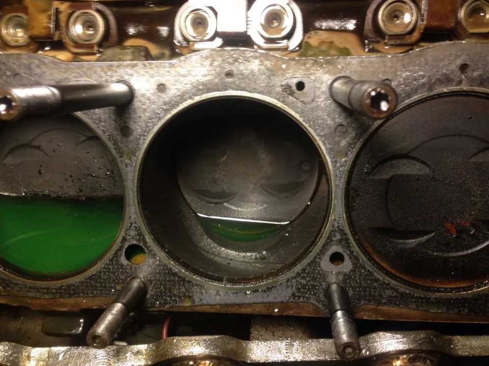

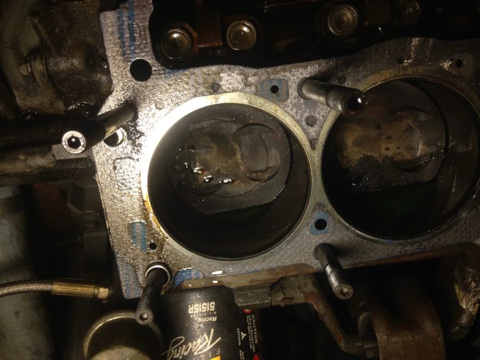

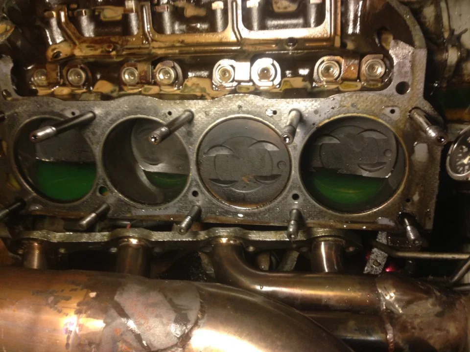

Alright got them off Friday night. Gaskets look fine. It took forever due to the stupid turbo kit being in the way of absolutely everything. Finally got them off at about 4am. So that being said: I didnt see anything wrong, but I was super exhausted and could be missing something. Doesn't look like coolant is touching the cylinders tho. Here's some pics. Gonna take the heads to a machine shop tomorrow. Should I ask for them to check more than straightness?
As you can see a lot of coolant spilled. I soaked it all up and applied motor oil to the cylinders while the heads are off. Any tips for checking the cylinders while I'm in there? Also how do you all clean up the deck surface without air tools and without screwing up the surface.
Have them check for cracks and straightness. It's dangerous having heads milled without knowing how many times they have been milled previously. I would imagine they have been milled at least once before as they were taken from another vehicle and put on yours at some point. Normally a shop will take a standard 10-20 thou off at a time. Depends on the machinist. You run into trouble when you mill over .040, some get away with .060. I'm talking about e7te stock heads though. I don't know if this is the same for GT40's. Research. Point is, without blueprinted heads you never know.
So if you do get heads milled, make sure you check P2V clearance when you put them back on. Keep your old gaskets in order to do this.
Do your head gaskets have any brown/black burned marks on them? Usually the material is burnt through and you can see the inner honeycomb of gasket. Usually around the fire rings maybe water jackets. This is sign of a problem, hot areas.
Clean deck surface with scotch brite pads. Going to need a couple packs. It takes a while but you can get them pretty clean. Hard part ain't over yet.
