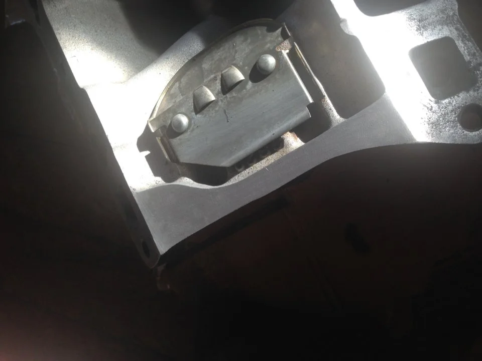

As for intake. I want to get them milled anyway because of some pitting I found on water mating surfaces. How can I make sure it will still fit properly on the heads?
In this pic you can see some of the pitting. could this have cause my coolant leak?
Bolts. Lots of guys use the Allen head bolts with lock washers. Then use the pivot ball Allen wrench. These guys work in the tightest of areas! I have pics if you need.
Intake. Yep pitting can cause leaks but if you used silicone that usually seals up the pitting. I usually smear a thin coat of silicone around the water jacket holes along with the intake gaskets for good measure.
If you machine the intake too much you will need to have the heads machined along with the intake so the two mate up with each other properly. If not the angle is changed and it will leak. Has the intake in its life ever been machined? Blueprinting is important for these reasons. I think it's allowable up to .020 before heads need matched. Don't quote me on that number. A good machine shop will know.
These dont look like they've seen a mill since the day they were made. I put a nice glob of sillicon around those ports and used the best felpro's I could find. So far no water leaks but thats not gonna stop the oil coming out.
