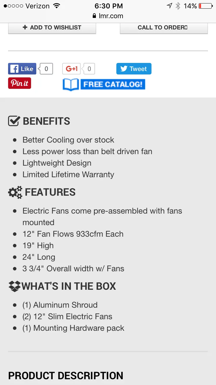

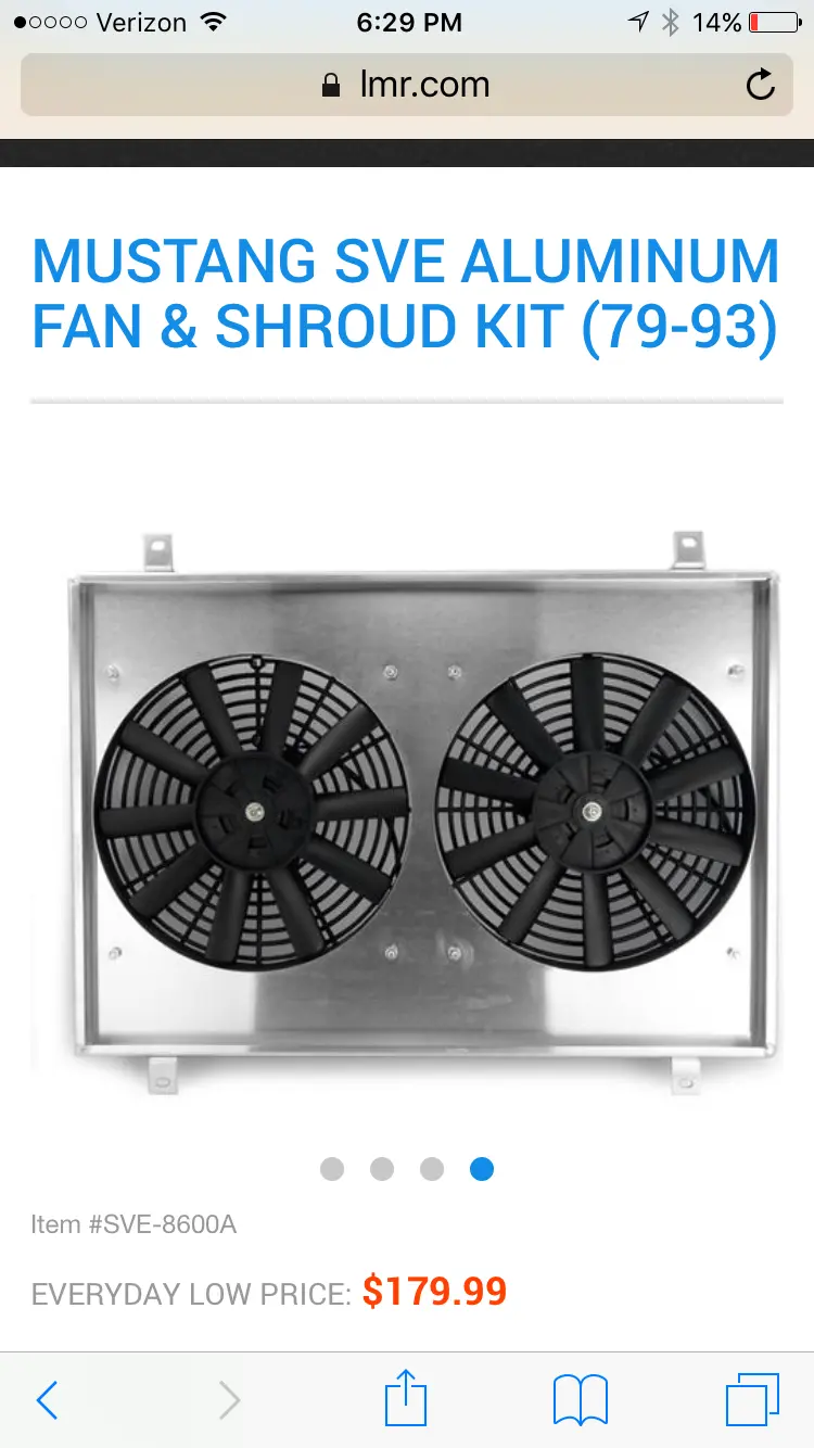

These are the fans that I have installed as well I wonder if this is my problem they only have a combined 18-1900 cfm

  • Jun 20, 2016
Only flows 1860 cfm??? I would be looking at something that flows 4k+. I'm not even sure I'd put that on a stock 5.0

MikeH686 said:
Yeah it was fine with my t5 and a two row I'm wondering if between the intercooler being in the way and switching to c4 had anything to do with it I just put the deflector back on and drove it. It helped but still not any better
Lose those fans dude. I did the same thing with mishimoto fans. They didn't cut it, and had the same cfm rating. Went to a contour fan set and no more problems.

I just took those fans off my car. Brand new 3 Core aluminum radiator with that fan and shroud. Car ran to 220. Took the fans off, put the old ones on,190 during a 95 degree day. Now, needless to say, I was pissed. What a waist of cash. I'm gonna try vamping the shroud for the old fans, fingers crossed.

MikeH686 said:
@Boosted92LX what fan do you have
1996 ford contour v6 fans. Had to buy some aluminum angle to make mounting tabs, but with the exception of 1/2" uncovered core at the bottom of the rad it's a perfect fit. It outflows those 1800 units by a long shot. By how much has been debated for a while here, but let's just say they do the job, and cost 100 bucks new from rock auto. Like @stykthyn says, taurus fans are supposed to be pretty good too, but I've never used them, haven't seen them or any data on them. Maybe someone else can step up there.
It's not published data as far as I know. Internet rumor is 2500cfm at low speed and 4500 on high. Im dubious it flows that high, but real world performance I could see 2k on low and 3k on high speed.
Also- you reversed the water pump rotation...did you change to a pump to match the rotation? There is a difference (in case you weren't aware.)
Great just bought mishimoto dual fans....
Sent from my iPhone using Tapatalk
I imagine they'd work on a stock engine, but they won't cool anything making hp. If they're still in the package do yourself a favor and send them back. Otherwise you'll be losing $$$
I've read everything from 1800 (which is bull) to 3000. Lots of conflicting info.
