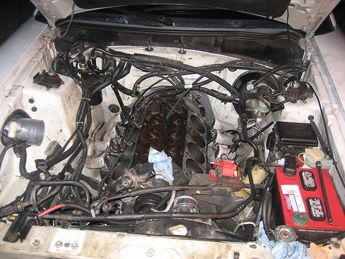

Went to the dragstrip again today looking for some better times but didn't quite get what I expected.
First pass was an anemic 12.6, felt like the car laid down up top. I was beside a LOUD drag car so I didn't hear much of mine. Temp gauge was on the "OR" where it is usually "NO". Looked at the datalog after but all was good. Attributed the temp gauge to the 80deg weather.
After that I ran another 12.6 then a 12.49. After the third run I popped the hood and saw my overflow bottle was not at the level I left it at. :D
My wideband took a crap on me so I didn't know what I was running in the datalogs (all else looks good). Timing was 21 working down to 19 up in the RPMs. Commanded AFR was 11.7. Previous runs showed the AFR floating between 11.6 and 11.8 throughout the runs.
Sam and I busted it down to the block in a little under three hours. (Thanks Sam!)
Tomorrow I'll put on the heads, intake and longtubes I've had sitting around waiting on this day. I had already bought the head gaskets etc etc in preparation.
It looks like these are the original head gaskets and valve cover gasket. I highly doubt the valvecover gaskets were ever off the car in all 137,600 miles of its life.
Here is a pic of the front and back of the head gaskets: http://www.flickr.com/photos/wesratcliff/sets/72157603360816671/

I kept pushing the envelope to see how far I could take it -- guess I found the limit. It was just a matter of time before the stock stuff said "no way". :-D

Wes, I'm sorry to hear about this buddy. Like Eric said (and you and I discussed some time ago), this gives you an excuse to put those nice parts on.
You put down some impressive times and performance without ever having had that motor apart. :nice:
That nice big TB was the cause. :rlaugh:
Best of luck with getting it all square. Knowing you, it'll take a day at the most. :banana:
I'm looking forward to having the heads and ported intake on. I also need to put on my external fuel pump to keep up with the extra fuel needed.
The longtubes look like they are going to be a pain (again). Even with the heads off. I messed around with them a bit and they are getting hung up somewhere. I may just pull out the engine hoist and pick the engine up a bit to make them a drop in affair. Dang automatic.
Wes
