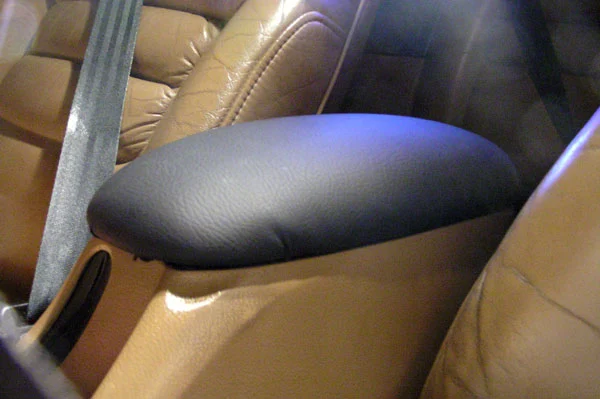

Its The Picture that says a thousand words
Here it is it's what you've been waitng for. I took a pic for the guy. it's a kickass ride. It feels like thats whats happening when you hit the nos.

wow, that fabric is awesome! looks good!

are you sure the vinyl won't stretch after a few days or if it gets warm...
i'm not sure if my vinyl was the same kind, but i got it from joann fabrics and it stretched on a hot day

we'll see,I can always repull it,it really is simple.
