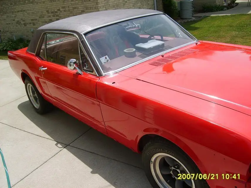

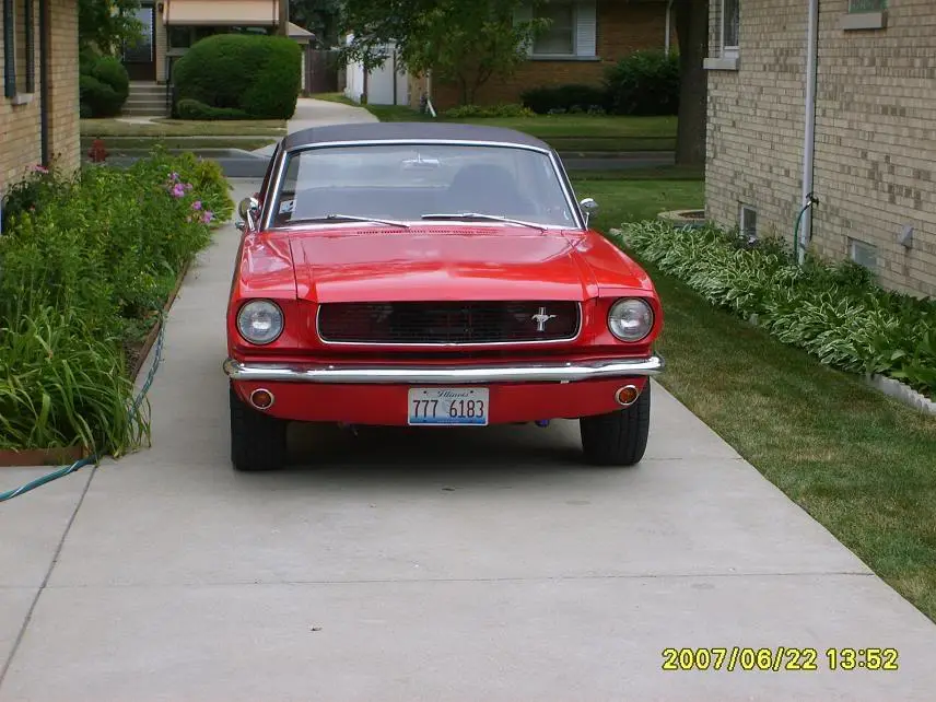

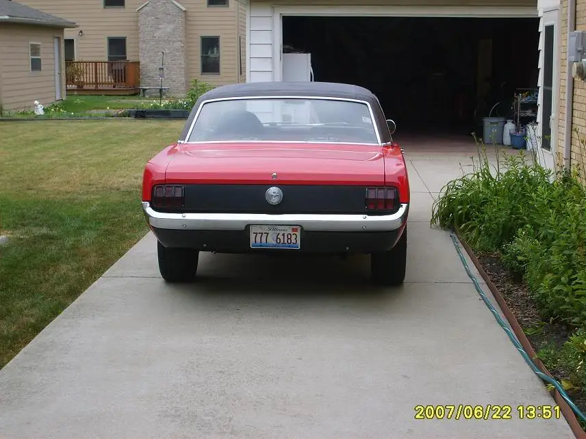

Finished up the paint last night, and took it out of the garage this morning. Some minor hand polishing and this is what I got.
Going to let the paint finish hardening a lot more before I really polish it up, and maybe wetsand.... but it looks pretty damn good the way it is if you ask me :D
let it sit about a week... an easy test, it in a spot that wont be too visible, take a piece of 600 wet or dry and give it a few strokes... if the paper comes away with little balls of paint on it, it is still too soft to sand. if the paint comes off like a powder, you are ready to give it a quick cut and a buff. looks good btw...
