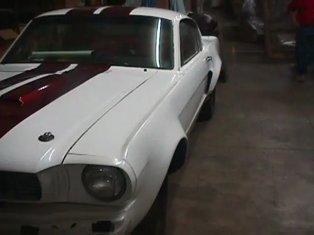

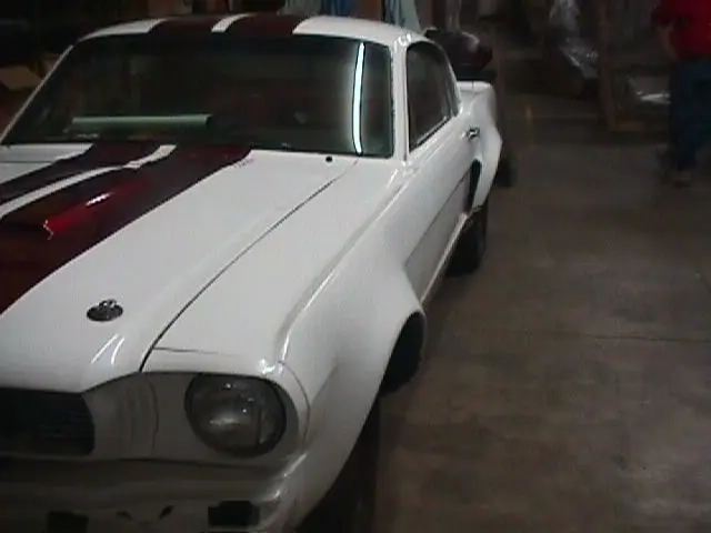

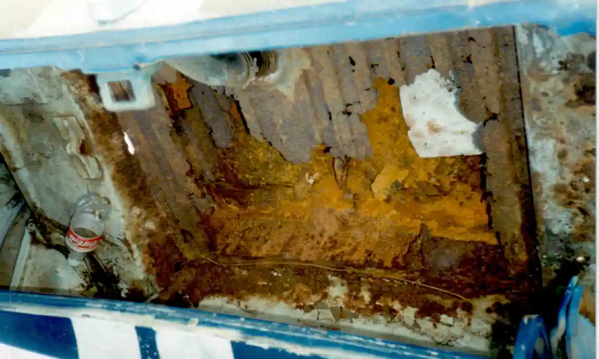

Hey guys, I just visited the body shop that is working on my car, and these are some current pics of it.
This is under the front end, the part that the bumper covers up

Edit: as you can see the previous owner did a great job covering all that up,
See the original red paint underneath?

Well, there are spots that the painter pointed out especially on the passenger door where it is completely filled with bondo like you knock on it and its hard and not hollow. There is rust in the door places, there are small bits of rust bubbles coming out but we'll see its true rust spots when the paint comes off.

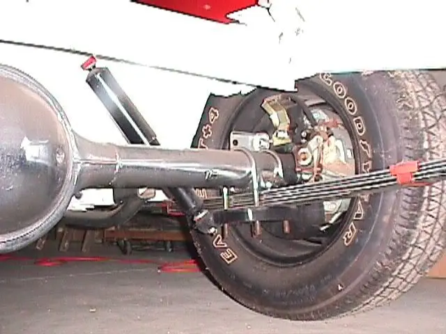

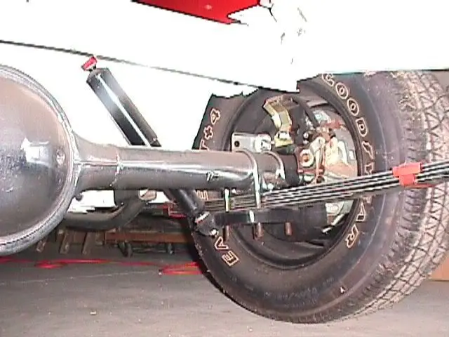

Here are pics of the rear wheel wells

Edit: no doubt it, this car is in great condition for it's age, the previous owner had it since 1968, and its been garaged a lot of its life he said he drove it like 2 miles every other day. and we got the car as a steal only 6k. But there are things that he either did himself and ended up doing a mickey mouse job or he didn't get done correctly. For example the wiring inside the car is absolutely fugly, he installed an aftermarket stereo (thankfully he left the original one there) but in order to do so he completely messed up the entire wiring harness now there are tangles of wires hanging down above the accelerator pedal. As you can see he didn't bother to take off the original red paint before putting on the expensive pearl white paint, and looking at some of hte body work he didn't do the body work correctly. This summer, i'm planning on cleaning up the engine compartment.
as far as him painting over the original red paint, that is a fairly common and accepted practice actually. unless you are doing a complete resto and the original paint is in decent shape and not flaking off it's actually better to scuff the original paint, prime it with a good sealer primer and shoot the new paint. there is less chance of having sanding scratches show through the paint that way. nothing wrong at all in painting a car that way, though when doing a color change it is generally better to pull the car completely apart and paint everything.

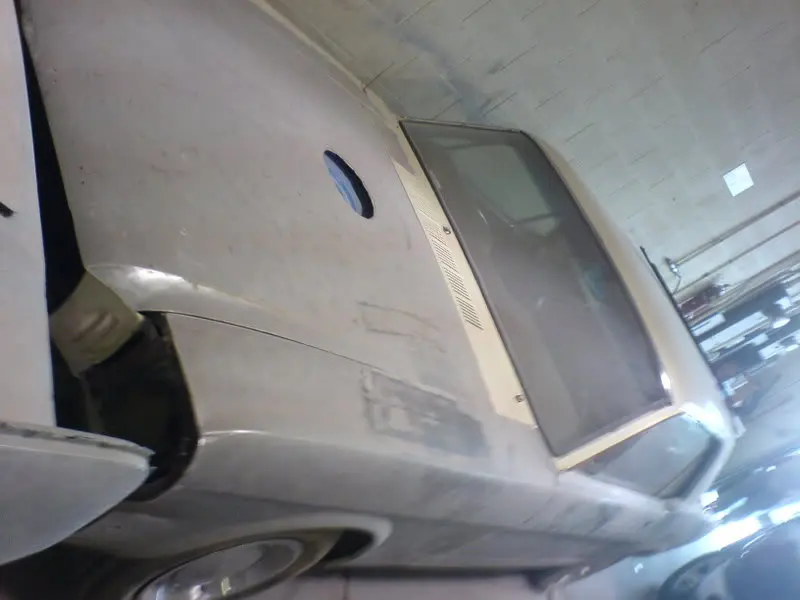

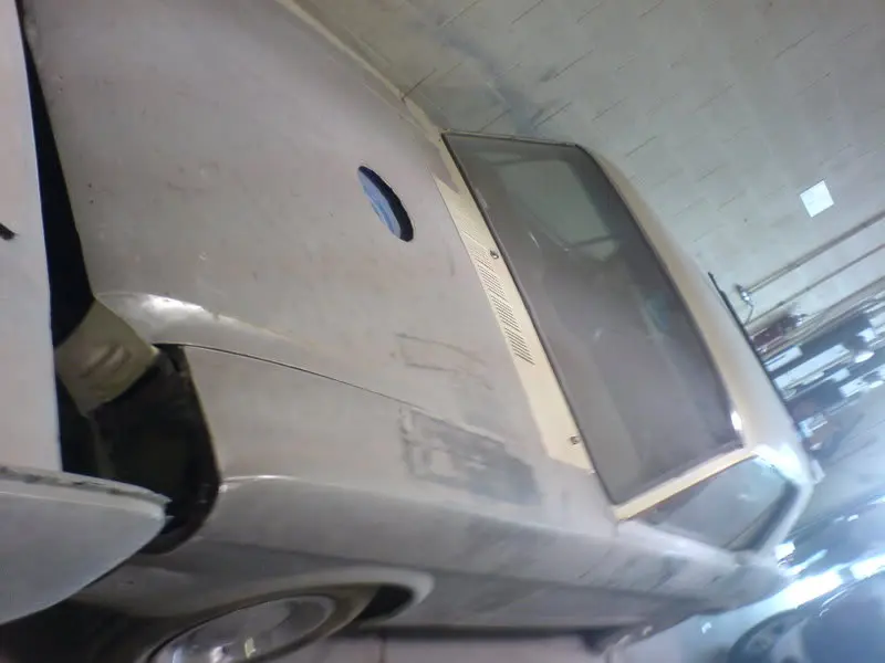

Just got bak from the painter, and he had 95% of the old paint stripped off, and yup surprise! the car had been in either a series of accidents or had a lot of damn dents or somethin! It looks as if some1 shot a shotgun in the front and in the rear quarter panel (no holes just sharp dents). There also these holes along the top of the door under door handles. I'll take pics sometime this week. Good thing is that there's no rust. BAd thing, the scoop is total fiberglass and bs, so he's planning on making one out of metal and sticking it on.

He told me he will use as little bondo as possible, he will take off the fender and roll it as straight as possible. However, he himself is not working on the car so i'm not sure.
He said that he'll start the body work tomorrow, and then hopefully by next week it'll be painted and i'll get it back and then i can get stuff like a wiring harness, subs, etc... Then summer i'll pull out the engine and paint it.

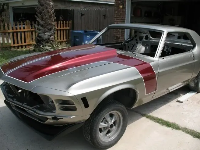

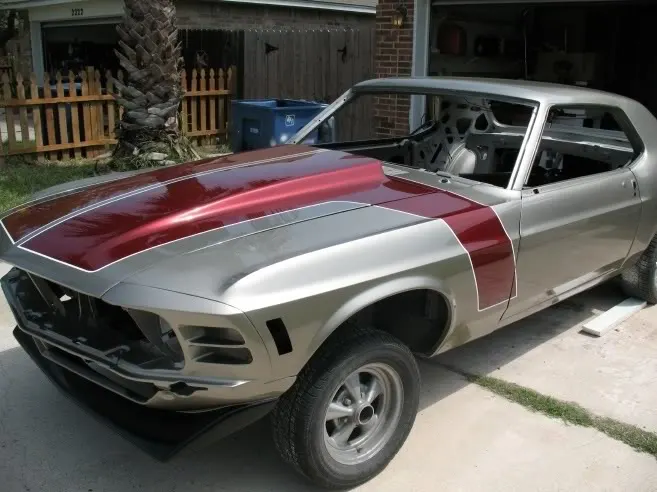

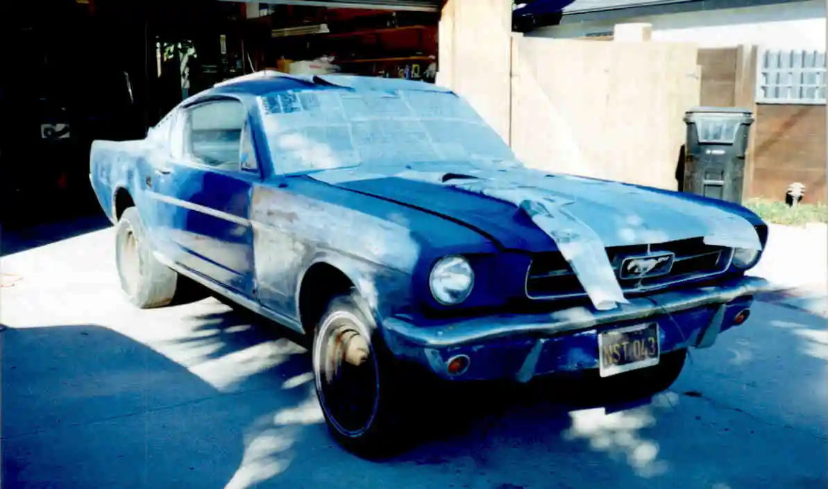

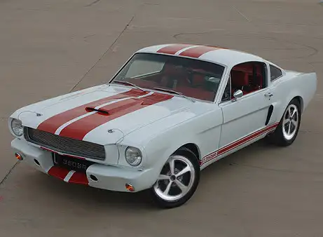

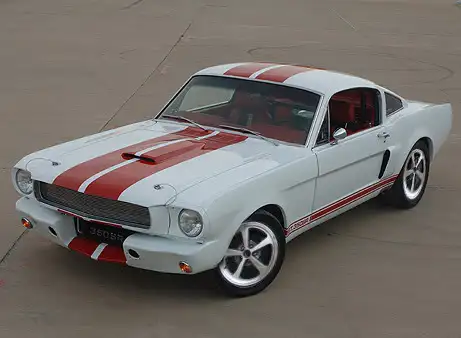

I need your help on paint choosing:
These are my three choices.
Originally I wanted this:
But then I saw this on another thread but I don't know wat color it is, I like the fact that in the dark it looks extremely dark but then when light hits it it is actually a really rich red, which you can see in the second pic if u look at the top.
And finally:
