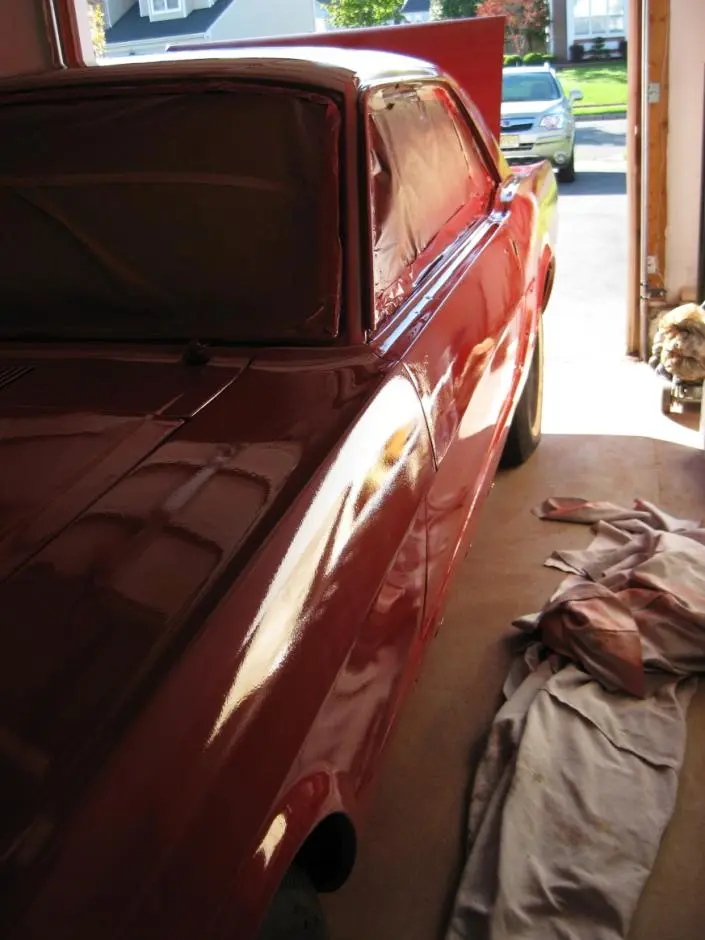

Well, I finally did it. I picked up Dupont chroma bc & cc and painted the car yesterday. I used 1/2 gallon of base, along with the basemaker, for a total of one gallon. It was just enough to cover the primer. After that, I shot 3 coats of clear and now I'm done. I'm happy with the results with the exception of 2 runs I put in the clear coat. I was trying to rush things, I guess. I've sanded those out this morning and shot some more clear over those spots. For a home garage job, I'm happy with the results and I have attached some pictures of the car.
I have a couple of "dry" spots and I'm wondering if they can be buffed out. If so, what should I use? Wet sand and then compound, or just compound?
