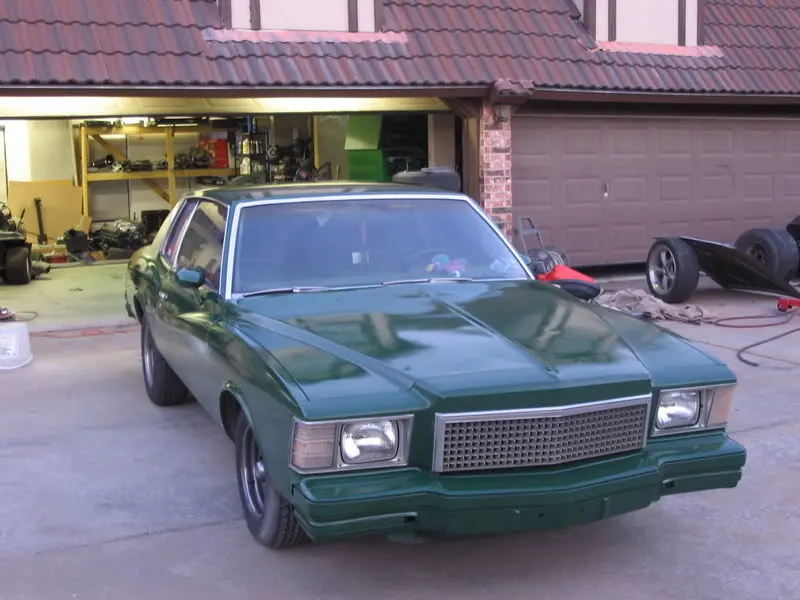

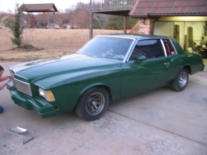

oh...the $50 paint job... We started one of those on my buddies ugly A** 79 monte carlo... I dont have before pictures but it was UGLY The front end was crappy rattle can primer black from being in a wreck and getting junkyard pieces. The back end was a fading olive green color with a white 1/4 top.... We started with the rollers for giggles and after 2 coats we had enough of that. I got out the HVLP and sprayed the damn car. It was taking WAY to long and I dont have anywhere near that amount of patience. I sprayed the thing with 3 coats and then we started the wetsanding and gave up 1/2 way... well I did anyways...heres how it looked without being sanded..
original ugly green
Was it an improvement..heck yeah it was. It looks decent but Im no way proud of the work. Also have a 66 coupe that needed some color. The bodywork is still lacking and needs professional mud work. I did the best I could but it wasnt enough. Heres some pics of that car.
Moral of the story..if you can...spray it

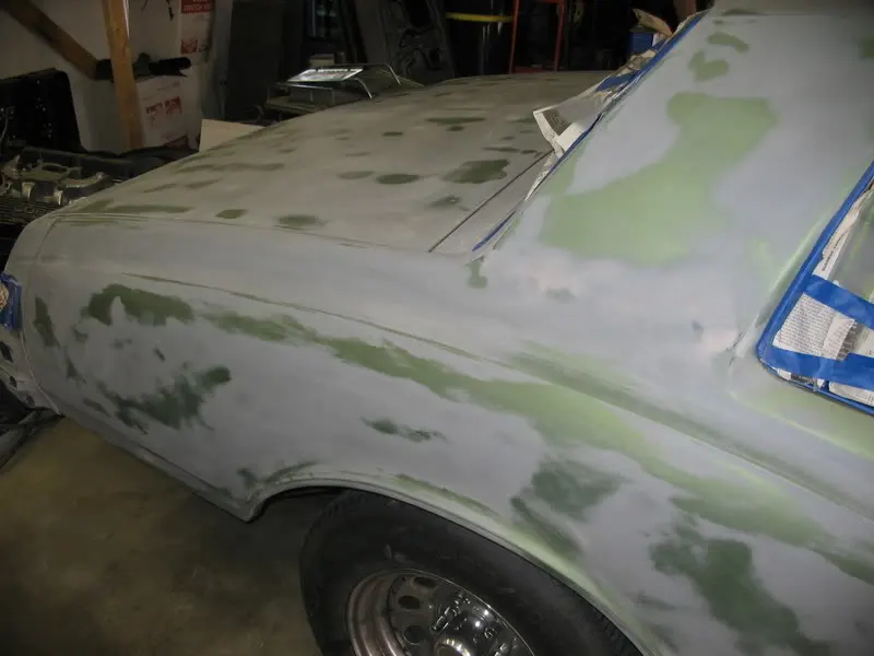

Here Goes Nothing!!
Here Goes Nothing!! I am doing the stang
Okay, I learned 2 things.
1. The buffer is your best friend. I bought a Ryobi orbital buffer and used it on the panel I was painting. That thing shines now. Up until this point, I thought the wetsanding w/ 2000 grit was supposed to make it glossy. Nope, it is the buffing afterward.
2. YOU MUST SCUFF THE SURFACE BEING PAINTED OR IT WILL NOT STICK.
After I finished the panel, I redid it again just to test some more but I didn't sand the surface and today I was able to peel off all the paint from my 2nd tests in 1 complete sheet. So I re buffed the remaining paint underneath and it is beautiful.
So I am going to do the stang and I am planning on about 2 months to do it. In the mean time I will be saving for a Macco paint job in case I screw this up royally.
