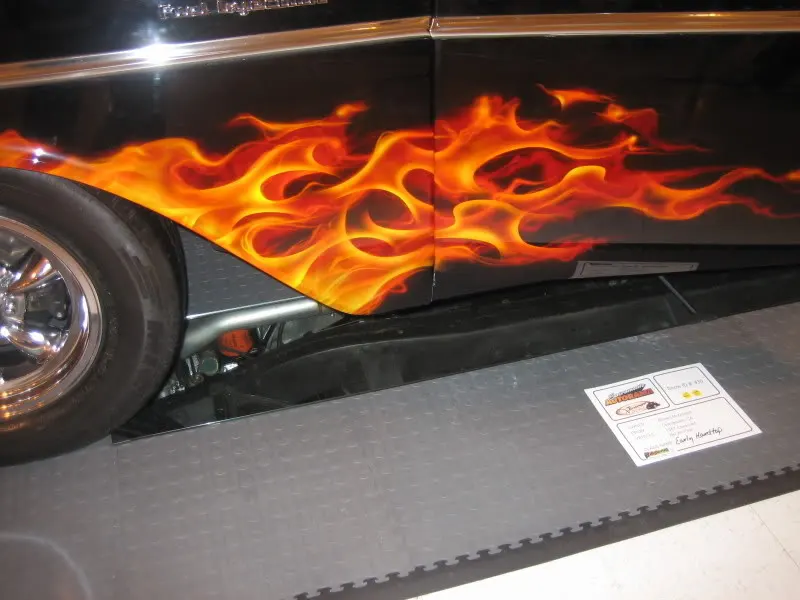

Only get flames if he can make them look like this, I gotta admit these flames look sick. And on a blue car, I dont know.
Im not a big fan of flames, unless they are the flames that look real, & still flames just look cheesy to me. I would just repaint it true blue, but only after you see some of his work to see how good he is. You dont want your car lookin like u went to Maaco.
no kidding...those flames look badass!
but if i get flames i would get them silver...kinda greyish
like "ghost flames"
