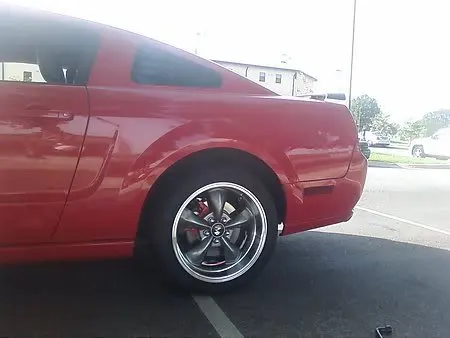

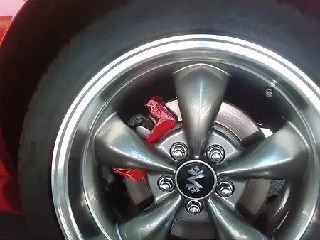

my rotors
Opinions.....?

Purdy....
What about the front?

same as the back, red and black. Ill take a pic later today while im out doing the right side calipurs.

Myponyisred said:
Opinions.....?
Could you please post some more pics of your rims set ups also showing the brakes. Also, what rims are those on the rear and what size tires, and are they the stockers on the front? Thanks in advance...looks awsome!
