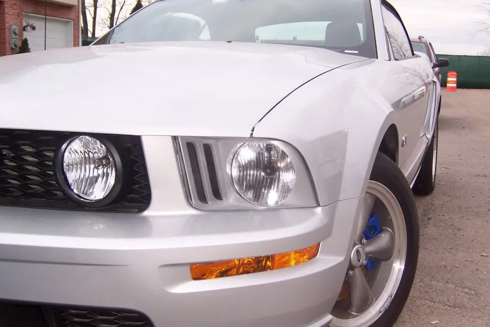

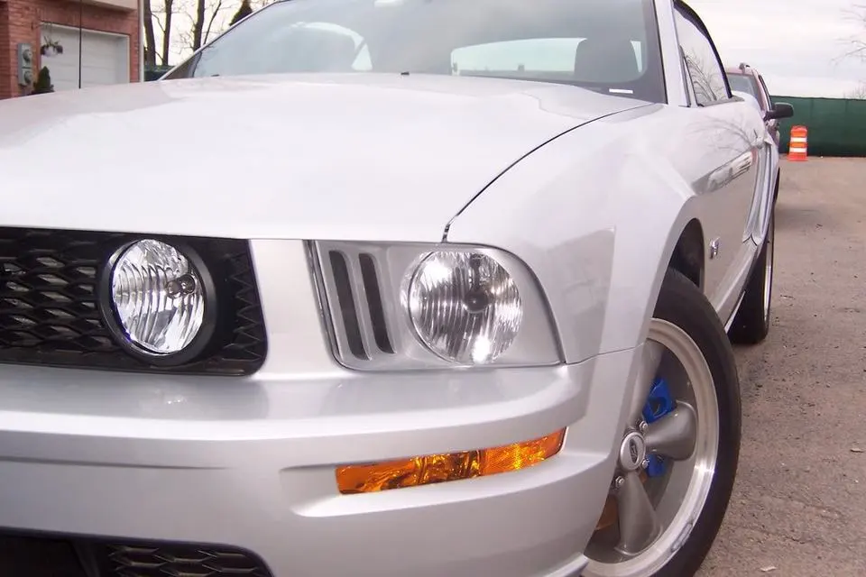

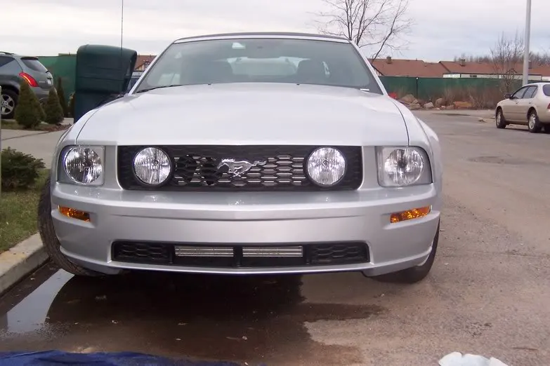

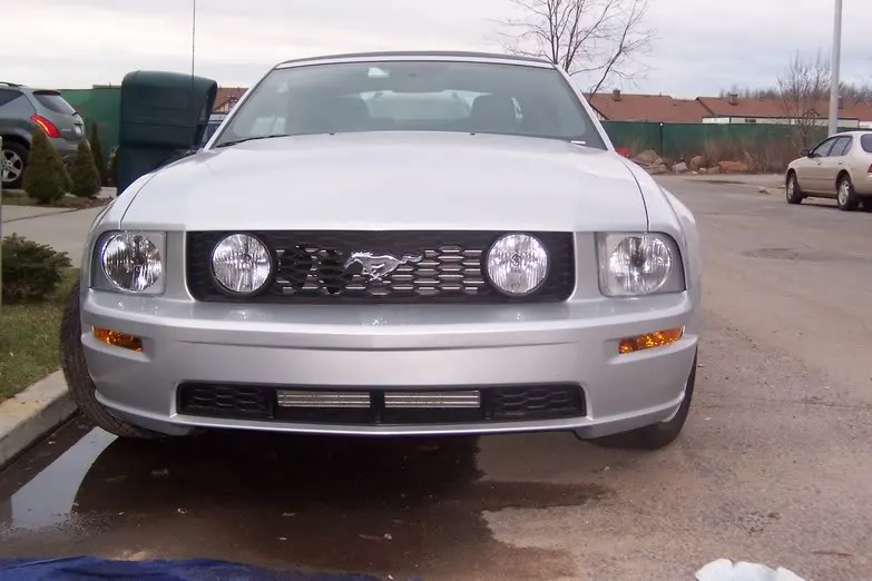

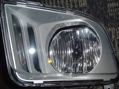

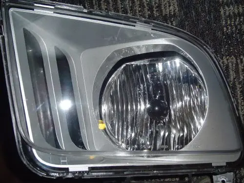

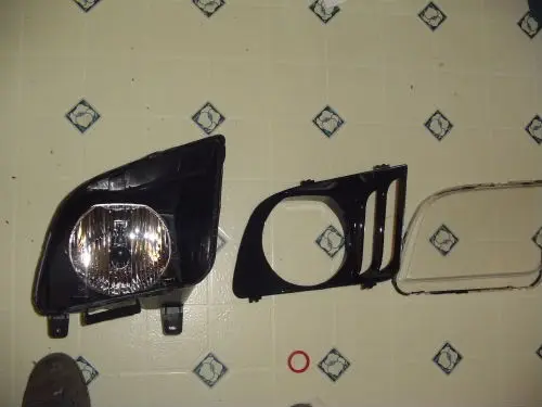

So yeah i got a set fothese apart, and i painted a set for a guy, figured I'd show yall
I seem to have been the only person whos done this on the mustang forums i belong to ( TMS, YMR and modularfords)
anyay if any1 wants a set done, PM me and ill get ya set up - Roger

nycstang37 said:
any water problems, fogging or anything? wanted to do that since i saw the foose stang on overhaulin
It was my mustang that he painted the buckets for. Definately was a great work. Havent had any fogging or condensation but havent had any rain until today. I'll check and see tomorow. I dont think that there will be though, Roger sealed them up really well and I doubt that water could get in.

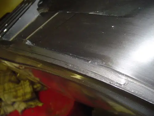

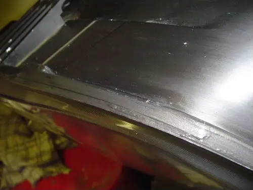

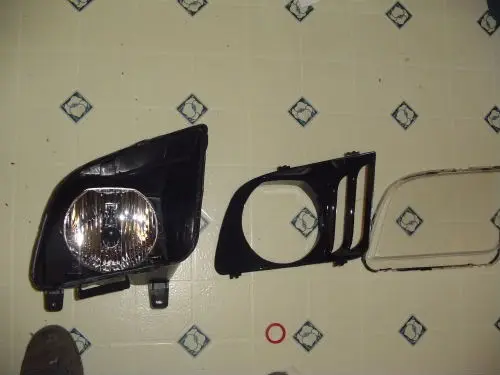

I tried it, I got all the way to the part where you hae to take the lense off, basiccly you just have to use a box cutter to break the glue, its pretty heavy duty.
red05v6stang said:
put it in the oven on about 200-250 for long enuff to get the clue to soften up and pull the casing and the lens apart from one another. its not something new.
sorry i forgot i posted pics over here, lol
yeah i heated them at 220 for 20 mins, then had to seperate them, its not exactly the easiest thing. who ever used a box cutter, i dont know how u did tht, cause te cover and the bucket fit togeher, the bucket has a channel for the cover to fit into.....so i dunno how he cut it out, unless he cut the cover......
