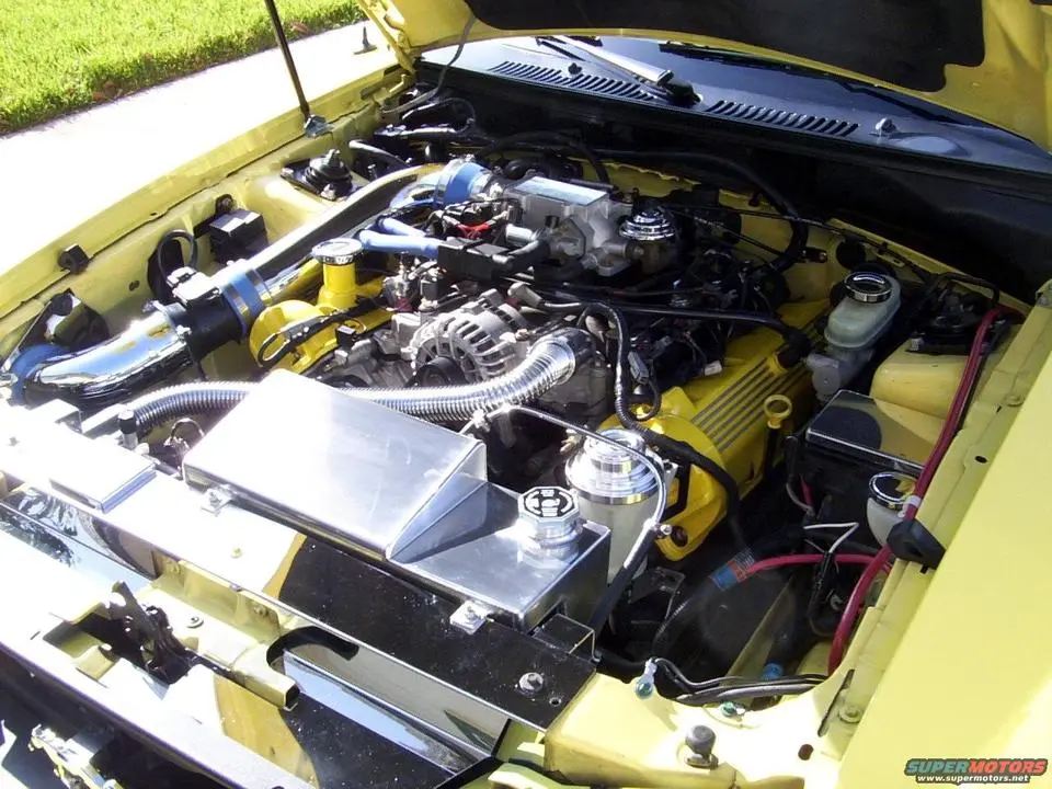

Well this thread was lost in the crash of 05, but since I never got around to posting pics of them on the car here goes.

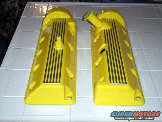

1st I Primed with Hi-temp engine primer, then undercoated with hi-temp white then top coated with yellow brake caliper paint. I did the white undercoating only to bring the color to a closer match to my Zinc Yellow GT.
Hold your horses, don't think that this all happens overnight. I picked a 2nd set and painted them over 3 weeks. Each coat should be allowed to dry for about 5 days. If you try to remove, clean/prep,primer,color,reinstall over a weekend the time spent will show in the end result.
