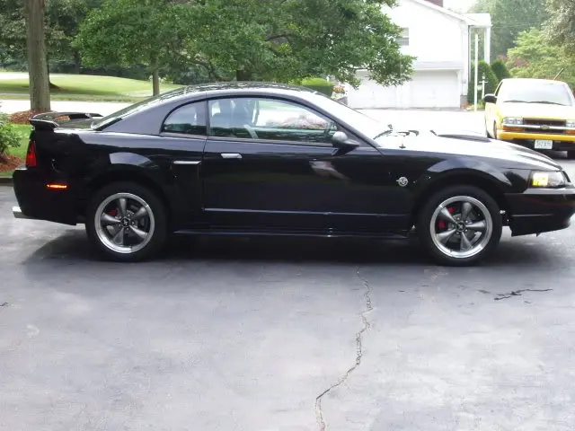

So I'm trying to think of affordable things I can do to my car in the 2 weeks between school and work. I'm graduating and then starting work at the end of Aug.
Anyone ever paint there own calipers? What kind of paint did you use? Did it fade over time?
Here's a pic of my car, thinking about red calipers.

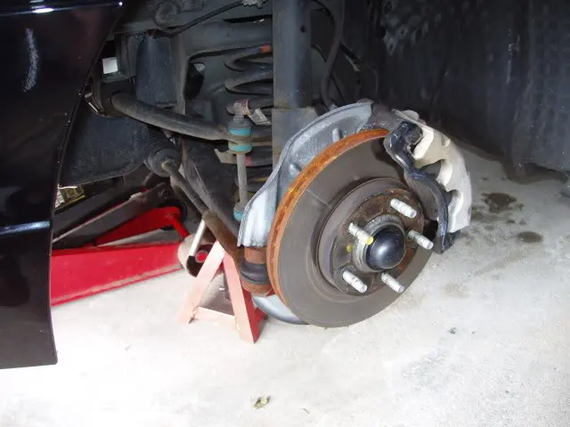

I painted mine last year. It was pretty easy once I got the rust off. I can't remember what paint I used but it's holding up really well which suprises me as I did kind of a rush job when I was changing rims.

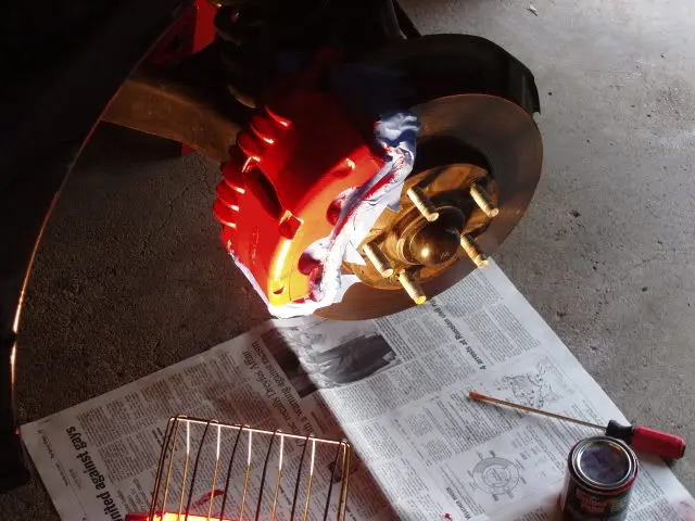

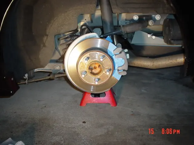

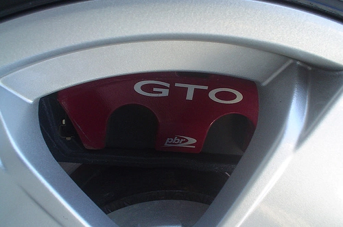

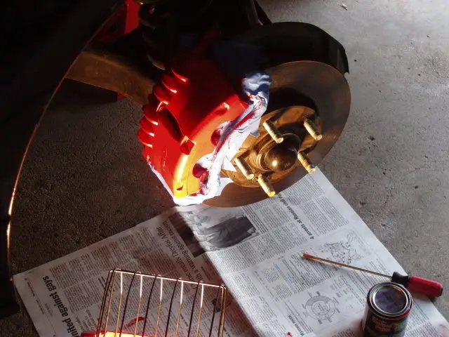

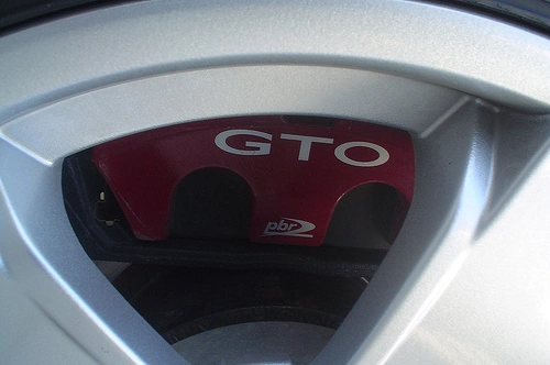

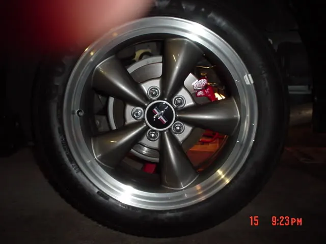

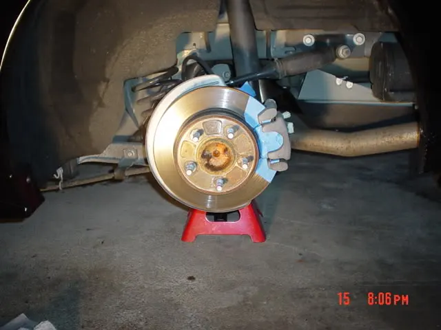

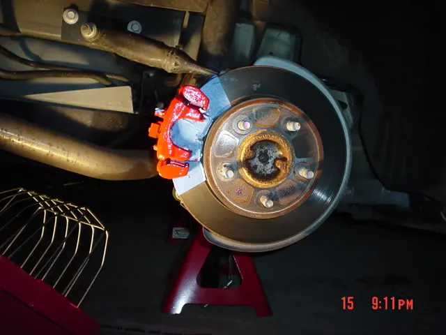

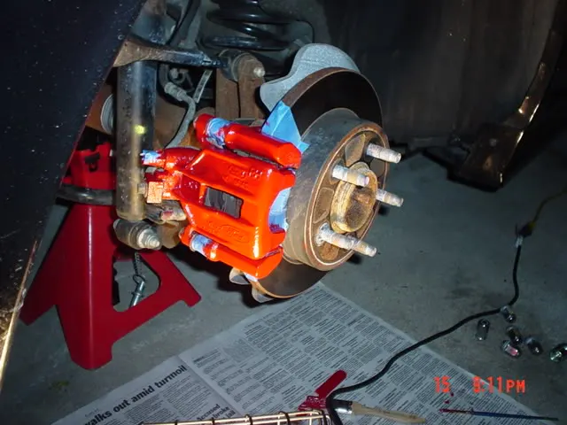

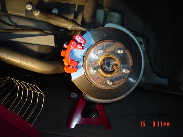

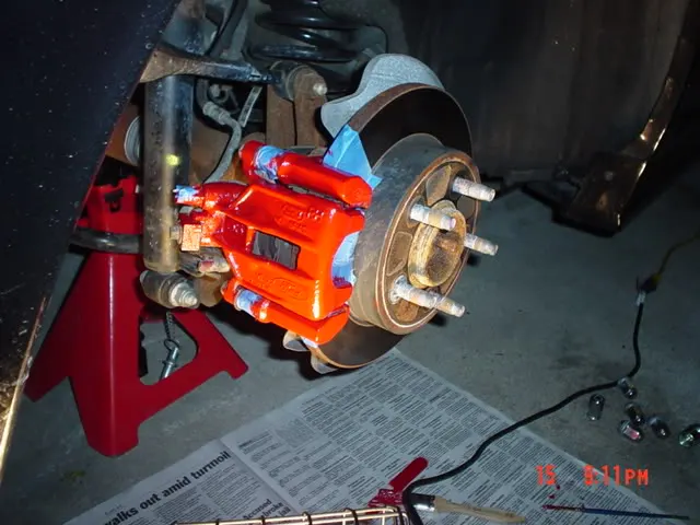

Caliper paint kit from AdvanceAutoParts
looks good :nice:
i assume that's the brush on stuff. how well is the color holding up? I see you're in Mass. too, I'm more worried about sand/salt in the winter fading the paint. I doubt you drive you car year round though
Picked up a DupliColor Caliper Paint kit from AutoZone, pretty decent kit for $15. You get a bottle of brake cleaner, masking tape, brush and paint. Only PITA was the brush was low quality so I had to keep stop painting and pull bristles out of the paint. Pretty happy how it came out, used 4 coats and have plenty of paint left.
