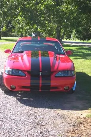

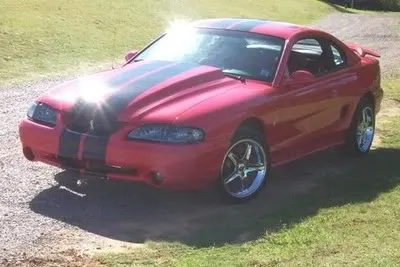

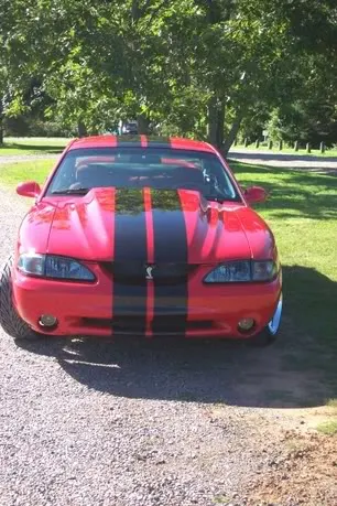

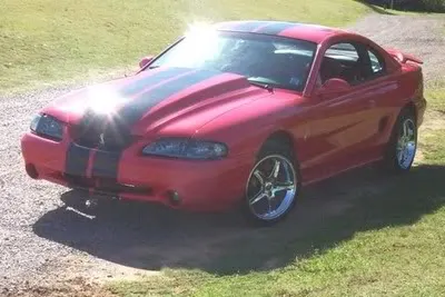

You should put your black stripes on last as you may get a variance in color as the lighter color nears the stripes. This is what the dealership who did mine said. I also specified a flex agent for the entire car as it also helps prevent rock chips and such. Here are a couple of pics of my stripes.
