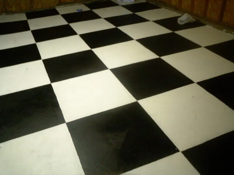

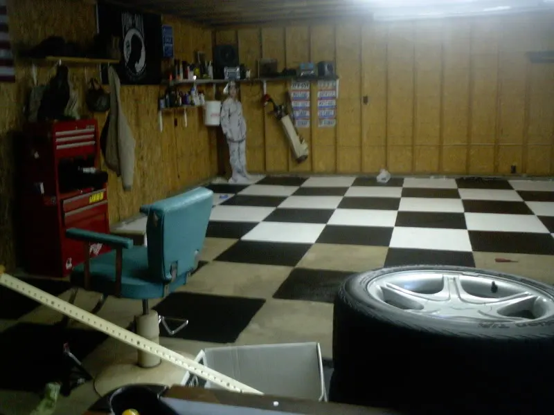

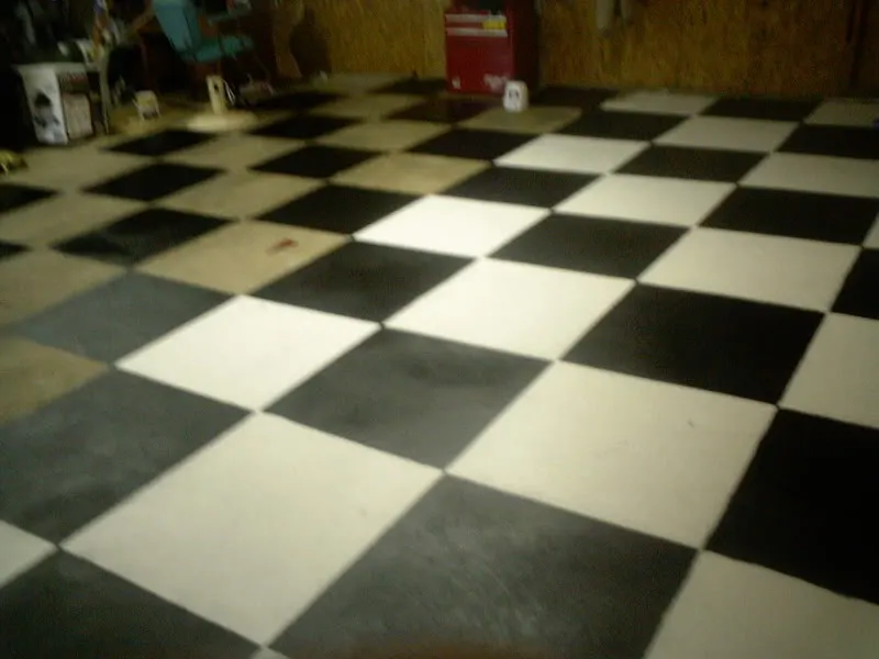

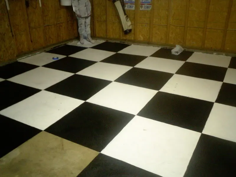

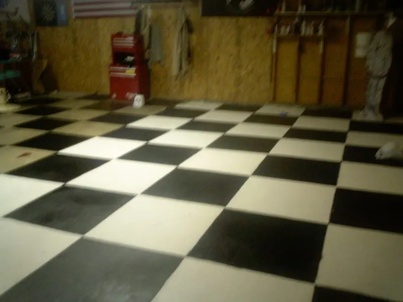

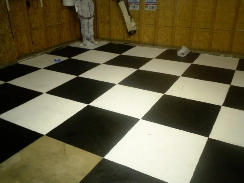

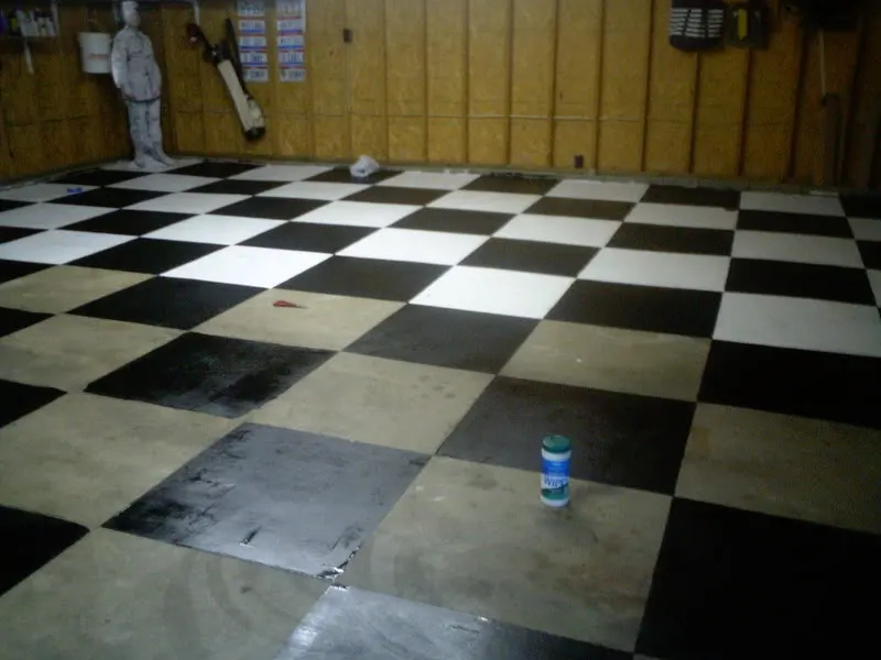

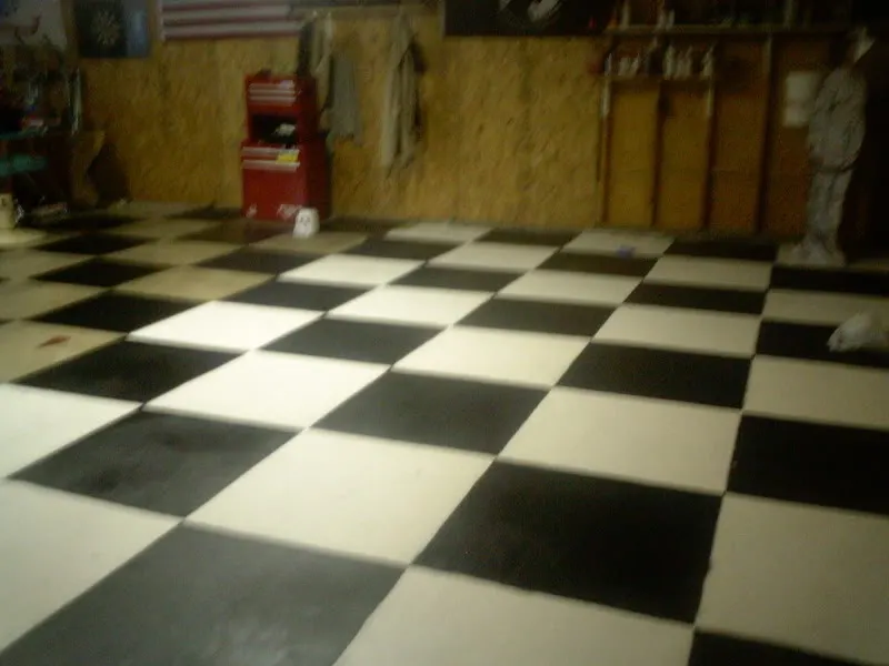

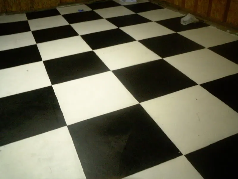

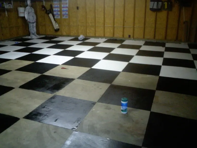

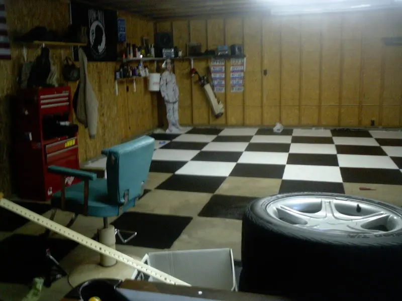

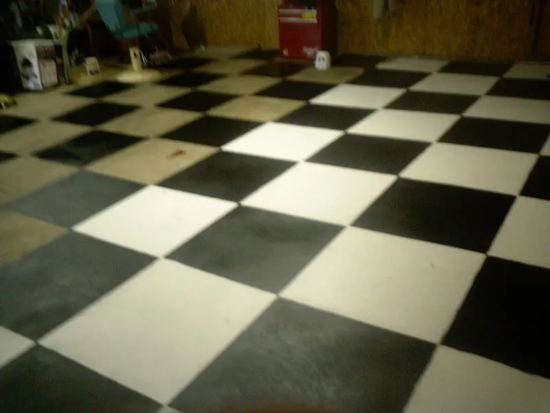

I finally decided to do something about my garage floor. And after looking at the interlocking tiles, I decided that painting the black/white checkerboard would be cheaper and give me something to do. So heres a few pics that I took a week or so ago, I should have the entire garage done in another week or so. And stay tuned because I added a little flair as of recent (more pics to follow)

First, I decided that I wanted 2.5 ft squares and then marked off along the walls. I used my laser beam level to make sure the lines were straight and that I was getting SQUARE squares. Then I used a 2x4 to trace the lines with a marker.
After I had the whole garage marked off I just went to town, starting with my black squares. I tried everything from an edger to masking tape, to painters tape, but the lines would just not be fine enough because the tape wouldnt bond properly to the concrete. So I did it the old fashioned way of edging with a steady hand.
