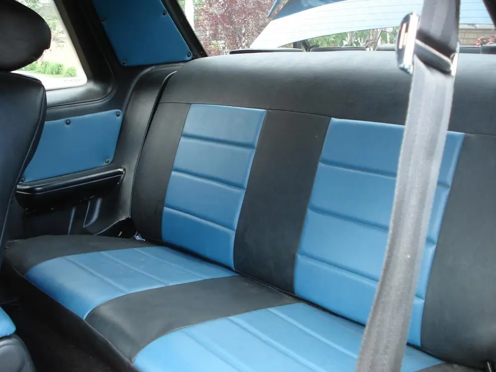

I've attatched a pic showing the belt in black material
I think the $400 price tag for new belts is too steep, especially considering Im tight on cash. But anyway................. I first tried 2 times to dye them with RIT dye, and that worked like a purpleish crap. Then I tried the fabric paint as a last resort and that was an even more of a mess.:notnice::notnice: I will advise everyone that thinks about doing this with the nylon and or polyester seat belts to NOT ATTEMPT to. I spent $20 on dye and about $22 on paint and god knows how many hours. The only way to go from one color to the other is to buy a new set, or good used set. Im mad at myself for being to cheap and impatient to just wait and order a used set. Now Ive got about 10 days of car building until Mustang week...wish me luck.
