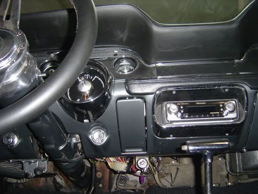

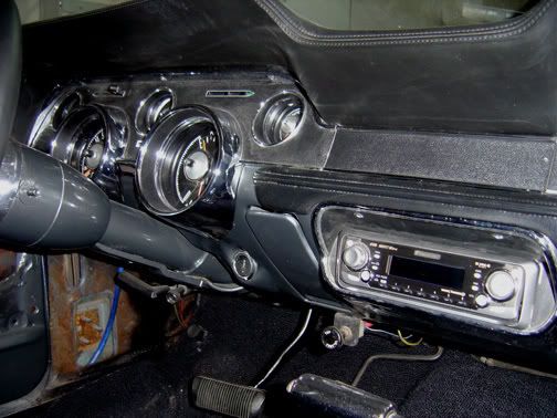

To 68Converted. Thanks for the pics. The dash looks great, very impressive. Am I right that the color is a gunmetal type gray?

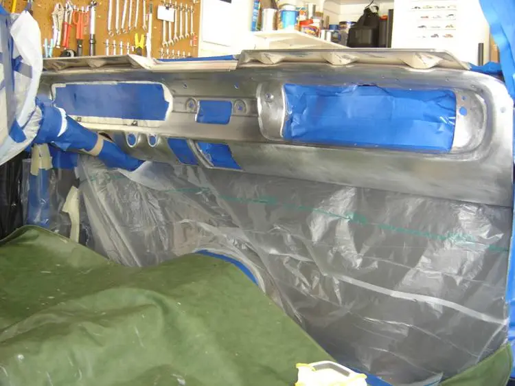

I went ahead and spent 6 hours stripping my dash to bare metal on Saturday. I'm about 90% done on the visible front of the dash, but I also intend to paint the top, even though it will be mostly covered with the dash pad.

I lied... oops... I moved over the holidays and just now pulled the box of paint out and the paint is the Dupli-Color Gunmetal Gray #T177. It looks so much better in real life. The pics just don't show the true color. I used the Dupli-Color High Temp Engine Clear as the top coat. I did the same thing you did. and just sprayed everything. I still have to coat the back/underdash with "undercoating to clean it all up but that will be down the road. I plan to do the seats in a similar color as the dash with black inserts. Should look real sporty but $$$$'s is the issue for now to keep me from doing anything now. Good luck with your project!
The factory paint was not really black, it was a very dark grey, much like the pictures 68converted posted. I used those rattle-cans that they sell from the resto-shops in whatever color they listed for 1967. I think it turned out great, can't comment on the durability though since the car is not running yet.

Making me with I'd done more research into the paint though...hope I don't end up regretting it. That paint has a very subtle metal flake to it, I was suprised when I saw that, never knew there was a metallic paint on these old cars. Heck I didn;t even know the black interiors weren't "black" either. The difference does make the deluxe door panels look even better with that contrast though.
You are right, coverage wasn't great, but I was putting on VERY thin coats so it wasn't really a problem, didn't want to risk any buildup or anything.
I used that "aircraft stripper" you can get at WalMart, it took the old paint right off, but the 40-year-old primer was much harder to get off, the wire wheel in the air-grinder worked great on the smooth stuff. Thanks for the tip on the textured portion, hopefully I wont have to use your method soon!

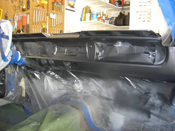

Progress report on dash painting. The dash was completely stripped of paint including the A pillars. It was then wiped down with Eastwood Metal Prep, prior to going over it with a tack cloth and then priming with Metal Etch Primer also from Eastwood. I then laid on the Duplicolor T177 Gunmetal for the dash and a black for the A pillars. This weekend I'll finish off with the clear coat. All paints were spray cans. Check out the photos, I really like the gunmetal.

I put three coats of clear on the dash on Saturday and it looks great. I pulled all the tape and paper off after the clear had dried and the finished job looks sweet.
