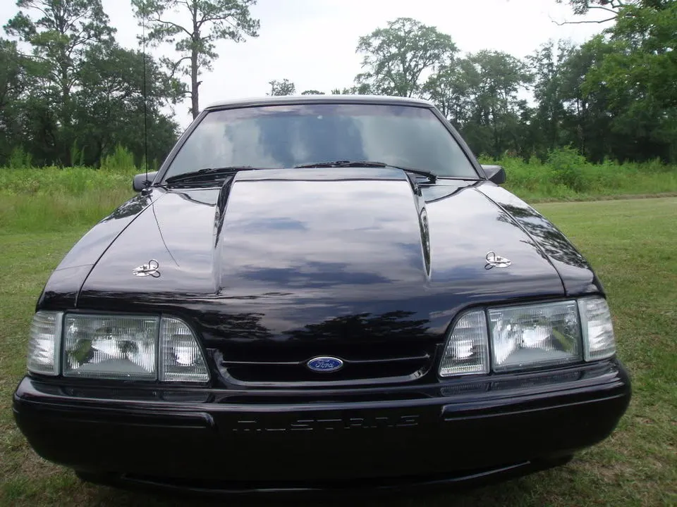

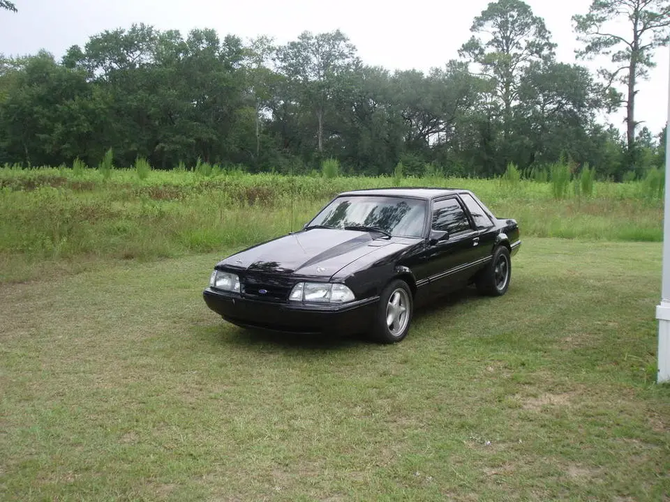

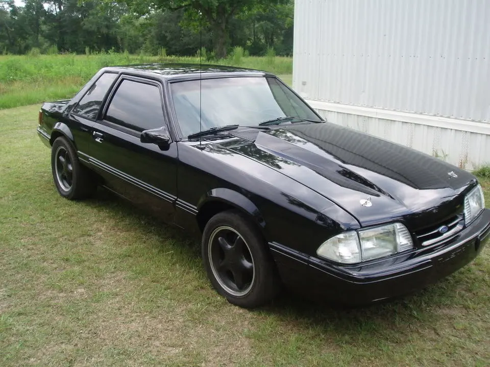

and my car.

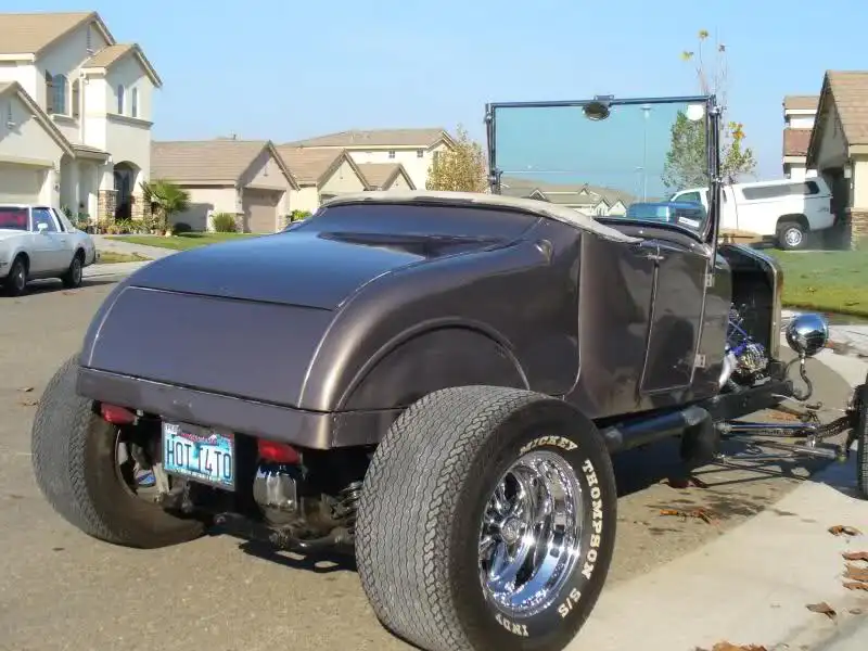

Painted in Metallic Rosewood Grey.
