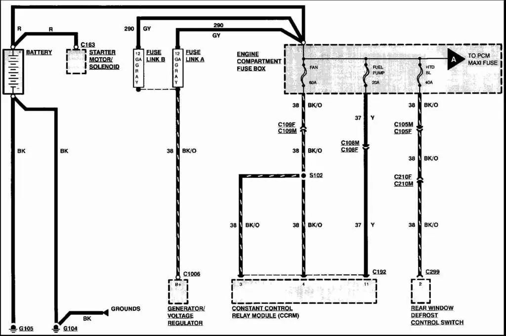

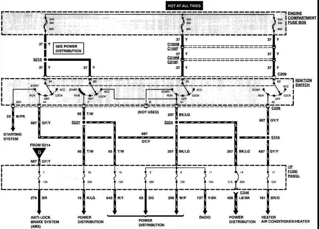

here are the wiring diagrams for fuse 18. part 1 of 2 posts
  • 96 fuse 18 Pg1.pdf
    96 fuse 18 Pg1.pdf

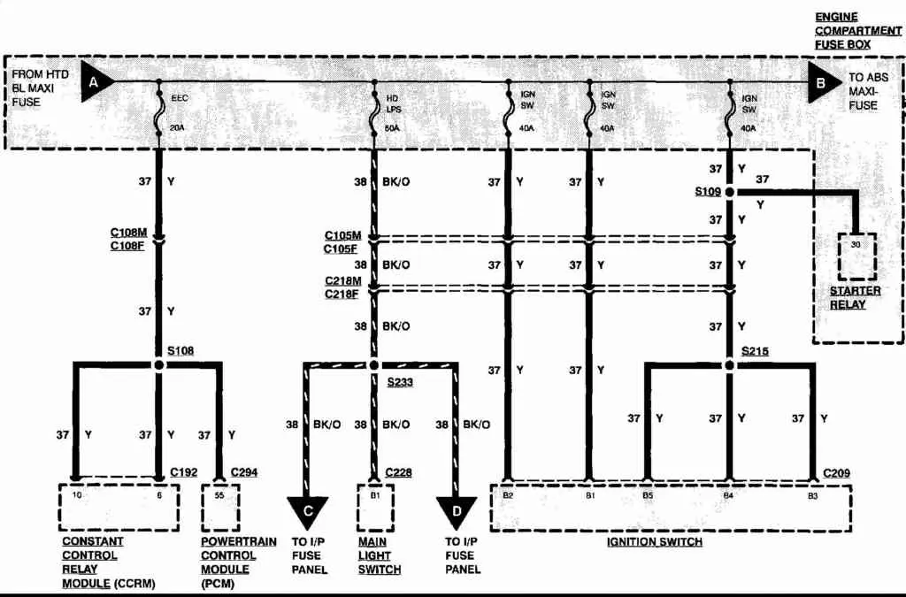

here are the wiring diagrams for fuse 18. post 2 of 2.
the first image on the first post is a PDF file. start with that one.
edit: if you look at these you'll see pg3 has a 20 amp fuse for the PCM and pg4 has one for the Fuel pump. they are the same fuse circuit #37 Yellow
