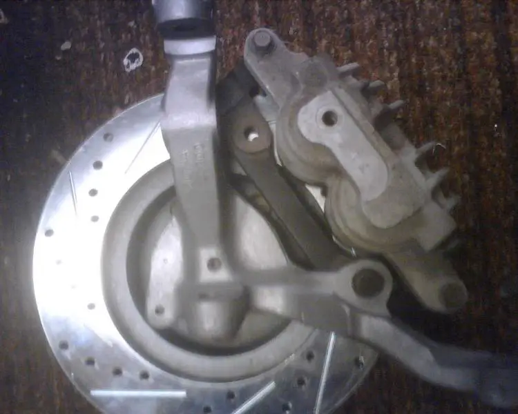

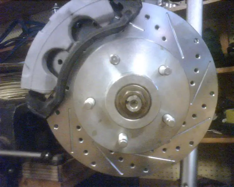

So awhile ago i ran across this stuff in the junk yard (minus the rotors) and i figured i would put it together. Luckily there were a few people before me, but it looks pretty straight forward.
The list
Granada 5 lug spindles ( '76?) / rotors
99-04 mustang (non-cobra) dual piston pbr calipers
1966 mustang v8 (w/ powersteering)
I was wondering if you guys could recomend a straightforward guide to putting granada spindles on a 66' mustang. I know its been done quite abit, i was just wondering which guide was the best.
I will be spending my time making the spacers and the adapter piece for the upper bolt on the caliper. I'd rather end the hassle there and have an easy granada swap guide at hand.
Thanks for your help guys!

Like this?

Those measurements did not work for me. Mine are in my CD site. http://www.cardomain.com/ride/2435094/2
