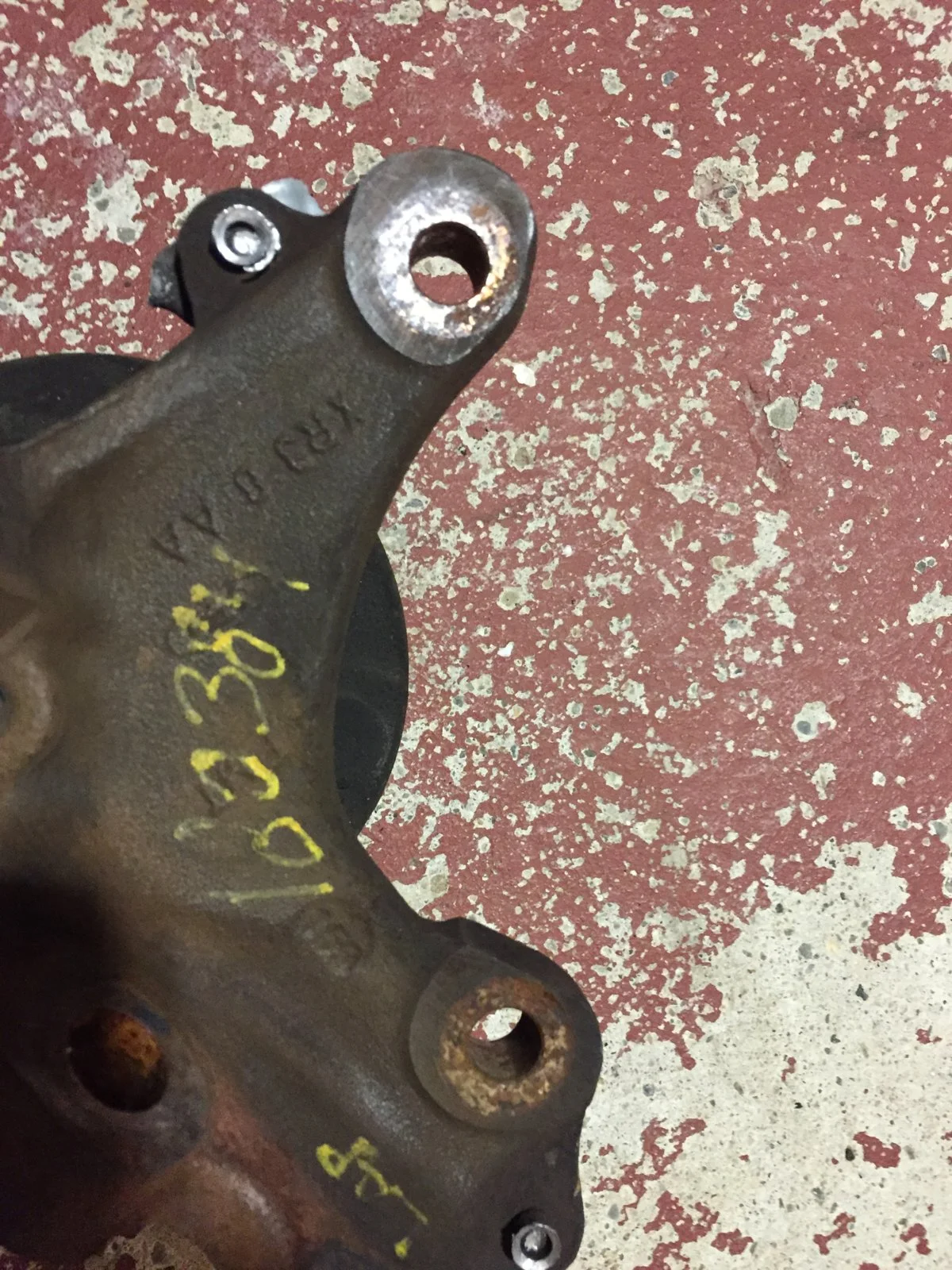

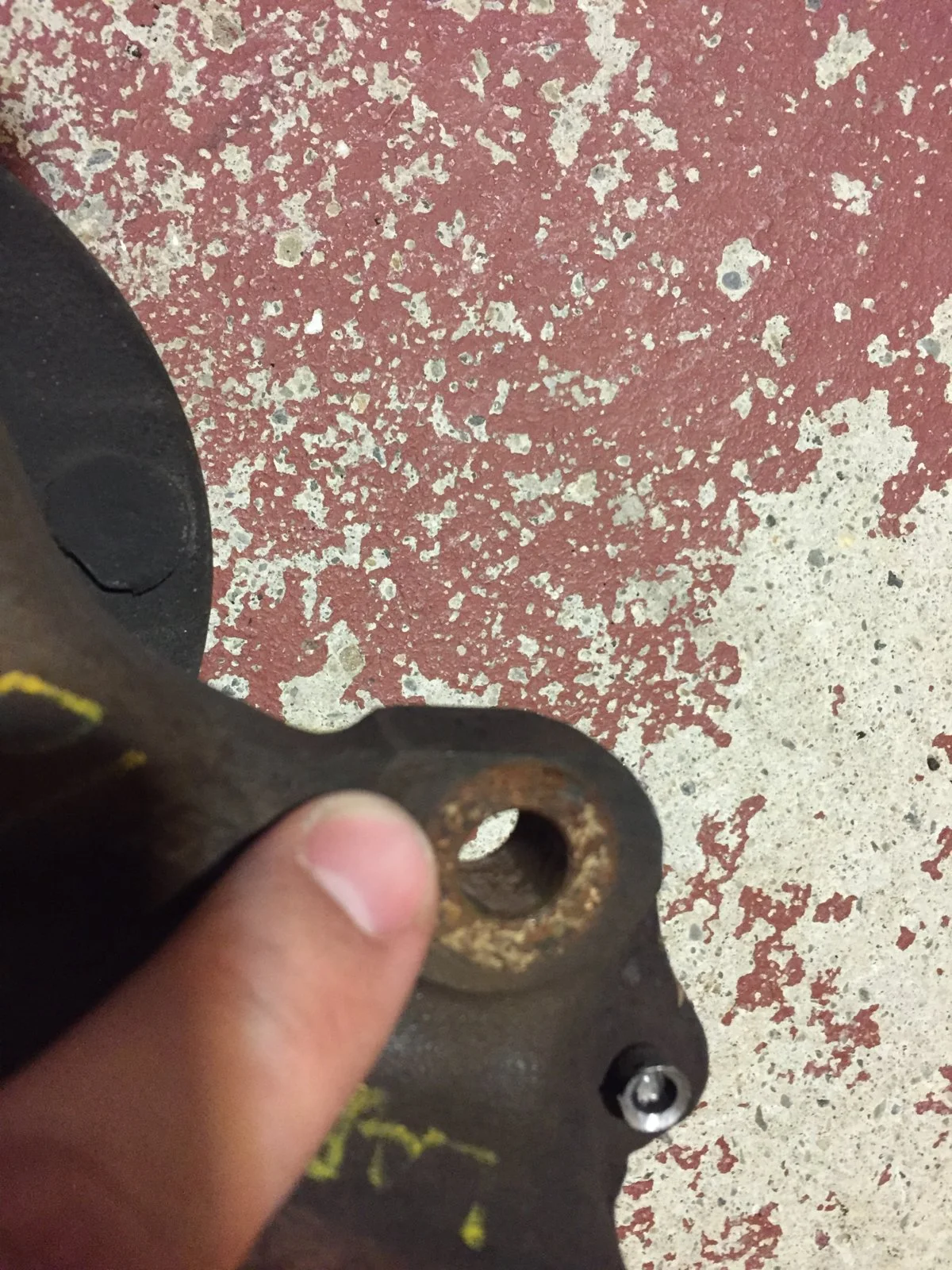

That's exactly what I needed to know. I went to Home Depot and got a $50 Milwaukee 7 amp 4.5" grinder and a couple of 60 grit flap discs that had a backing plate already (they were out of 40). That was actually a lot of fun using the grinder.
I had a tough time trying to put the calipers over the new pads until I realized the junkyard calipers had the pads in wrong. There is an inner and outer pad. They have the backing rivets in different places so they don't interfere with slipping the caliper on. Once I figured that out it made it a bit easier. The only thing I had left to do was to bleed the brakes and the bleeder screws are both seized and stripped. Normally, this is the first thing I check but I totally forgot about it. I spent about 5 hours working on the brakes only to get stopped by something so small.
I think I am going to get a torch tomorrow and heat those bleeders up and try to break them free.
