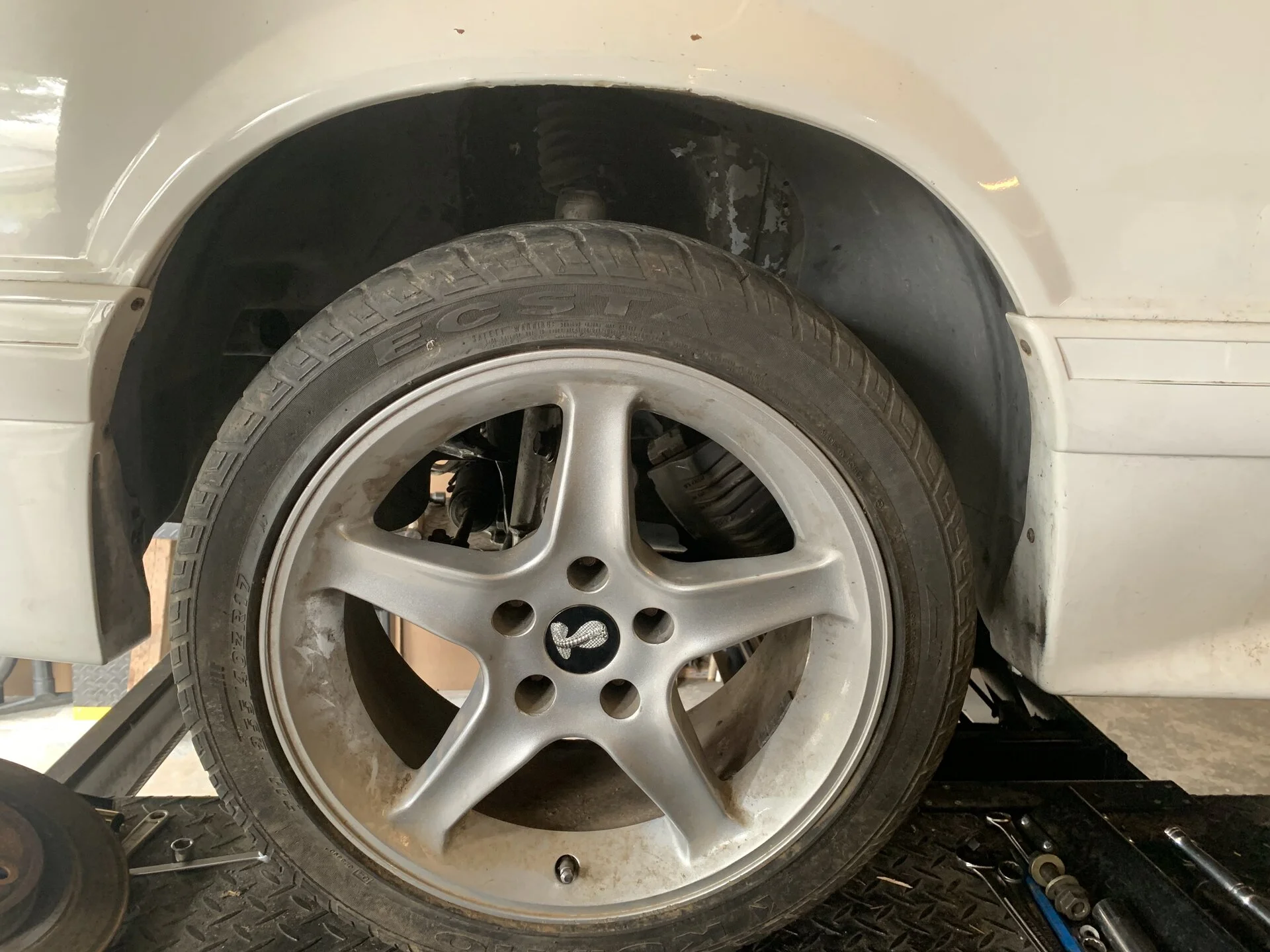

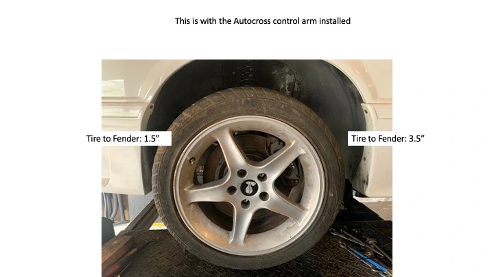

I put things together, and all seemed to go fairly well, until the wheels went on. They are located approximately 1" too far forward, causing a clearance issue between the tire and the wheel well.
With stock k-member and 95 control arms, this was not an issue, as the car ran for several years with that setup.

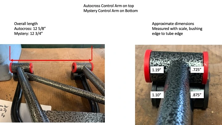

So, I reached out to Team-Z. They were helpful, looked at a bunch of pics, but could not identify my control arms. The ones I have look different than theirs. Maybe I don't have their control arms, so I bought a set of their Autocross control arms.
Installed the new Autocross control arms yesterday, and same thing. Wheel is offset forward by an inch.
So, I have an autocross control arm, and a mystery control arm... more on this later...

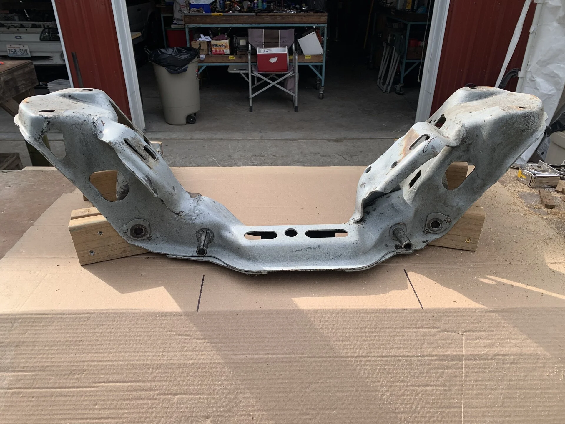

I took a bunch of pics of the K-member, and what I have looks identical to the pics I've found on the interwebs, of the Team-Z Kmember...
But best I can figure is that the k-member is moving my control arms/spindle forward an inch, but I don't see anywhere on the K-member that suggests this?

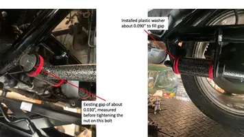

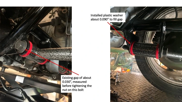

There seems to be a 1/8" difference in the rear mounting point of the autocross control arm compared to the mystery control arm.
Attaching pics to illustrate this issue...

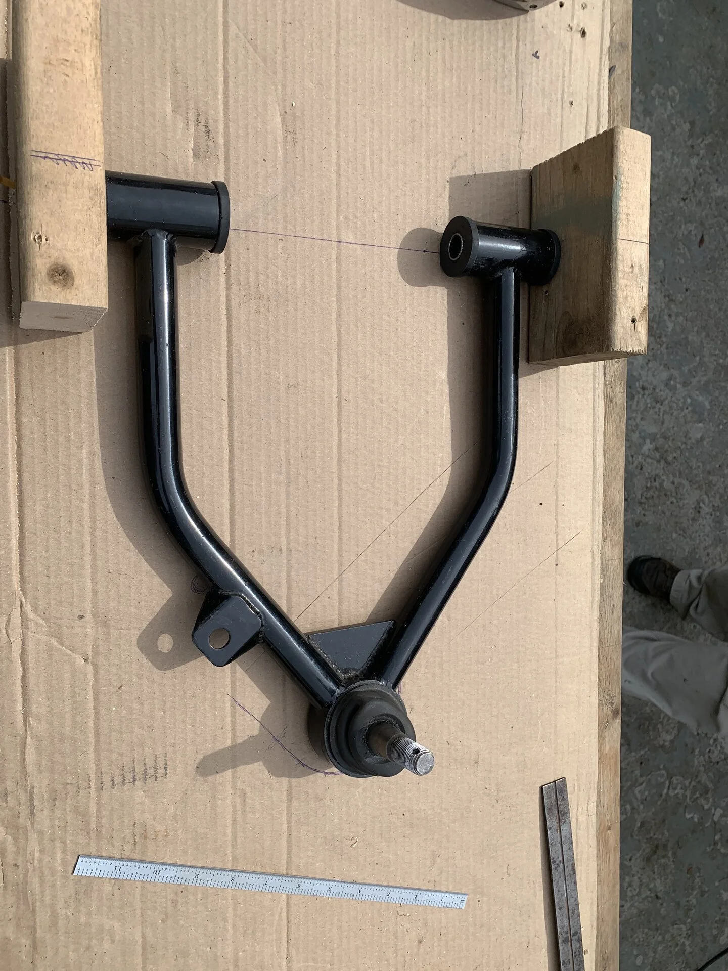

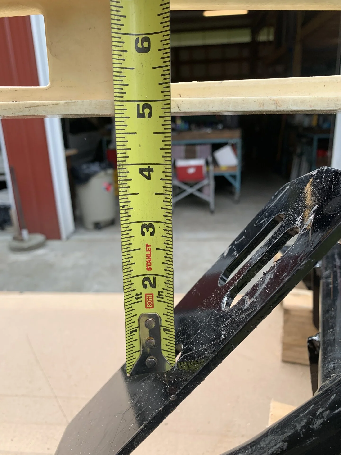

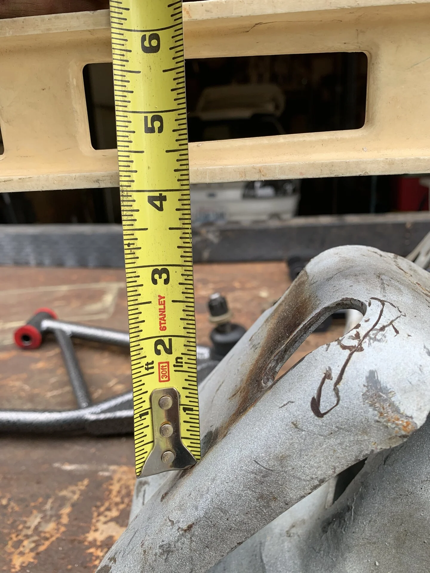

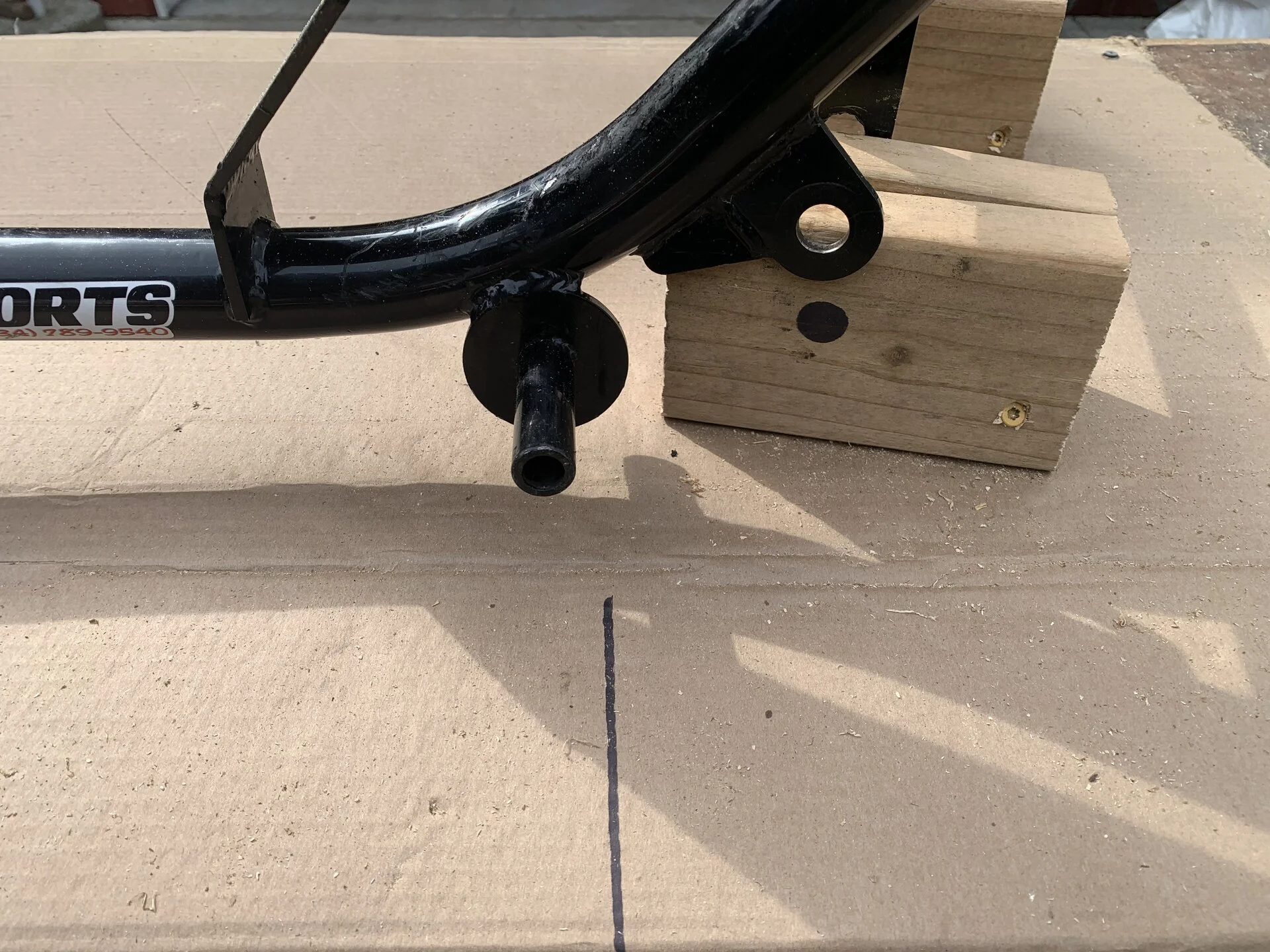

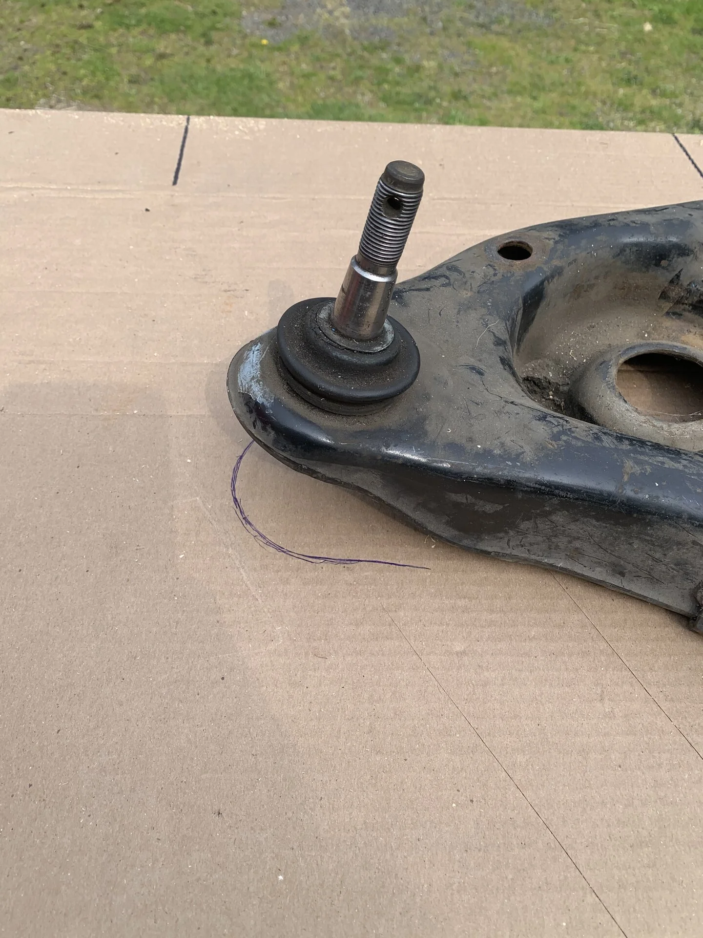

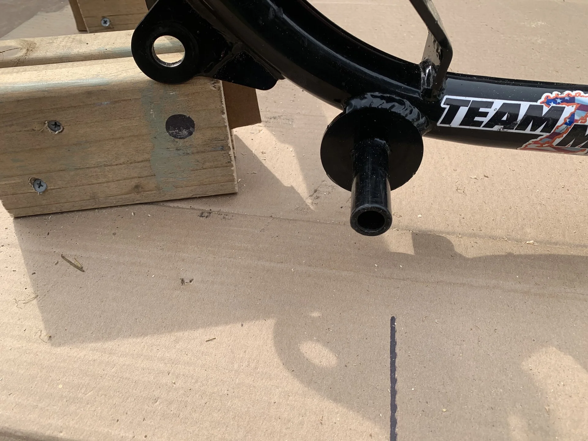

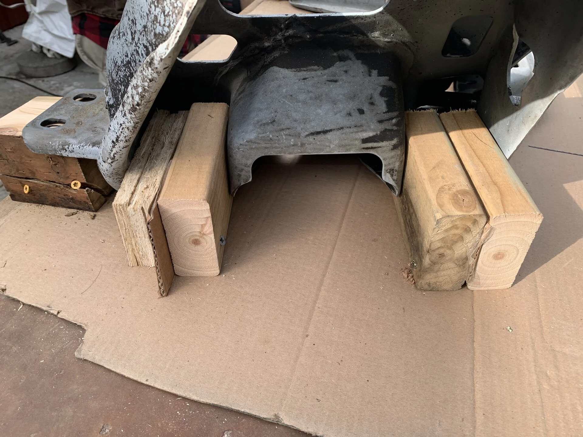

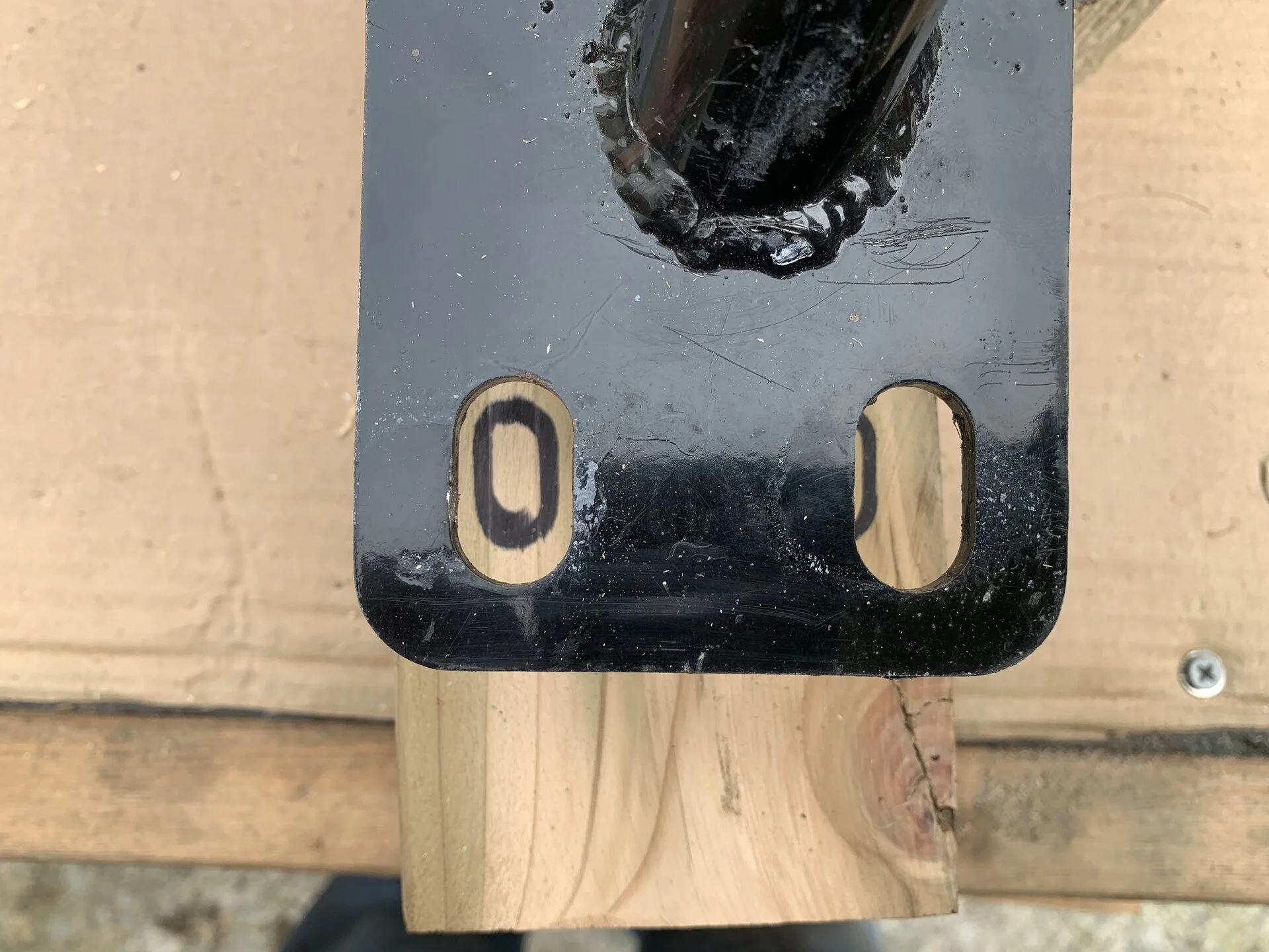

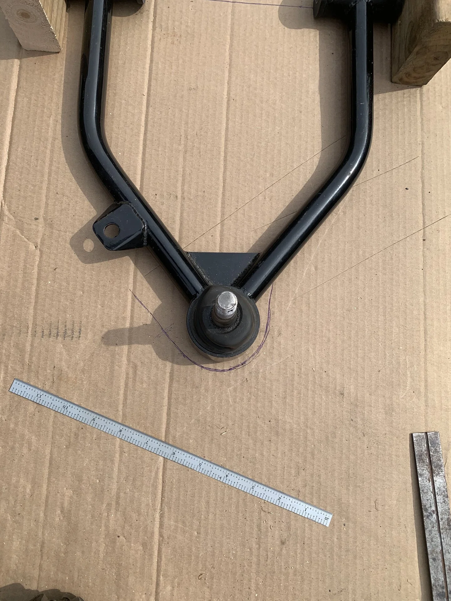

I pulled the TeamZ kmember, put in the stock kmember, 95 ctrl arms, and wheels are back to proper position…

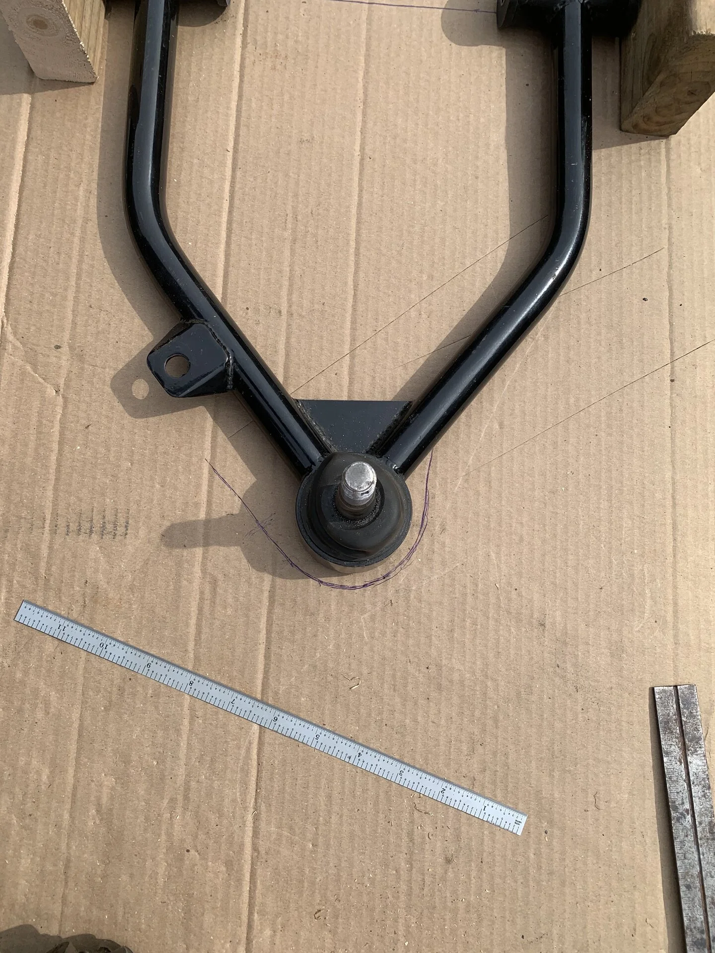

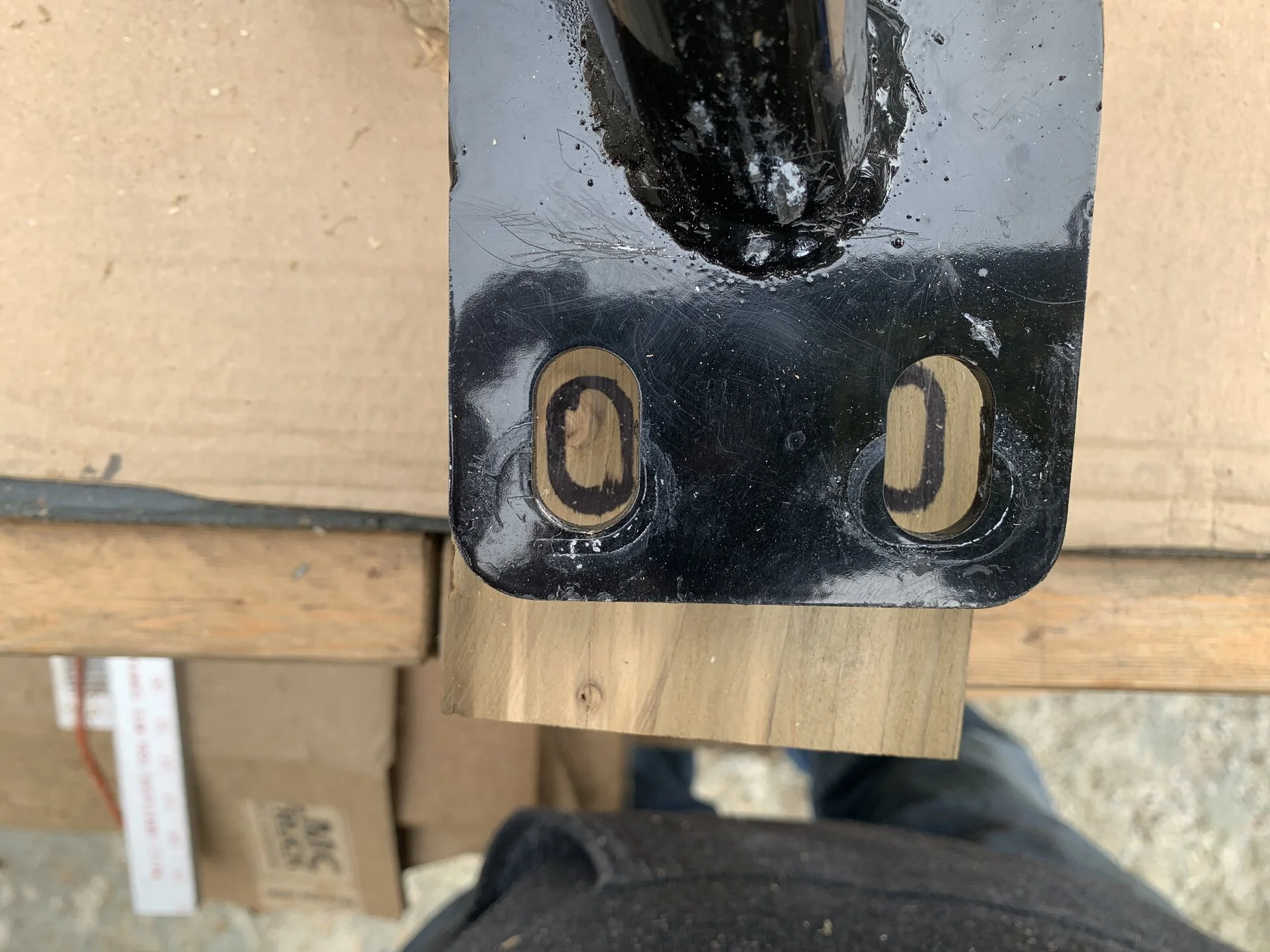

I used the factory kmember to locate some wood blocks, kind of as a jig. Nothing precise.
Then dropped the TeamZ kmember into the jig.
As can be seen in the pics, there are some differences, but nothing that looks like the 1.0” that I’m looking for.
I was able to confirm the TeamZ kmember drops the engine 3/4”.
I did similar with the control arms, although that is a little sketchier setup…. But still, I don’t see a difference of an inch anywhere.
