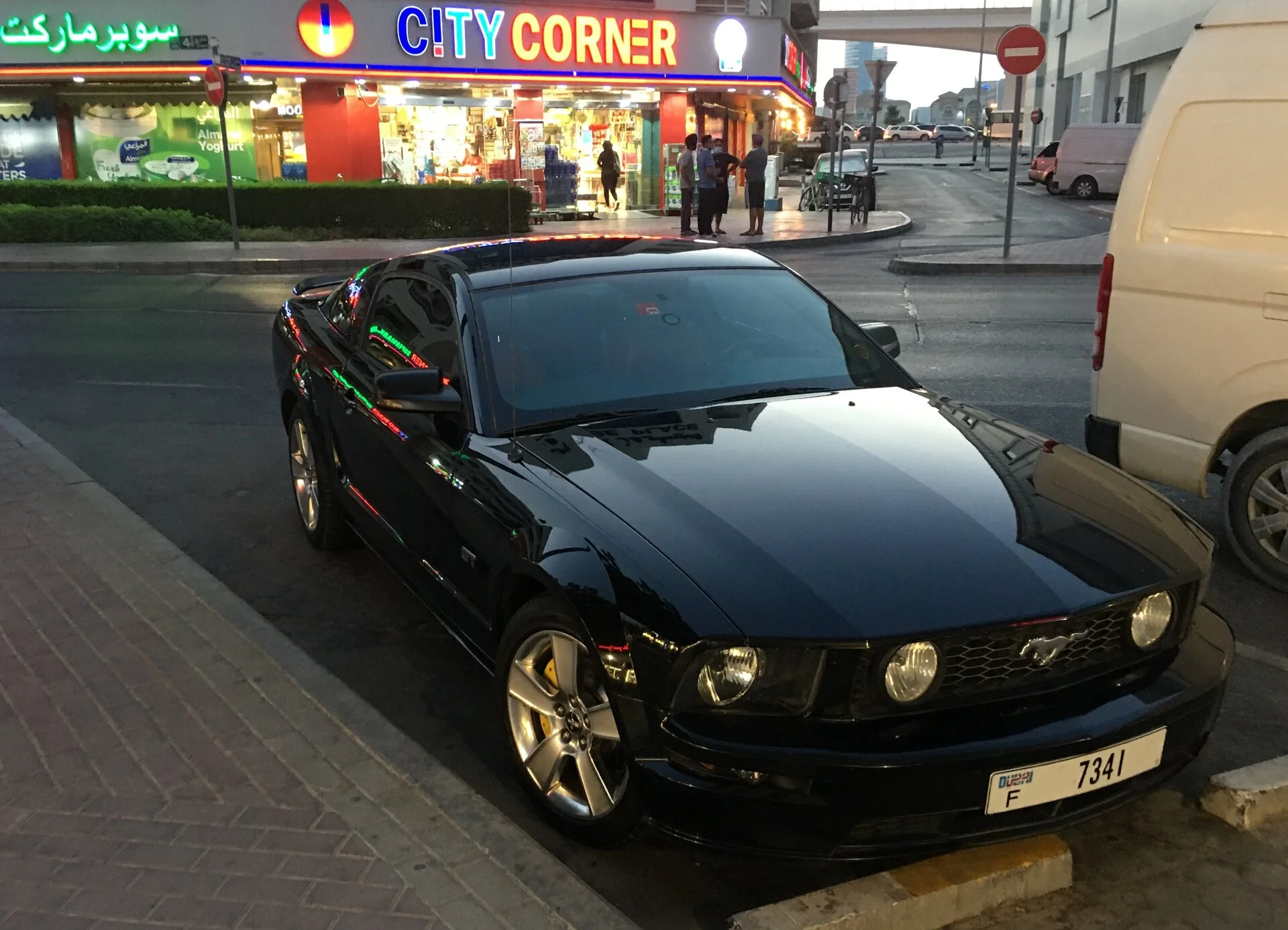

Hi all
I am new here on this Forum but have had my GT for 15 years.
My name is Helgi and I am from Iceland but live in Dubai.
I have a Mustang GT 2006 4.6l 3v Automatic
I have done some upgrades, mainly suspension and engine.
  • Cold Air Intake
  • Bama X-Rev tuner
  • Steeda Underdrive Pulleys
  • Ford Racing Camshafts
  • One Piece Aluminum Driveshaft
  • Rear Diff 3.73:1
  • BBK Long Tube Headers with Cat X-Pipes and Borla Axlebacks
The car is now at 100K miles and has developed some issues I have trouble with … I am starting to lean towards bad PCM but would love to get opinions from fellow members
