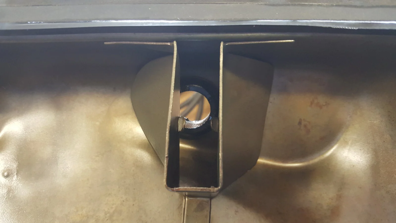

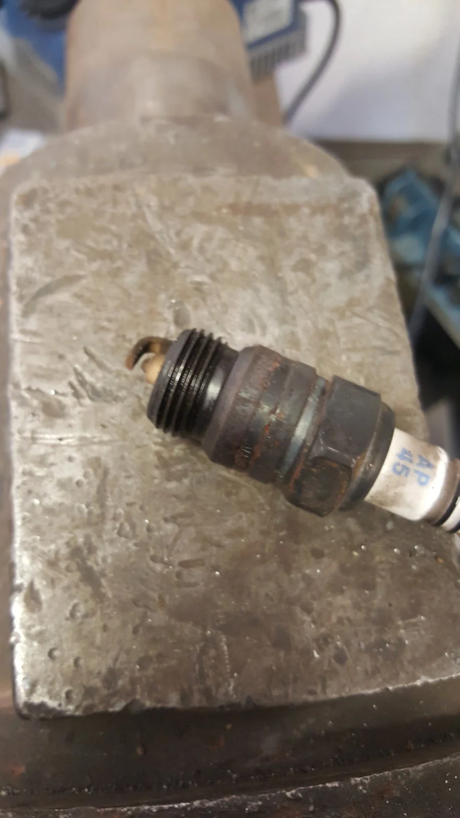

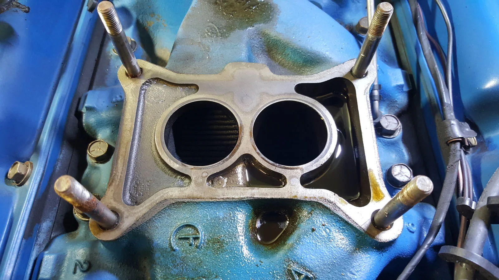

Pulled the carb from the 289 because of an idle issue. Lots of oil under the spacer and leaking from pic hose. Compression checks great on about 40k miles. Not much of a baffle in the stock valve cover? Pcv valve seems to rattle fine. Plugs look great. Solutions?
