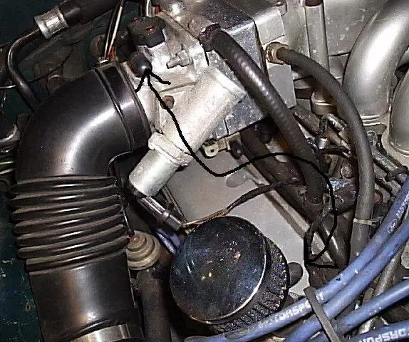

I just had the 5.0 I picked up a week ago go through emissions testing today. The sniffer was fine but the car failed because of the PCV system (visual). It has a breather so I got an oil filler cap from Advance that I can install, but it looks like the PCV hose has been disconnected/removed and some things have been capped off.
I think I have an idea of where the hose needs to go but if someone could circle on the pictures what I need, that would be great:nice:
This is the path of the tube as I remember it, with the arrows showing where it goes. Mine has not been on since I went to emissions either. I bypassed it after reading that it may help with the oil consumption common when using the GT40 intake. It looks like you have the same intake so possibly the last owner did the same. Believe it or not, for those interested, bypassing the tube actually did help.

What a waste of time. I hate these NOVA emissions. That tube goes right where he drew the arrows. Altho it will have 0 effect on your emissions, those inspection guys just wasted your time when they could have let it go and told you to fix it.

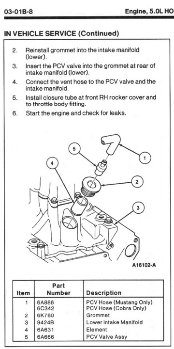

The PCV is located in the back of the intake. If your PCV is bypassed, I have no idea how he could have noticed, as it's hard to see. The other end of the hose runs into the bottom of the upper intake, and again, it's hard to see.
Thanks for the info guys, yes it is a GT40 intake. The breather and caps will go back on after the test.... I guess I'll just go get some vacuum line and cut it to fit.

Also, you need to verify that the PCV screen is in place. This often forgotten part is located underneath the PCV in the back of the intake, and helps remove oil mist from the crankcase gasses.
