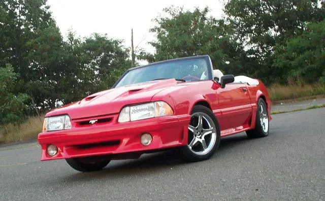

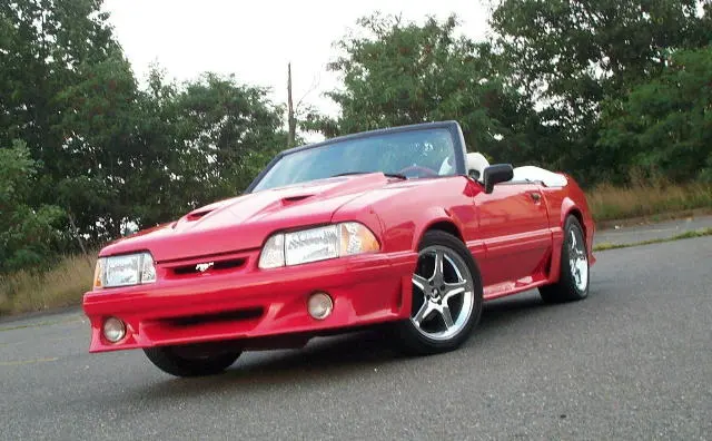

I run 17x8 all around, 245/45/17 falken azeni rt-615's (different rubber then pictured)
The fronts just barely fit in without any rub, I don't know how you guys run a 17x9 upfront without major rubbing

thats my concern that 17 x 9 would rub in the front pretty bad.
25thmustang - did it rub pretty bad?
mansonozz - that looks real good I think I will just go 17 x 8 front and 17 x 9 rear:D

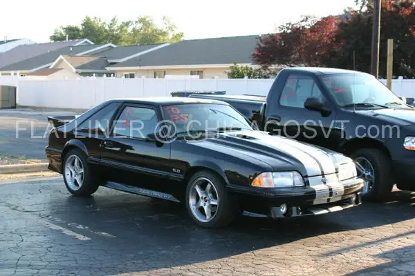

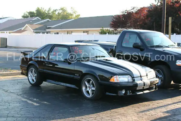

cardudeusa said:
I have 17X9's all around. Right now I'm running BFG KDW 255 45 17. They rub a little bit at full lock but nothing serious. Its also lowered using the Ford racing springs, just not in this picture.
dman that looks real good doesnt even look like it needs to be lower. Im still undecided really if I should go 17 x 9 in the front or not :p
