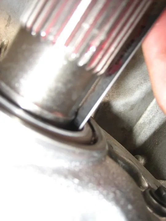

, I stuck a 6 inch steal ruler into the trans and could only get 2 inches of the ruler in (as shown in pic, the ruler won't travel inside the trans any further). Is this normal for aftermaket performace converter's ? I pulled the TC on and off and still get the same results.

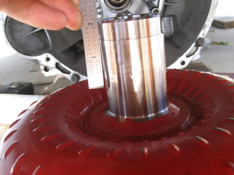

the second picture has the tranmission pump seal and the shaft that goes into the torque converter. I put a 6" ruller (pic) as far as I could into the transmission, and I wouldn't go farther than the 2" depth.
my torque converter shaft is about 3". gonna try to install in again tomorrow.

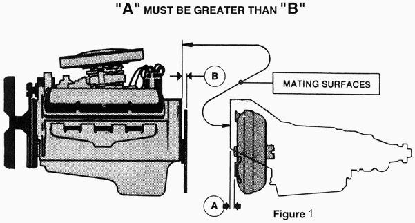

out of this guide, my lenght For B = .805", and my length for A = .950"
PATC's guide says
Most Ford should measure 1" from Bell Housing to Pads with a +/- .050"
My main concern was that: my torque converter would not seated all the way into the pump seal, I can fit my hand all the way into where the pump seal and torque converter would mate, and still get about an inch as you can tell from pic of the torque converter, the lenght of where the bottom of the ruller is, to the begining of the torque converter shaft.

The measurement I got from the mounting face pads (pads on torque converter that are bolted to the flexplate) to the bellhoising is .950 thousanths, really close to 1 inch. Which I should be ok by the chart.
The lenght between the torque converter flange to the mounting pads is .930 thousanths of an inch that's my measurement for A = .930 and not .950 like in my previouse post. measurement of B, I still get B = .805 thousanths of and inch. subtracting one from the other A - B (.930 - .805) gives me ===.125 (1/8) of clearance. this seems to be right, although my converter has only gone in 2 inches of it's 3 inch shaft.
