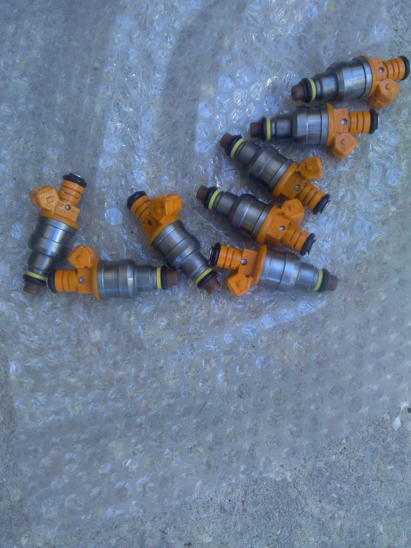

Now I'm thinking that these four hole injectors probably came off an Explorer or did Mustangs get them also...Says they are for 90 Mustang. My plugs should fit right?? Also the two small vac lines going into the intake. Does it matter which goes where.

Funny how we are all older. Glad I have this car as a hobby to do. I live with women, so I need to get away sometimes. Taking off my intake again tomorrow so I will be ready for these four hole injectors. I have had questions about my injectors for quite a while. Hoping When I put these in my car will go fast, and smooth. As usual , you plan on a new part doing something. Get it in, and nothing. We will see. They come Tuesday.

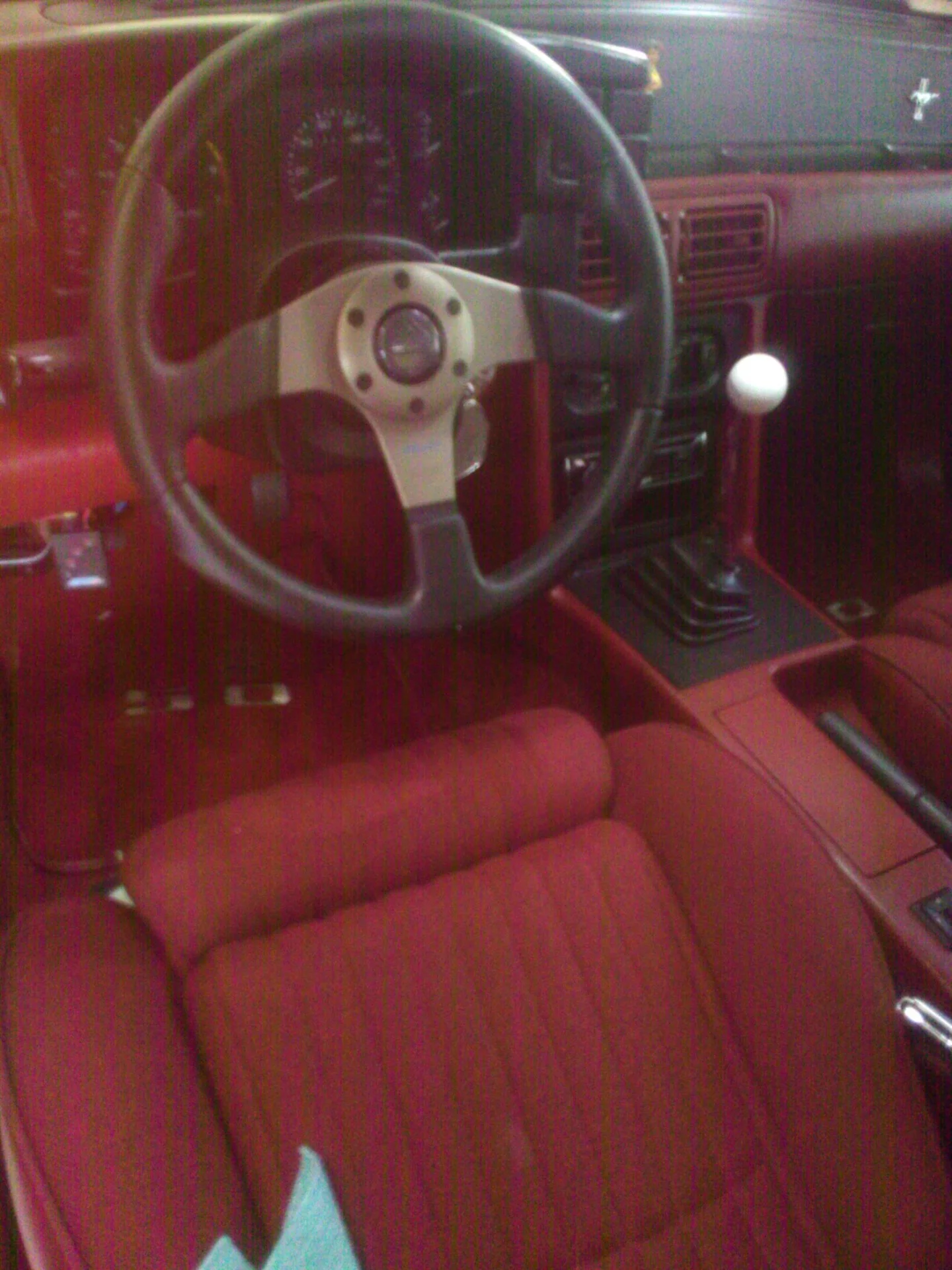

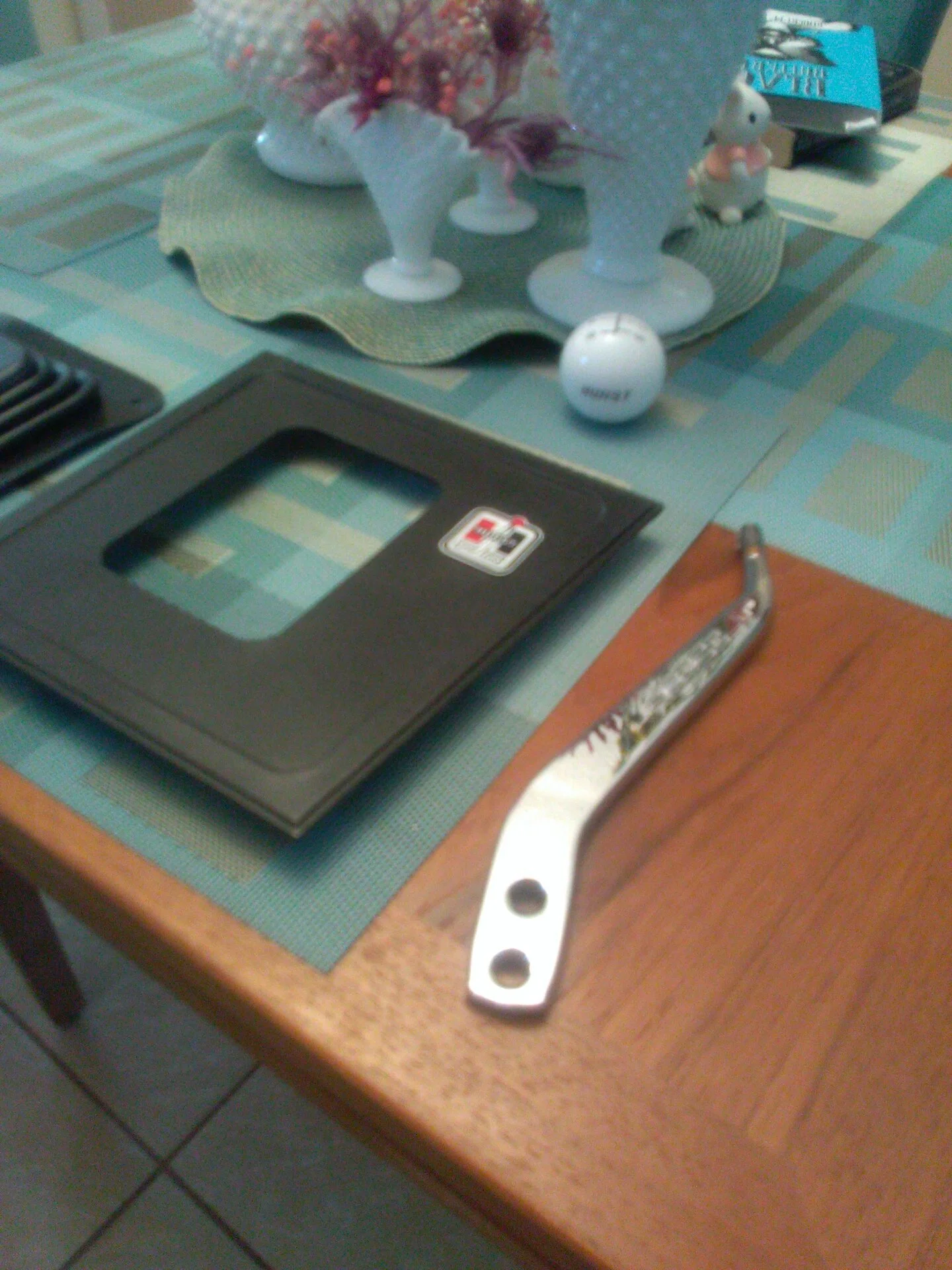

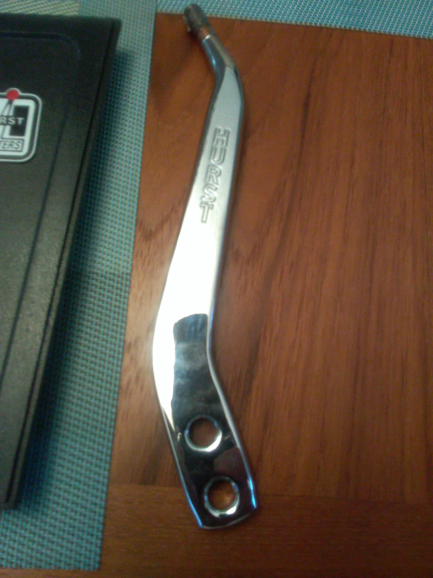

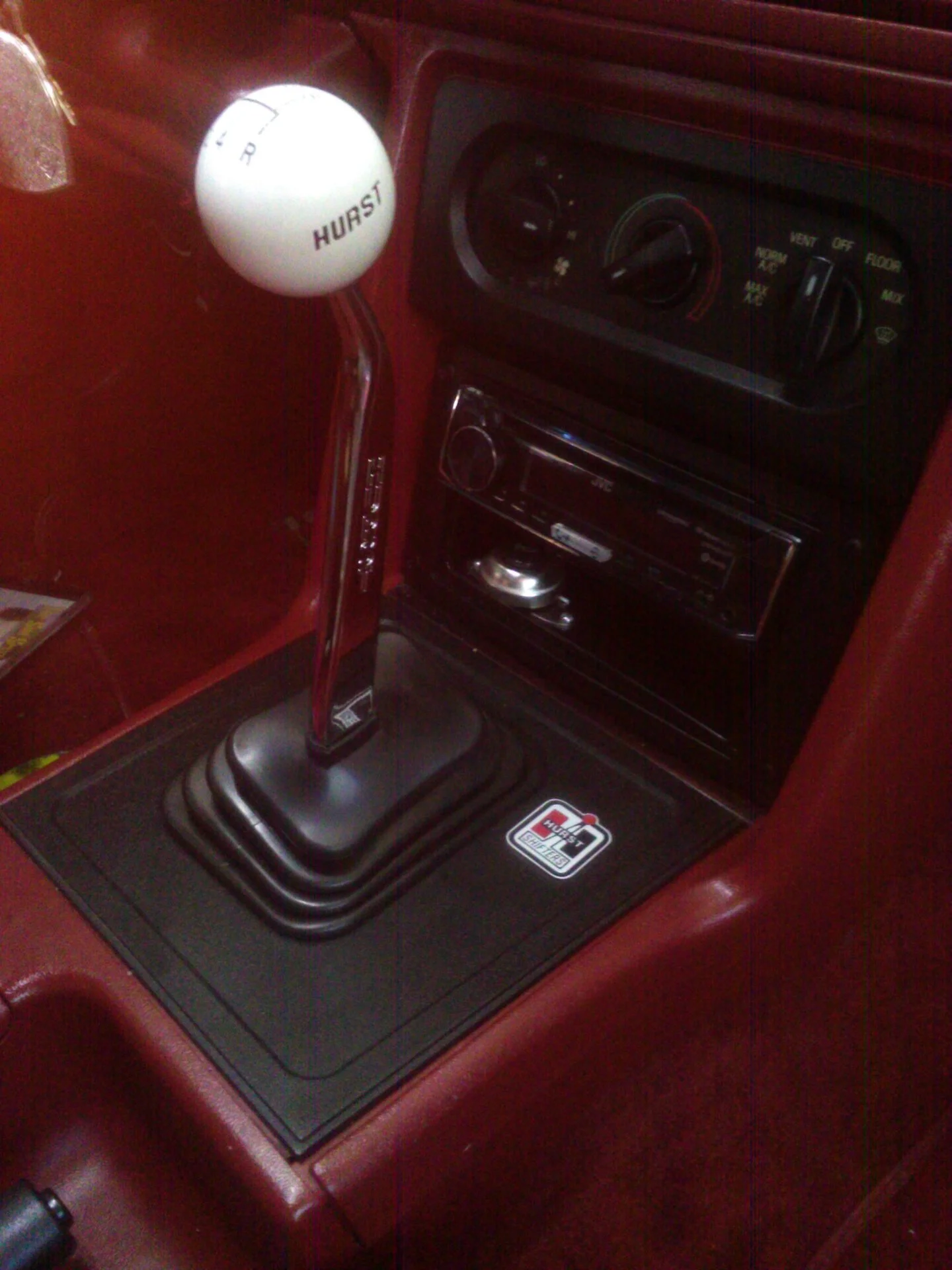

I really like this look with my **** red. Coming along nice on my interior almost like new. Shifter handle had to be drilled out to fit my old Econo Shifter from LMR

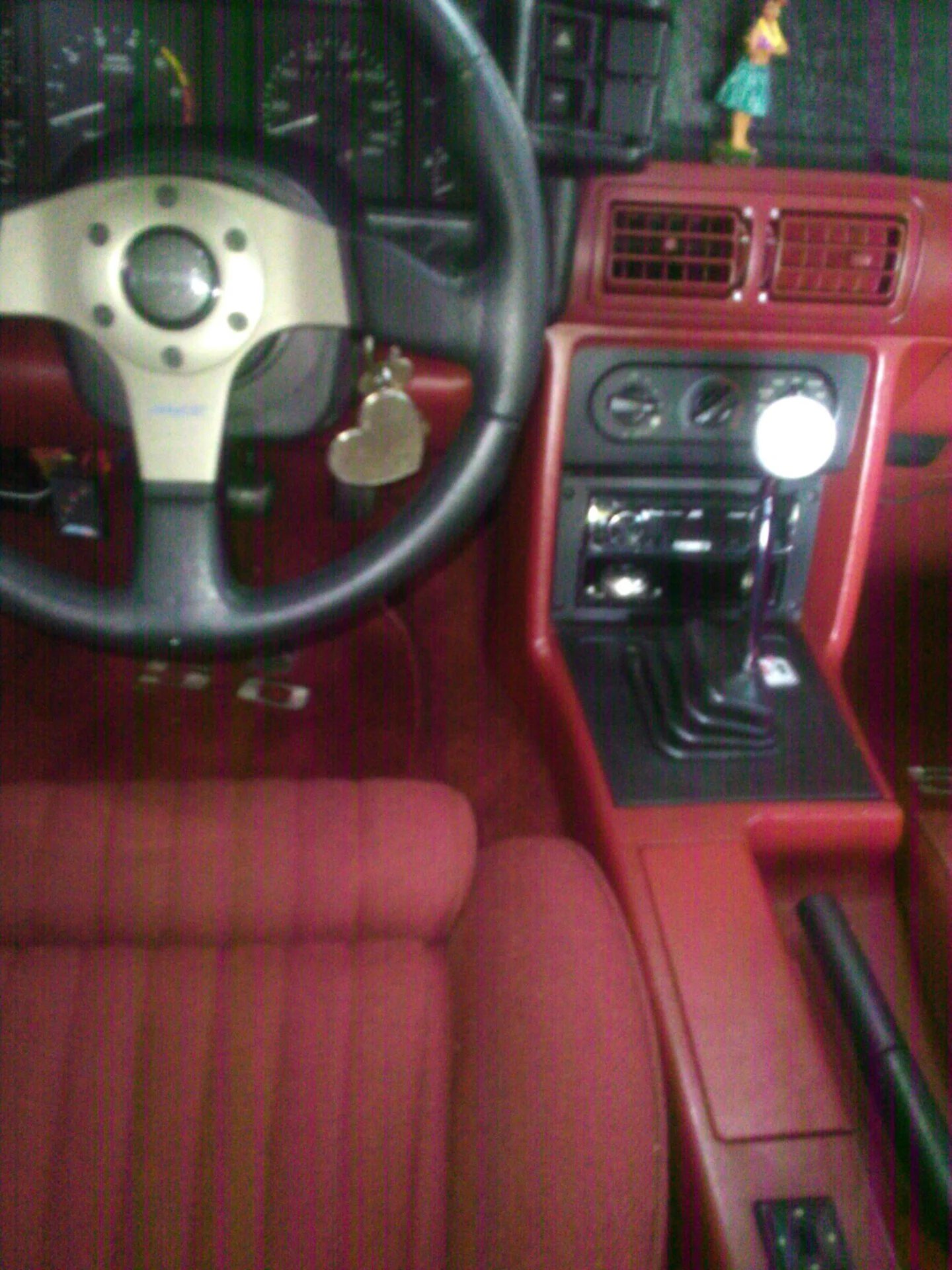

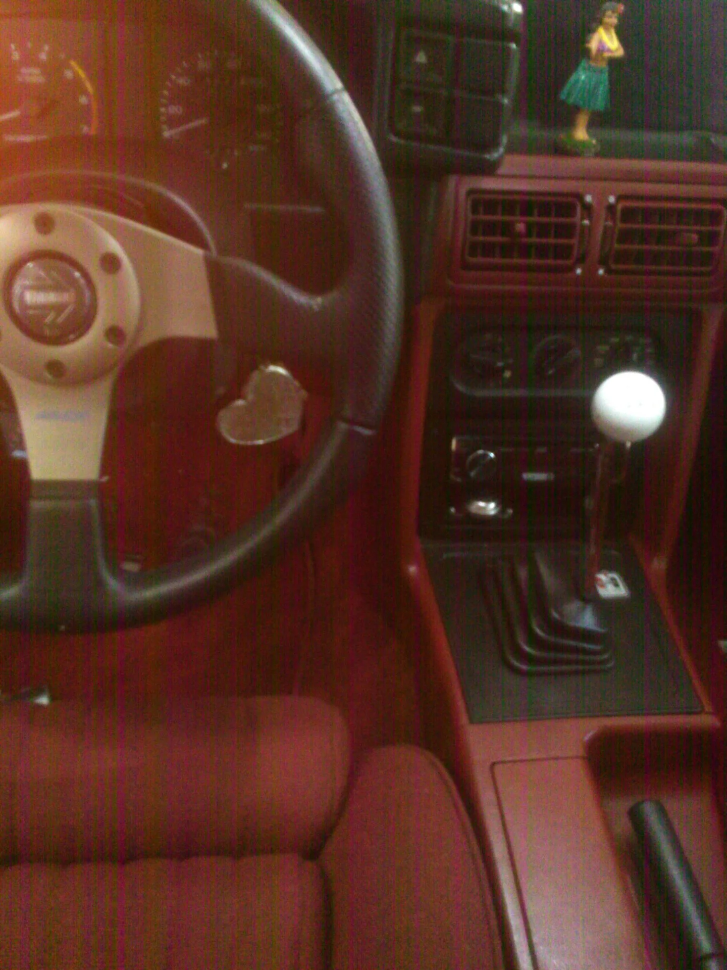

It’s probably a preference thing but I have always seen and used that handle mounted the other way and it was very comfortable and easy to row gears with .
Reactions: Potomus Pete
I am going to check into that. I did notice that it's way up front. Feels real good, but not what I'm used to. Right now getting ready to watch Talladega. Not into racing anymore, but this speedway I love.
I see what you guys say, but the etched side goes only one way. I could/will try to go the other way. I have had trouble in the past with the bolts coming loose
I know what you mean but it is backward the way you have it facing. Just crank the bolts tight ive never had an issue and i shift :poo: pretty hard in a stick to put it midly.

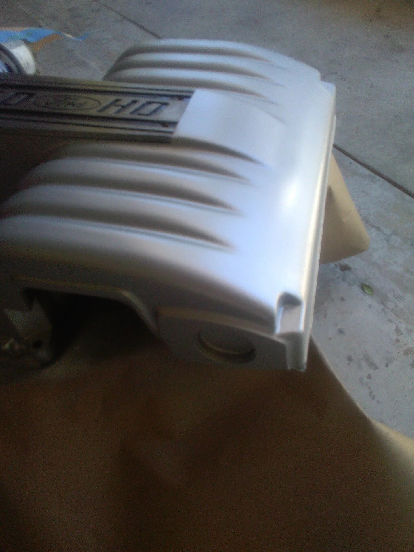

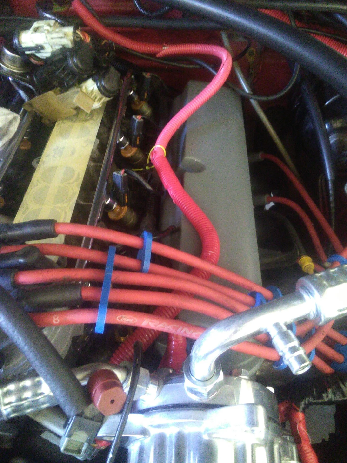

Just put my cat back together, and ready to start it up. I just have one problem. I cant find a vacuum line to my intake. I have the one hooked up from the area of the ac box area to the intake...NEED HELP WITH THE OTHER VACUUM LINE WHERE IS IT. WHERE DOES THE OTHER ONE COME FROM.the small line into the intake ..Cant start the car till I find it...These four hole injectors are really nice look like brand new cant wait to go. Help me with this problem

Just make sure you pressurize the fuel system to check for any leaky injectors BEFORE bolting the upper in place.Been there done that with rebuilt injectors that were said to have been tested before shipping,three of the eight leaked out of the small hole on the side of the injector body.
Leaks at the rear are hard to see with the upper in place,hate to see that car burn to the ground.
