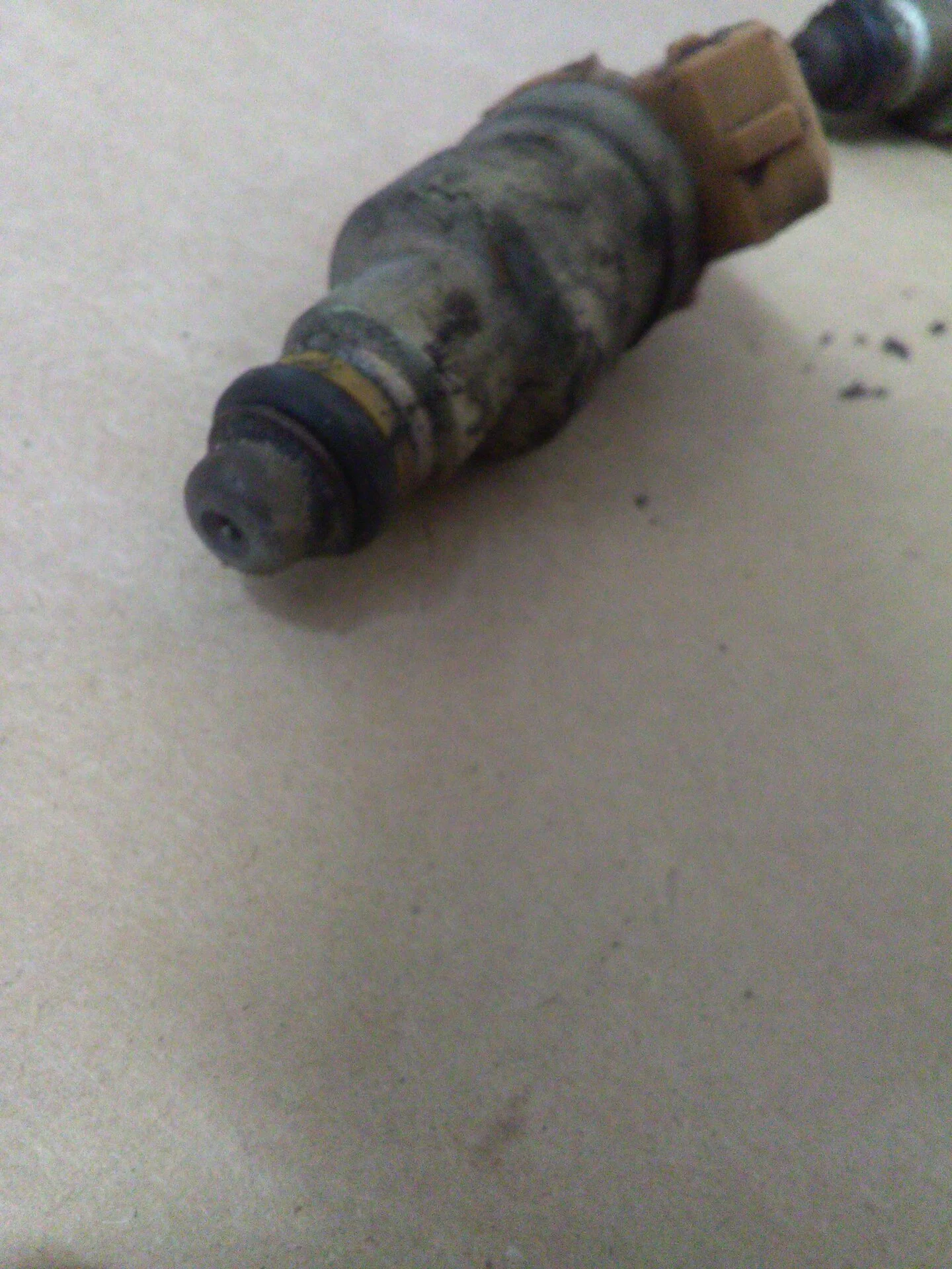

Do you guys have any thoughts, or feelings about the need to rebuild fuel injectors. I am getting the pintels , caps , and filter baskets off E Bay. What can I expect for the condition of these old injectors. Who has done them, and what was their feelings on the finished job. When I have the injectors out if I power them up with twelve volts and they fire does that mean the are good. Ready to pull the intake off, and clean / paint valve covers with a grey engine paint.
None of you guys rebuild your injectors..I would think that they leak over time
I’ve pulled injectors out with 150k plus miles on them that were fine . Send them to Eric Derr . Let him flow , clean, and change the baskets and screens for 75 bucks he charges . You’ll know they are balanced then . He did my Holley 120lb injectors in my car . Was pleasure to deal with
Need the grey that Mike 5L5 used on his spindles. Painting my valve covers, and I don't want to go overboard. I figure a nice grey, and I am painting my manifold that Alumafinish. Taking the top off to do the injectors this week. Lots of pictures coming it's been a while for pics. Thanks Mike

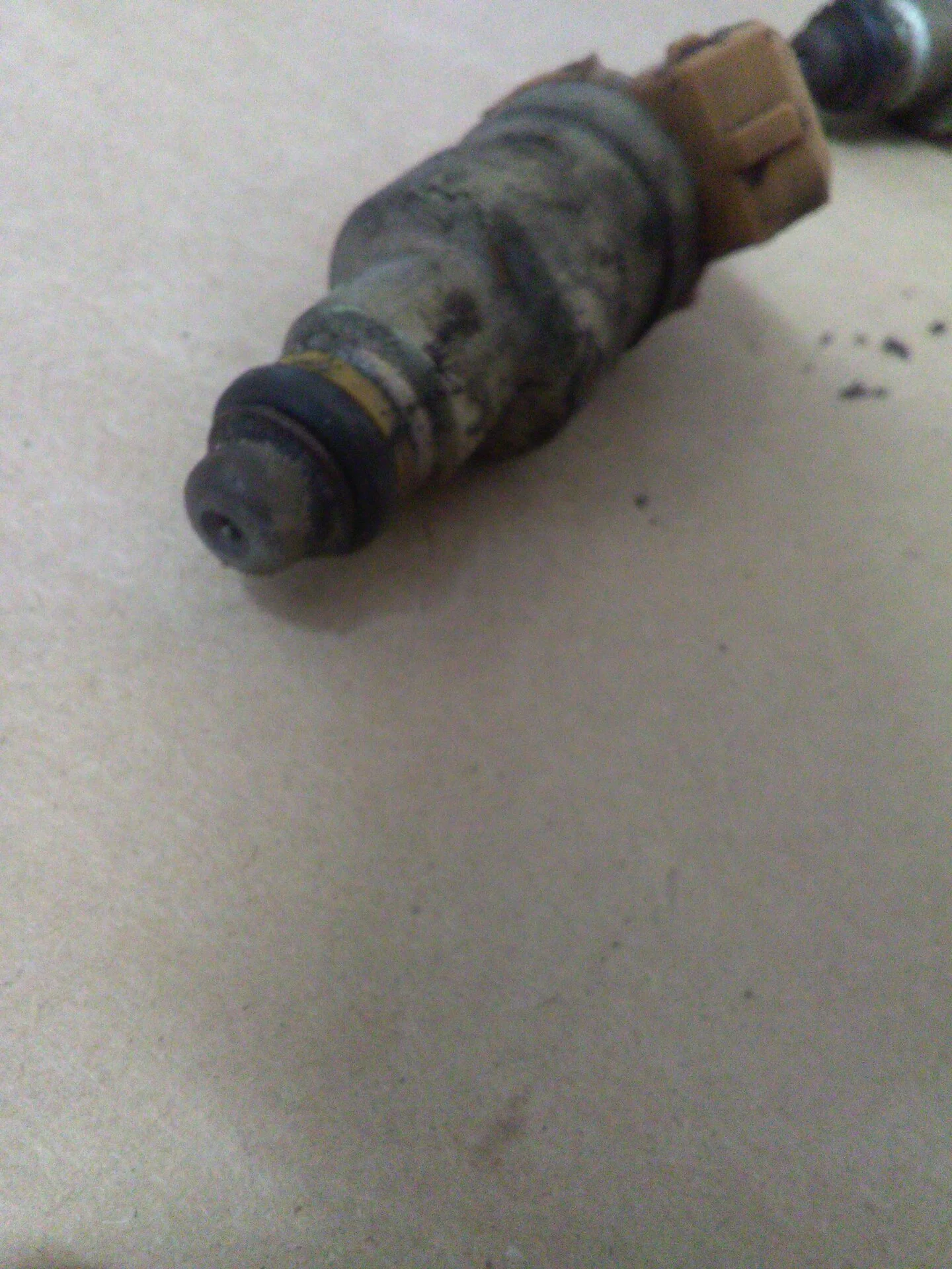

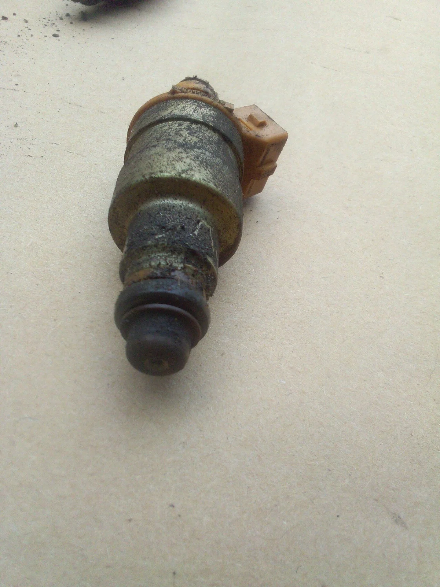

Scares the crap out of me doing this stuff hope I don't break anything. Old injectors were dirty, and crusty

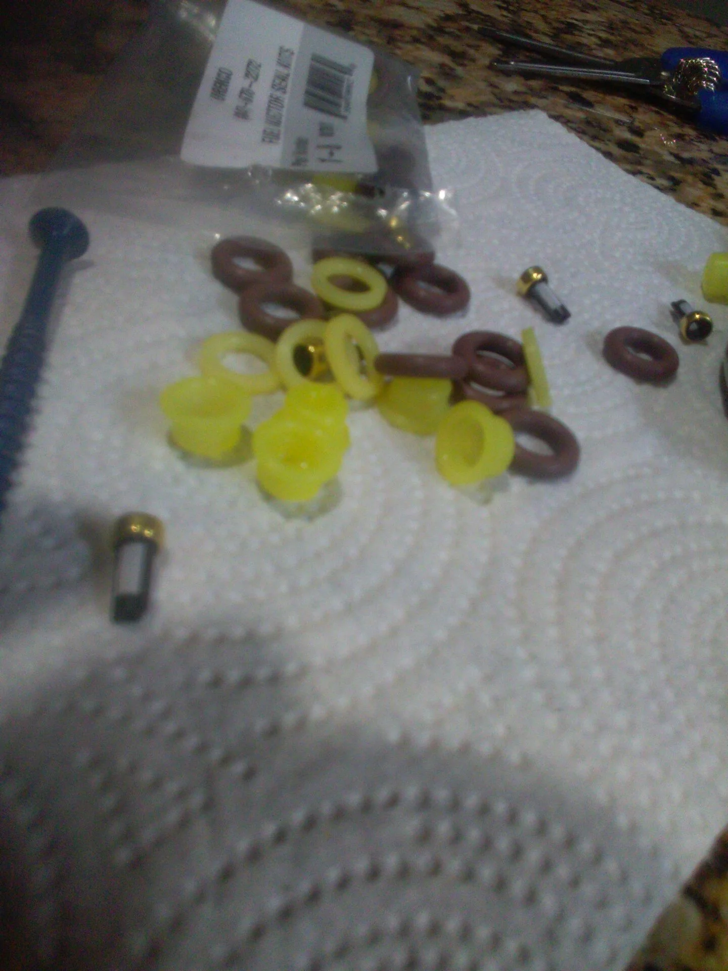

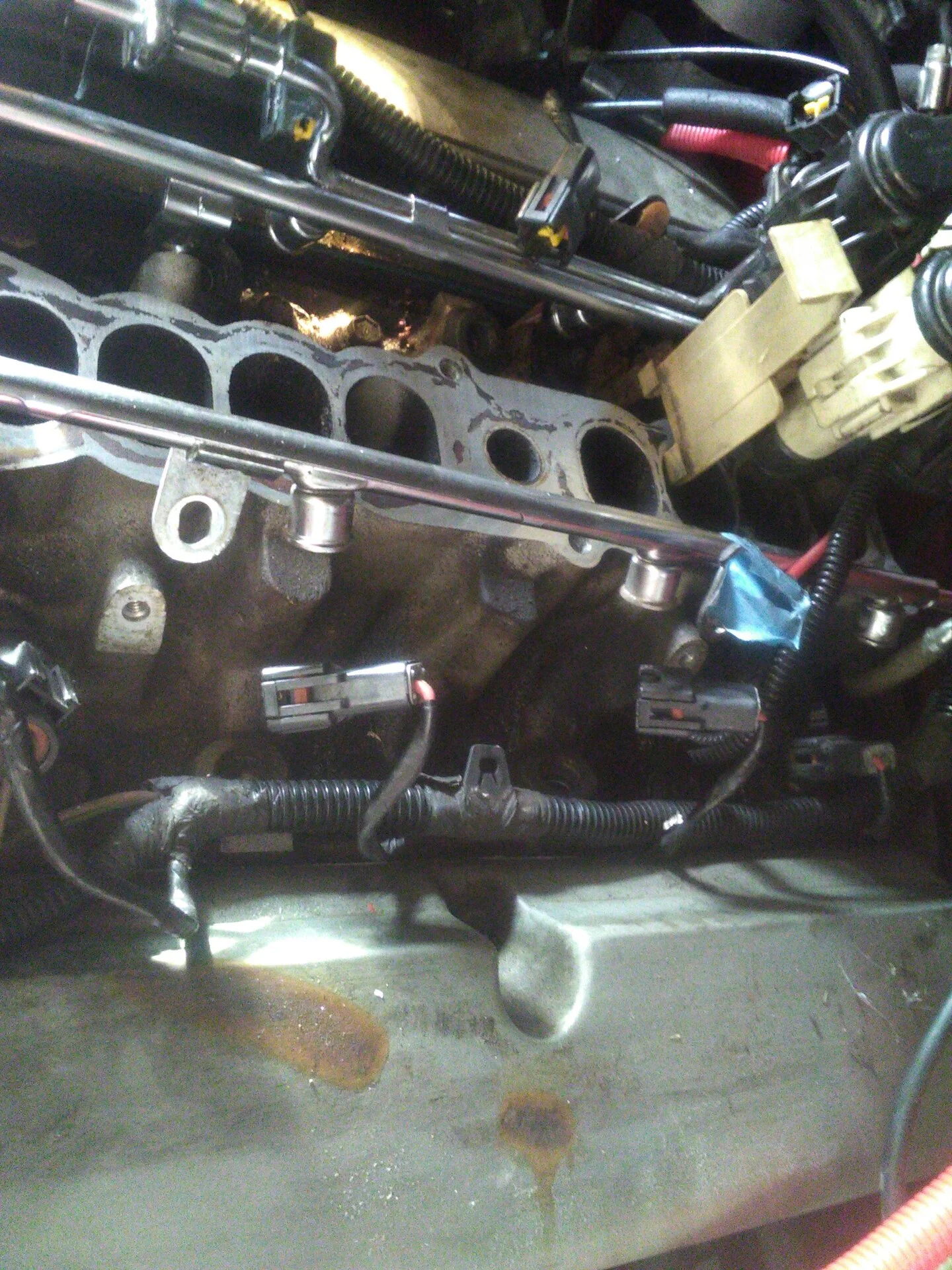

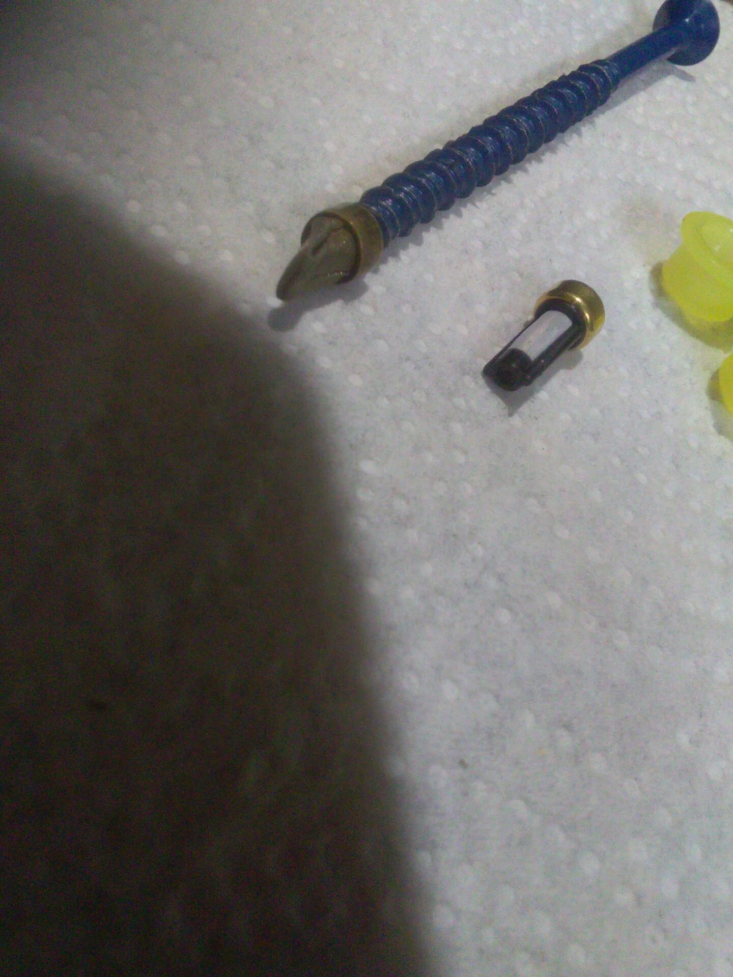

Soaked in paint thinner, and tooth brush. New caps, filters , pintels. The old filters were beat up .Getting ready to paint my valve covers New Ford Blue. Going to be a busy weekend. I have not worked on this car in a while. I think my intake was leaking. The two back bolts were loose. Should I put gasket sealer on the intake to intake. Tomorrow I will rebuild, and clean them
Good luck man!! Lookin good. Now go put some tape over that lower intake!
