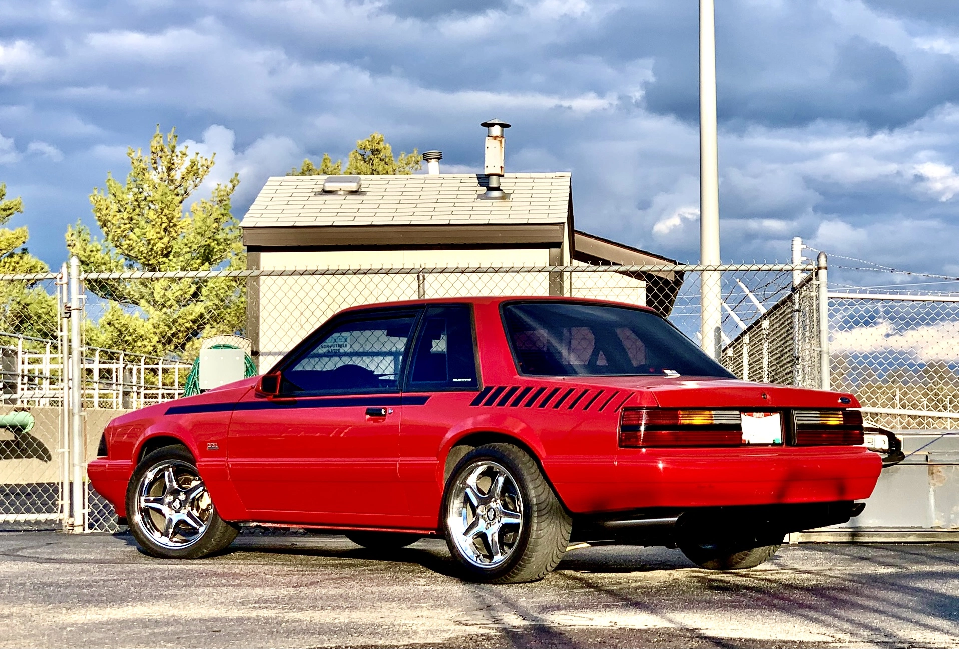

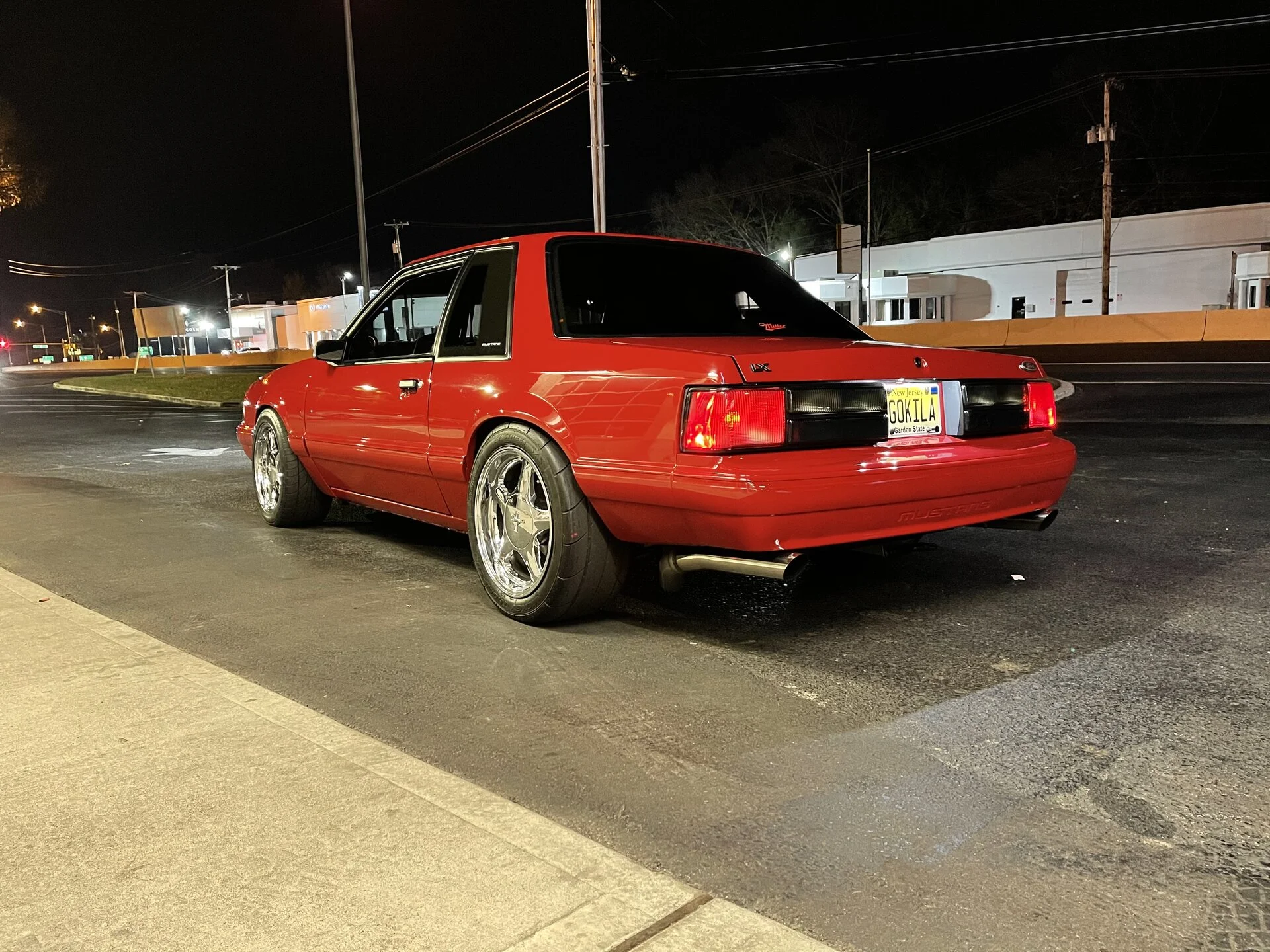

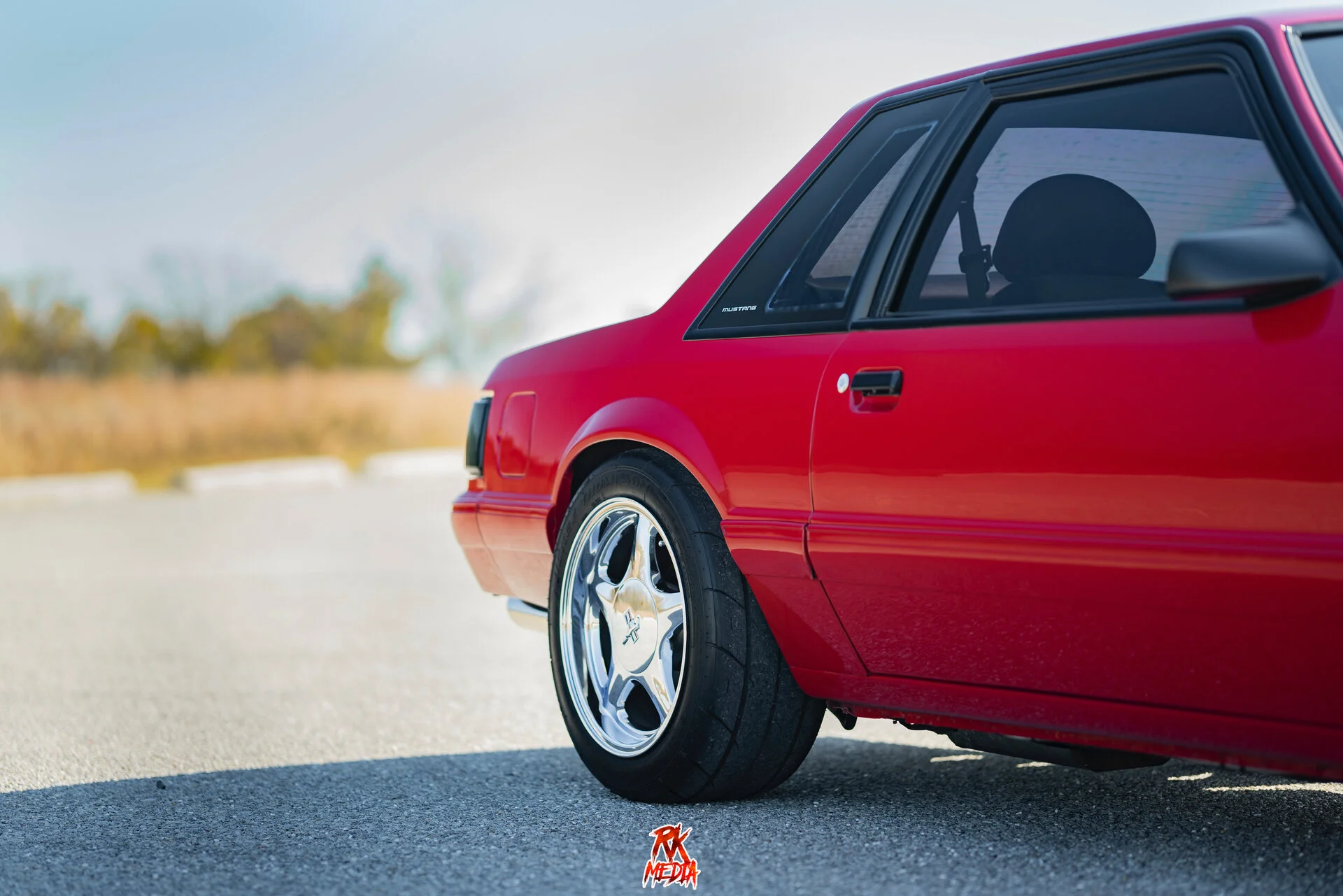

All of these are 10inch wheels over the years on my car where the lips vary, they fit fine . Given you car sits pretty high in my opinion . All you need is the quad shock removed . 275/40/17 tire and you’ll have no issue.

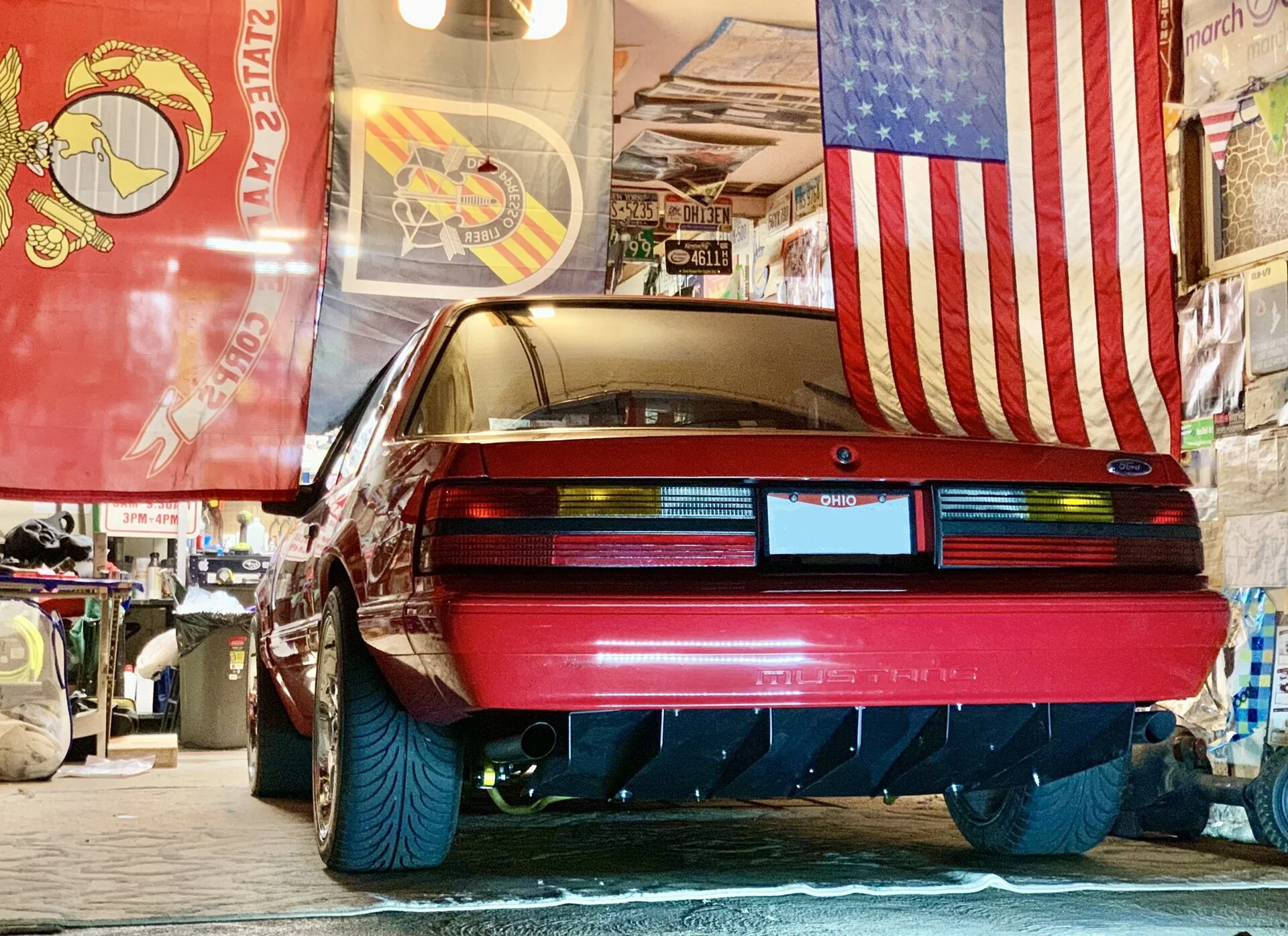

My chrome 17x10 Cobra reps. on 255/40 squared setup but I want to stagger the rear just a little bit to reduce the terrible tramlining on this car.
Edit: forgot to say no quad shocks here, either.

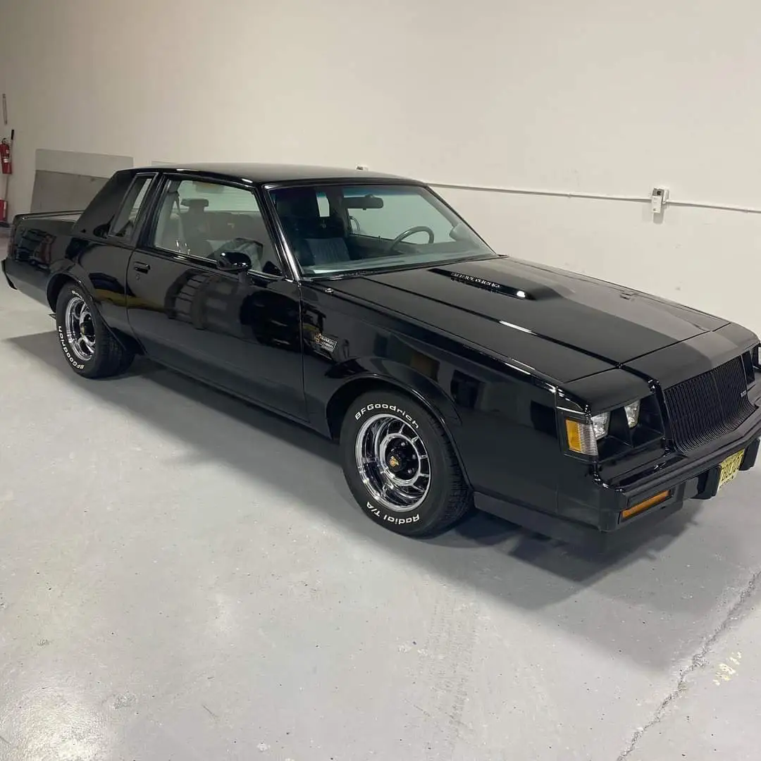

If you find someone who uses the right product and knows what they are doing it is amazing. Not cheap but amazing. Not all products are the same. From my experience ceramicpro is tops. I have someone in the family that does this. He had to get certified and maintain the certification in order to use their products. A lifetime guarantee isn't something ever shop is going to offer you with their ceramic coating but that is what I have on the buick. No more waxing, just hose it off and shammy it dry and she's good. Best thing I've ever done to the buick but if the paint was beat like the foxes are then I wouldn't waste the money.
