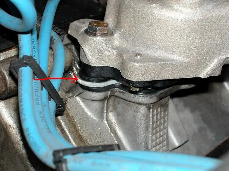

the plates aren't going to move the injectors that much farther out. the plates are like as thick as a silver dollar. The livernois plates on the other hand are quite thick. So maybe that would change the spray pattern...i don't see that happening with the united majority plates.
Heres how thick it is
What is that, 5/8 of an inch, including plate and the extra gasket required to use the plates. That is more height on an injector I wouldn't want to have. I would rather keep the injector where Ford intended it to be, but like I said earlier. Why spend at least $100.00 on something that has no proven gains when a $2.00 setup would do the same and you know with the $2.00 setup, you are not messing up the spray pattern of the fuel injector?

If you use the pi head gasket on the NPI head you only need a very small amount of RTV. Look above for pics....this has been laid out in detail numerous times. Enough that everyone here should be a pro by now. :D
