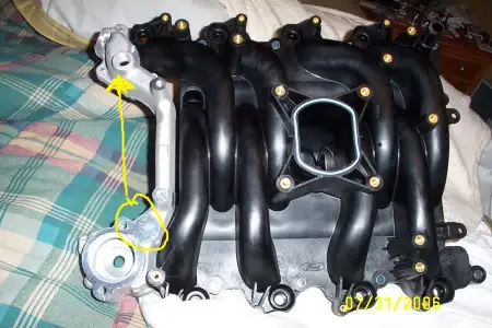

What kind of sensor is that, and where to drill and tap it ( can some one show me the pix where to drill and tap it ).
The part that is circled in yellow should be tapped to the same specs as the hole being pointed to by the arrow. The hole is 3/8-18 NPT...I had a shop do it for me since I probably would have cracked the aluminum or something trying to tap it myself. Make sure you get all of the aluminum shavings and whatever out of the coolant passage with compressed air or whatever before you put it on the car. Aluminum chunks floating around in your coolant is a bad bad thing.

I heard that if you have 02+ PI intake then you dont have to drill and tap the intake right ? I have the 04 pi intake.
Not sure on this one. When you get the manifold look and see if there are 2 threaded holes on the crossover (like in the picture I posted, 1 hole where the arrow is pointing and 1 hole where the yellow circle is). If there are 2 holes you're set, if there aren't you have to tap a hole in that spot.

You have to tap it for an 02 PI intake. I had to have my 02 intake done.
Tap PI intake - 3/8-18 NPSF with Pipe Thread. Same tap as passenger side coolant sensor, so you can tell your machine shop to match it with the other side.
