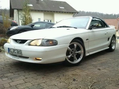

I just bought a 97 GT Conv. It has a BBK Cold Air Intake, 78mm BBK Throttle Body Plenium, Underdrive Pulleys, 3:73 Gears, E-bach Pro Susp all around. Ford Racing Alum Drive Shaft, Ford Racing Stg 3 Clutch. I am wondering how hard the PI Swap is with camshaft included. Also where is a good place to get the full kit including gaskets.
