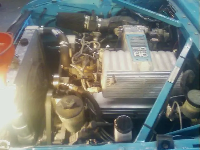

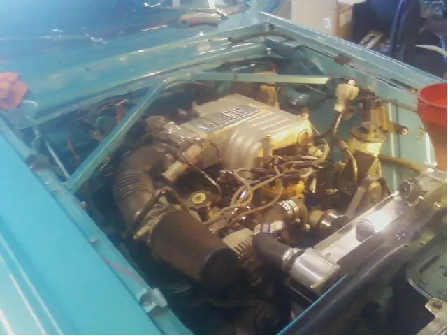

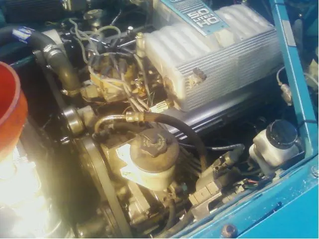

finally got it togeather
here's what i did with the motor. new rings, bearings oil pump, timing chain. reground valves and the machinist put "Z28" springs in it #110 at seat.
i put the power rack back in the car and i took a gamble and used the explorer timing cover and accessories, it worked out very well. now i have enough room between the water pump and radiator an put the fan on the engine side of the radiator and put an ac condensor in front :D, whoo hoo i can have ac for next summer now. i used the headders i had. they are flowtec 1.5 shorties for a fox body and a set of chevy plug wires for the 90 degree boot. they all clear, the closest boot is about 3/16 away from the header. i reused the 58mm tb and egr from the 86ho, ill probable upgrade later since it runs out of steam around 4800rpm.
however the used HO cam i got isn't an ho cam it has the standard 302 firing order( ask me how pissed off i was when the car ran funny at first start up) by looks i know its not a car cam(it has a fat lobe, i know the car one when i see it iv'e thrown quite a few into scrap iron). the engine is a little lacking in low end torque compared to the 86 ho and "turns on" around 2000 rpm it also seems to have a slight lope at idle, but i am unsure if its an artifact of having the wrong firing order with sequential injection. the cam when i looked at it seems to be made by ford. it has an unreadable part number and has a line of punch marks around it by the dizzy gear. i would sure like to know what it is.
anyway a few pics for ya.

Ford only made one hyd roller with the std firing order. And it definately doesn't lope. Lift specs are right around .400 with an advertised duration of about 245-250. But it does look like any other roller cam with "fat lobes"
