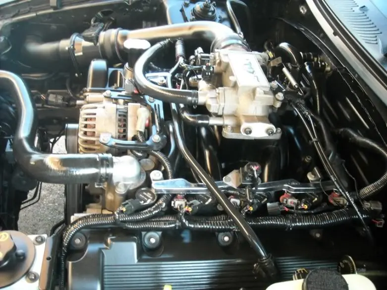

Homemade block off plate and used a 22mm dodge Ram 5.9 oil pan plug from Autozone to plug the manifold , removing the EGR tube and adapter was just silly silly hard , took me around 2 hours to get them off , some said getting the adapter out of the manifold was impossible , but it can be done !

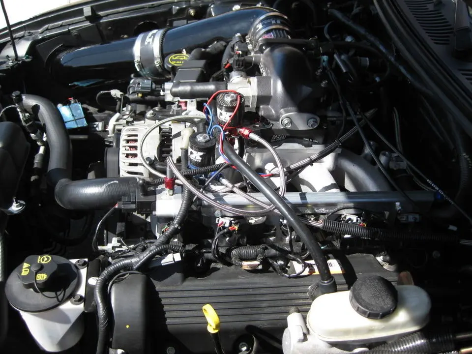

wow! that engine bay looks extremely clean and simplified, how did you manage that so well?
