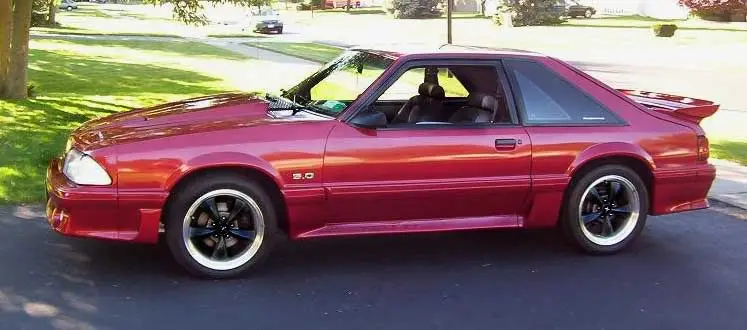

well my friend just called me , he finished up the front for me today ,even though we are still not quite finished because I dont have my front centercaps on yet . but I am doing it the cheap way with lincoln rotors , we had to use small spacers just to get the bullit wheels on without the centers , the hub was too big for wheels themselves but one 5/16th spacer fixed that , I am going to put in longer studs and 7/16th spacer and we should be able to get the center on because its close as heck already ..... worst case we should be able to use a 7/16th and one 7/64th or 2 5/16ths spacers to get centers on , the 5/16th spacers just one on each side does work with factory studs but barely .......no I am not afraid of spacers because I do believe in using a torque wrench LOL......I have 195 bucks invested in it right now .... I will keep you guys posted .....
on a side note if you plan on running 275/40/17 bfg drags , plan to break out the hammer and take off quad shocks ........might use a small spacer on the back to get little more clearance they are really close to the tail pipes ......
