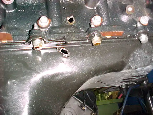

M mattstang4.6 New Member May 14, 2003 77 0 0 New Jersey Jun 20, 2004 #1 Jun 20, 2004 #1 I am not sure if the pic will post but i will try. This is a pic of my block after the rod went through it...ooops. Too much boost with a bad tune. Attachments Mvc-003s.webp 35.8 KB · Views: 210

Dan_Soprano 15 Year Member May 7, 2003 7,410 54 129 Jacksonville, FL Jun 20, 2004 #3 Jun 20, 2004 #3 Nice work bro!!! What blower were you running?
M mattstang4.6 New Member May 14, 2003 77 0 0 New Jersey Jun 20, 2004 #4 Jun 20, 2004 #4 I was running a saleen series II blower @ 12 lbs of boost. I got 8K miles out of the stock block...not too bad.
d98gt Founding Member Mar 14, 2002 4,505 59 204 SE Texas Jun 20, 2004 #5 Jun 20, 2004 #5 Did you plan on it happening?
M mattstang4.6 New Member May 14, 2003 77 0 0 New Jersey Jun 20, 2004 #6 Jun 20, 2004 #6 I had a feeling because I had some detonation the day before and did not back off enough right before it went. I mean I did not want it to break but I knew it was inevitable running high boost with the bad tune.
