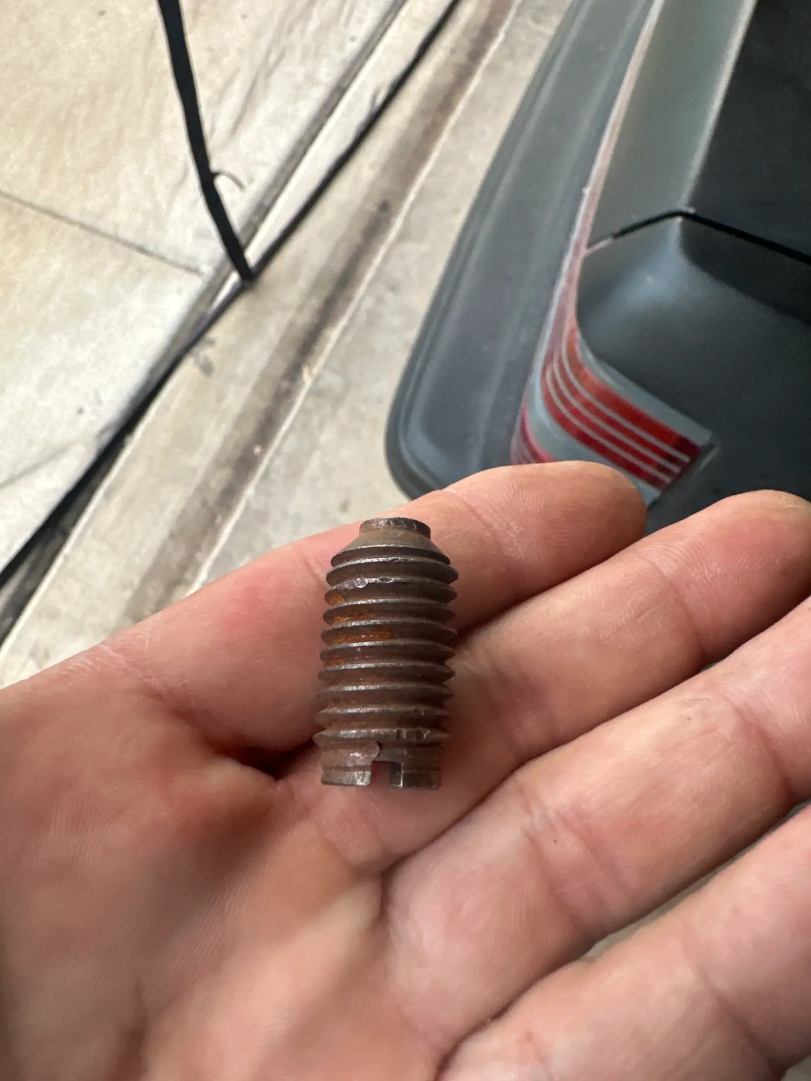

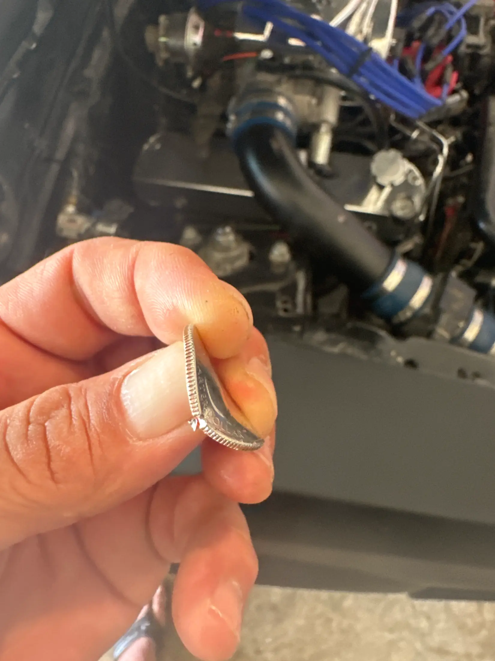

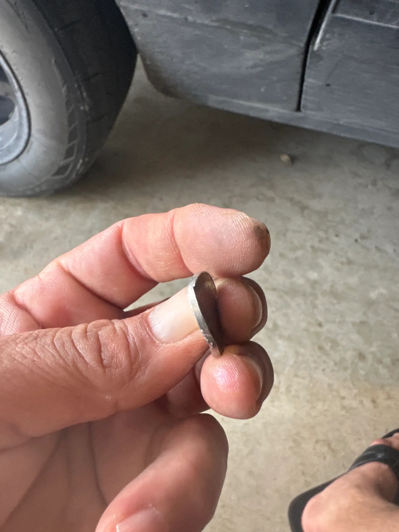

This is related to my issue that I’ve had for 3-4 months. Car running ragged. Swapped everything. I keep getting the code 41 just replaced the o2 sensor so question , I’ve heard the thermactor crossover can get “carbon blocked” what if your not running the crossover and just put in the thermactor plug. Can that area behind the plug get filled with carbon? The one I have in the pic is one I have lying around. I’m having an issue trying to remove them with a quarter it’s a tight spot and they are stuck. When I installed them I didn’t add antisize(not sure if your supposed to)

Had mine blocked off in iron heads for years with zero issues and I did use copper anti seize on mine but never removed them do I cannot say if it would have helped.

The only way I know to remove those plugs is with a large flat head or standard screw driver like blade. I would make one from a hex wrench so I could use a 1/2" rachet wrench to remove them. Crap thing is you will need to move the motor forward to get access to them or figure some other means of turning the tool.
