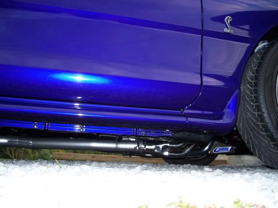

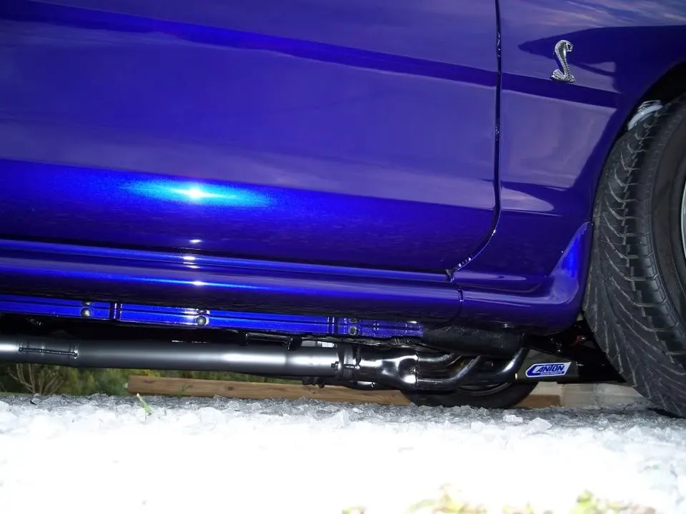

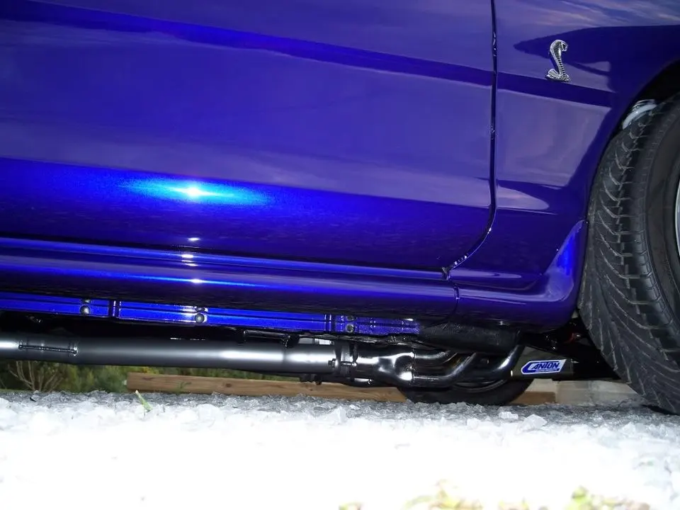

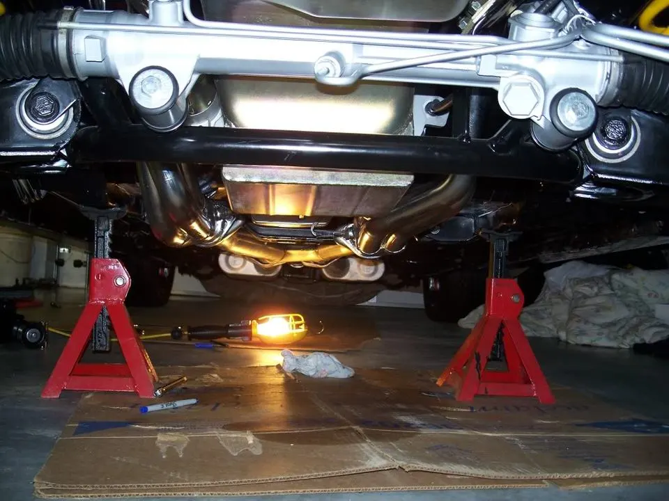

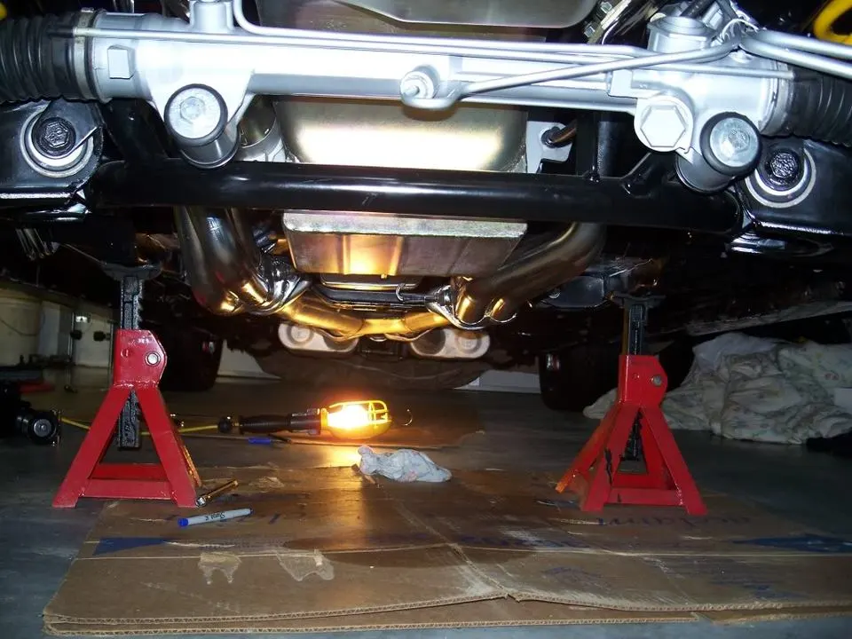

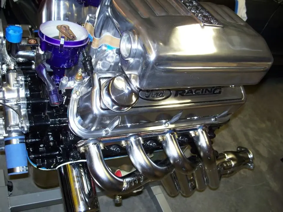

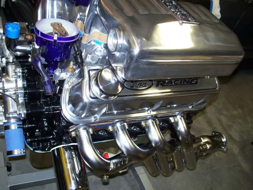

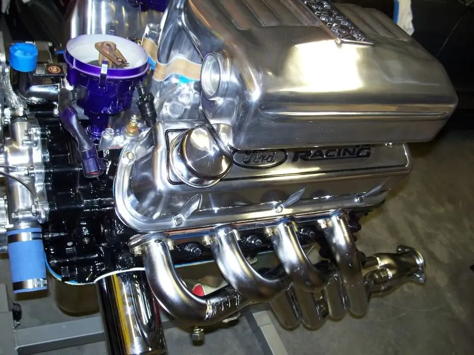

Had BBK fox 1 3/4 longtubes on my old 94. The ground clearance is not great. I have a ton of pics from this car if you need a specific shot. Do not under any circumstance get chrome ones...go with ceramic.

Thanks for those! Specifically, I was hoping to see some underside shots close to parallel with the plane of the exhaust (if that makes sense). There are quite a few pictures to be found on a google search, but they are all taken perpendicular to the headers to show the whole installation; can't discern depth or anything, so I can't tell how much ground clearance is present. I was leaning more toward the 1 5/8" BBKs since I'm only running the stock block and have no plans for a power adder. They do look different where it may count for ground clearance, so we'll see.

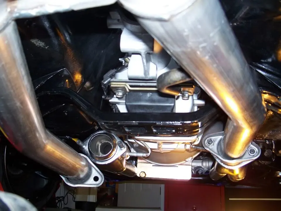

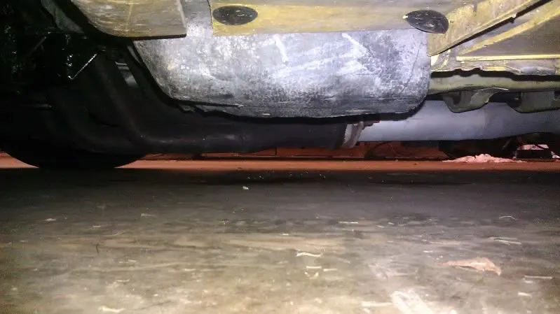

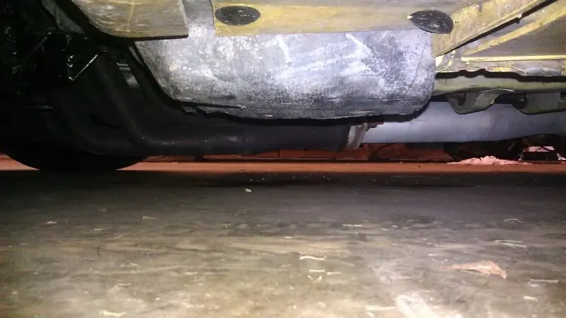

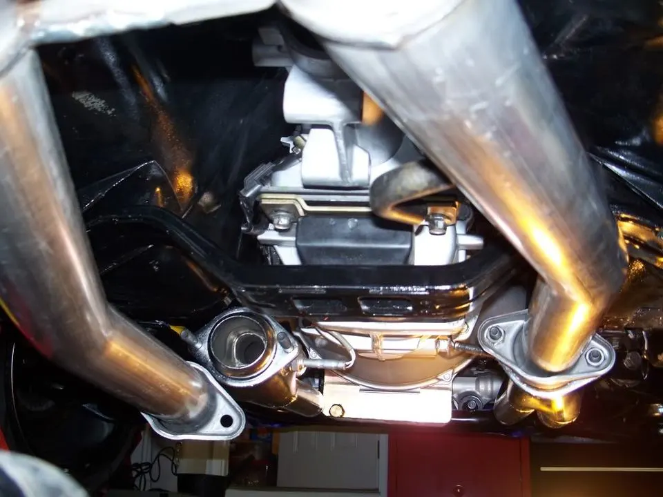

Here are a couple chassis shots when I was bending my exhaust to fit.
Hope these help. I too would go with 1 5/8 unless your going to supercharge it.

Those do indeed help! I think it's safe to say that I'll definitely get more clearance with headers other than those currently on the car. I appreciate the pictures!
