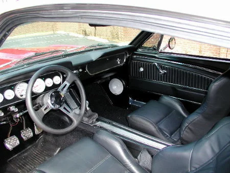

Here are some more picture of my interior.

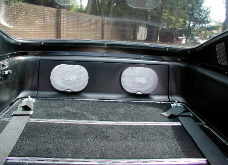

Here's a picture of the fold down section of my rear seat (amp rack and tool box platform under fold down - pics in another thread). Infinity Kappa - 6x9 speakers, pick-up point for my harness and cut pile carpet are visible in this picture.
attachment.php

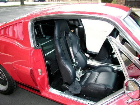

Here's a picture of my harness and new leather Corbeau seats.
attachment.php
Tim

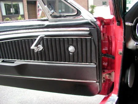

Here's a picture of my new pony door panels. I covered the pony door handle in black leather to match my new seats. You can see the accordian grommet that carries the wiring into the door.
attachment.php
In the second picture you can see the Infinity Kappa component speakers, I installed the Mid-range in the kick panel and the tweeter where the window crank was removed. The power door lock and power window switches are mounted in the console. Also, my white face JME gauges.
attachment.php
Tim
projectstang - I just picked up the pedal covers at a local Auto Zone. They are similar to these - http://www.jcwhitney.com/autoparts/ProductDisplay/s-10101/p-443/c-10101 . I went ahead and drilled and tapped my pedals and installed the covers with machine screws, instead of the clip on brackets.
65straightsick - The custom console is on the list.
kidtaurus - The wiring runs through a double ended accordian grommett - http://www.a1electric.com/Merchant2/merchant.mvc?Screen=PROD&Product_Code=Boot-Sm&Category_Code=
BLK91LX1uponu - :doh: Yea, I've got a ton of small detail items to attend to.
MrBobMarley - I'll upload the rest of the pictures to a photo hosting site when I get some free time.
Thanks for all of the nice replys.
Tim
interior looks awesome!
did you mount your harnesses to the holes for the folding seat supports? I've been trying to figure out how to put a set of harnesses in and haven't come up with much yet.
Bullitt - If you look at the first picture, you can see where the eye bolt is bolted through the rear flat panel. If you remove the panel there are two "L" brackets where the screws pass through. I had these brackets reinforced and a nut welded onto them.
I wish I had taken a picture before I put the panel and seat back in. If you pull your rear panel, it should make since. If not shoot me a PM.
