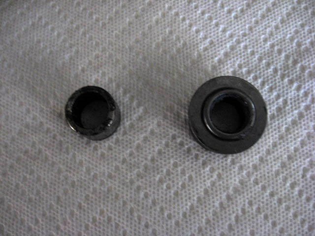

Replacing the pilot bearing while I have everything apart. I rented one from my local auto store, and it only pulled out the middle bearing. The left bearing was removed, and the right one is the replacement bearing.
I tried to hook the bearing puller into the two notches on the back of the bearing, but that didn't work. Is there a special Ford pilot bearing puller that I need? :shrug:

The problem I had is that the "hooks" on the end of the tool I rented weren't small enough to fit in the notches in the outer bearing. Looks like I rented a worn out tool. I'll be checking out my local Autozone next.
Problem solved, rented the Autozone tool and it pulled the outer race right out. For anyone else that reads this thread, be sure the hooks on the end of the pilot bearing tool you get are not rounded off. If they are, they won't grab the outer race around the bearing and you'll have to find another tool.
