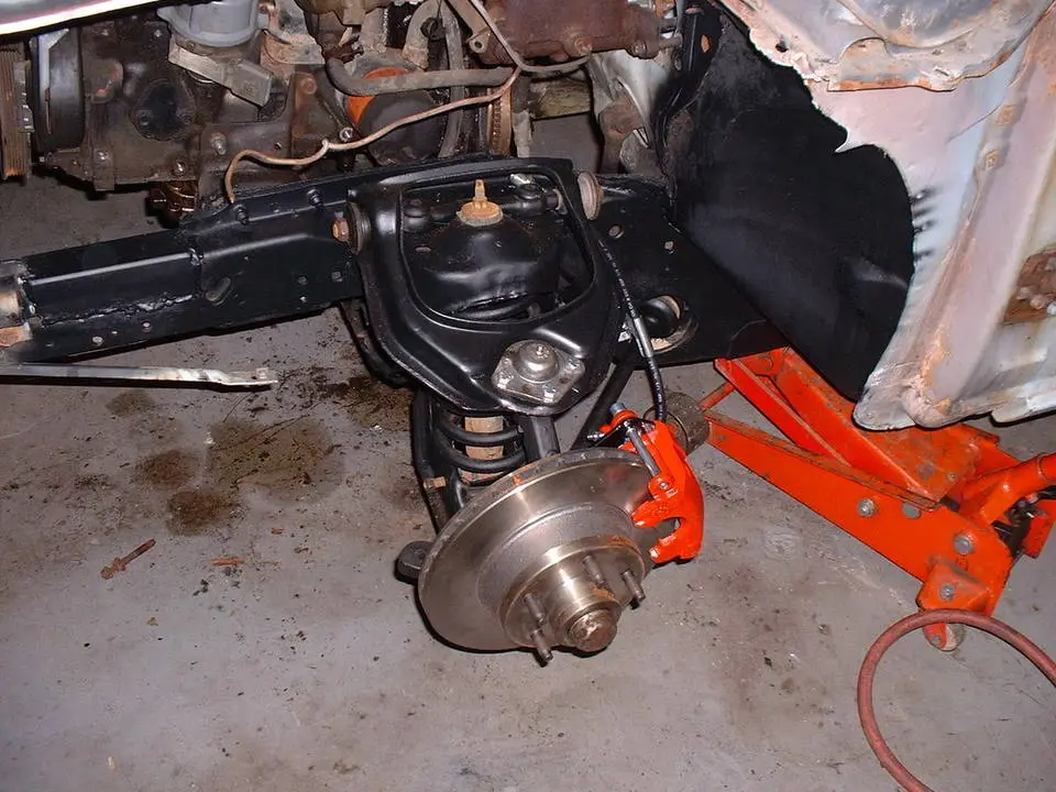

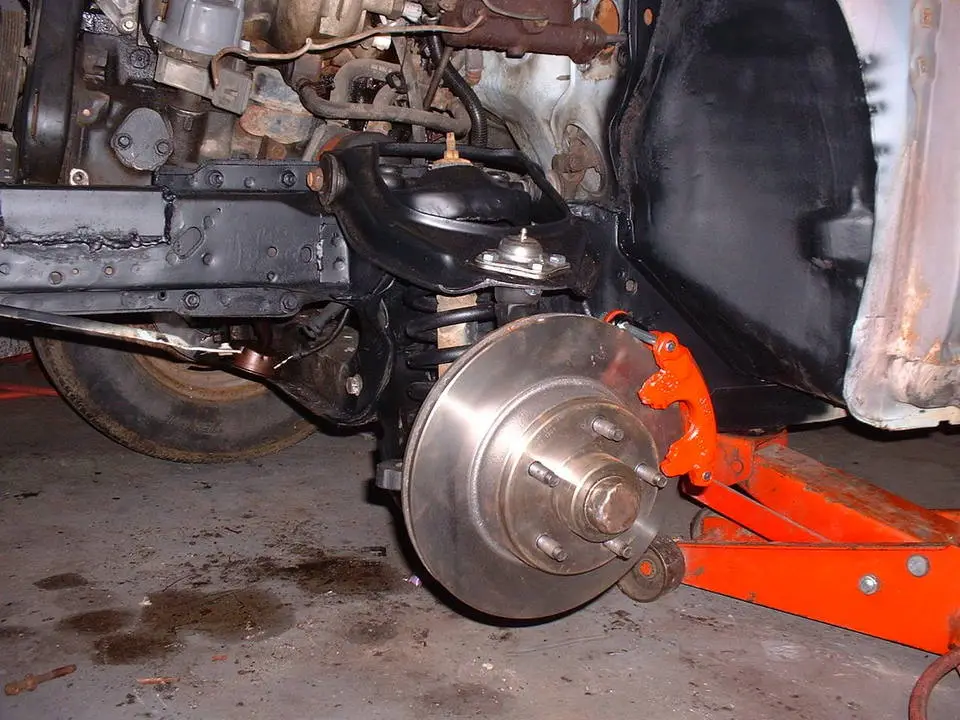

Before tearing into the 351w I figured it would be best to clear my head and work on a fresh project. So in one day Amanda and I set up little work stations for each front suspension part. Everything got cleaned, sand blasted, new bushings/ball joints(upper and lower).
I also swapped from the 9" 4lug pinto rotors to new ones for a 77 granada. These are 11", 5lug and use the same bearings and spacing as the pinto. I bought adaptor plates to use Gm "Metric" calipers from 80-87 malibu, cutlass, grand prix etc. The only thing left is to pick a much longer brake hose that fits that caliper. When turning short that hose seems to hit everything in all directions.
I also managed to trade work for some weld Prostars and tires so the front should be completely done now.

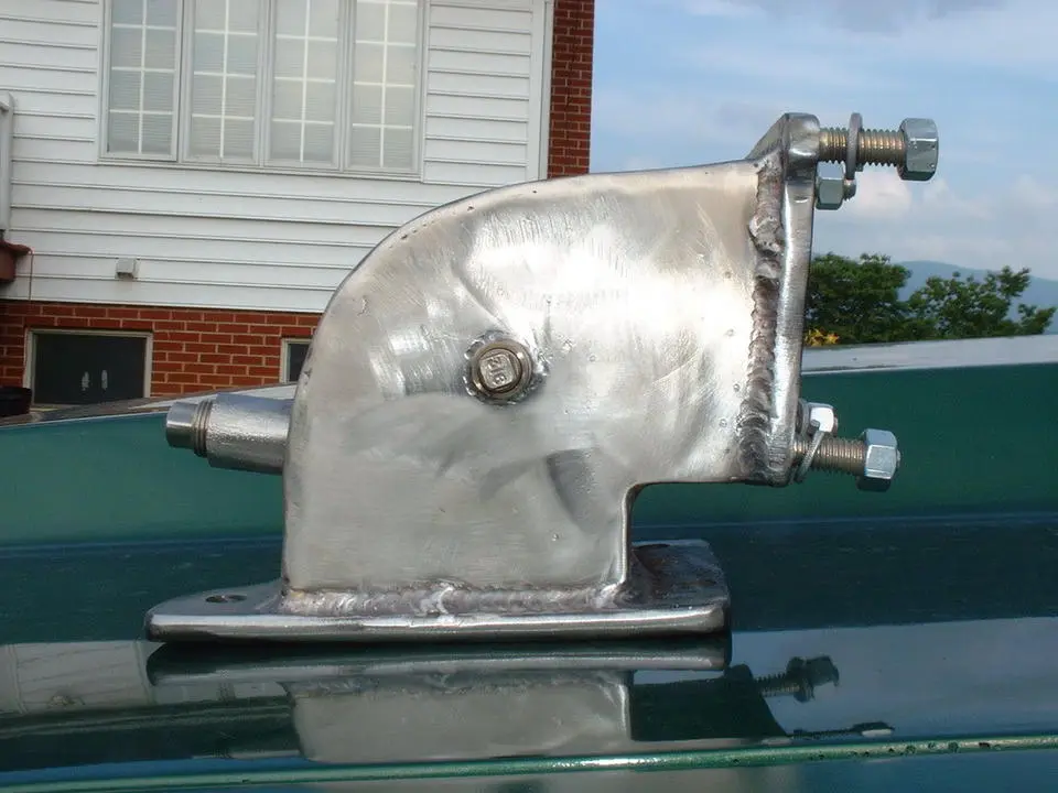

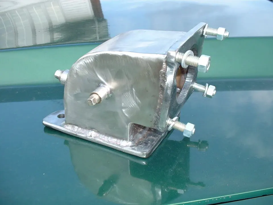

Another huge thing....A friend of mine was bored at work today and made a stainless steel box upper intake and mounted my supercoupe t-body. Its a little tall but he says he'll compensate next week when he makes the lower.

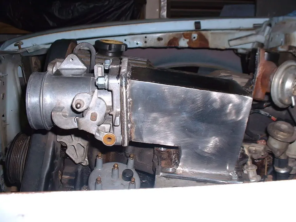

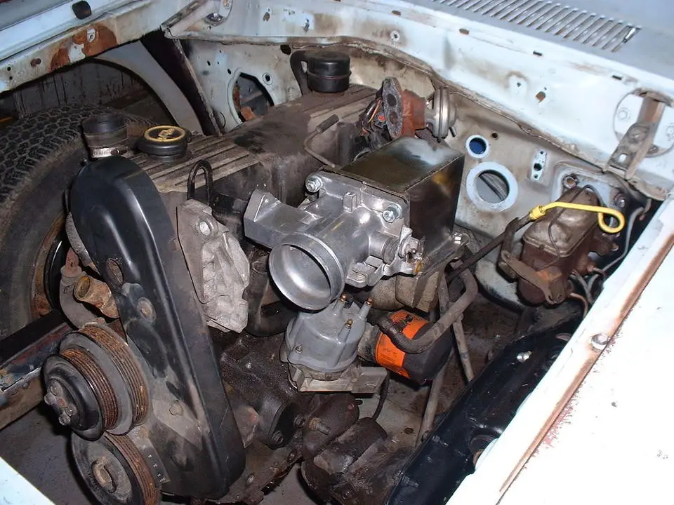

All of this started when a friend came up to the garage when I was gutting a stock upper. He laughed and took everything I had done so far and came back with a decent stainless steel box upper. We used that as a rough guide to make the one below and a little bit ago today he brought #3 by, which is a big improvement again, including the threaded pressure ports. All thats left is the throttle linkage tabs.
here's the 2nd version before being polished Notice the angle cut for the T-body bracket. That lets it easliy fit under the stock pinto hood.
Here's the same but after amanda polished the crap out of it. Love ya!
Here's the latest
and again

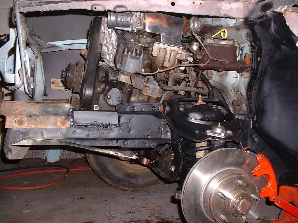

Here's the suspension. All thats left for that is to get a set of shocks and make susp. travel limiters.
