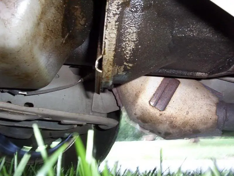

the oil looks like its coming from where the bellhousing meets the block, on that metal flashing hanging down.

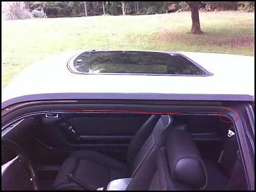

the circle shows hwo the door sags, which has made the weatherstripping not normal, and the red line is where the water sits when it rains, when i stop or the car is leanign forward down my driveway,(nose lower than rear) the water goes from this slot in the cab where that piece overlaps the next a trim piece.

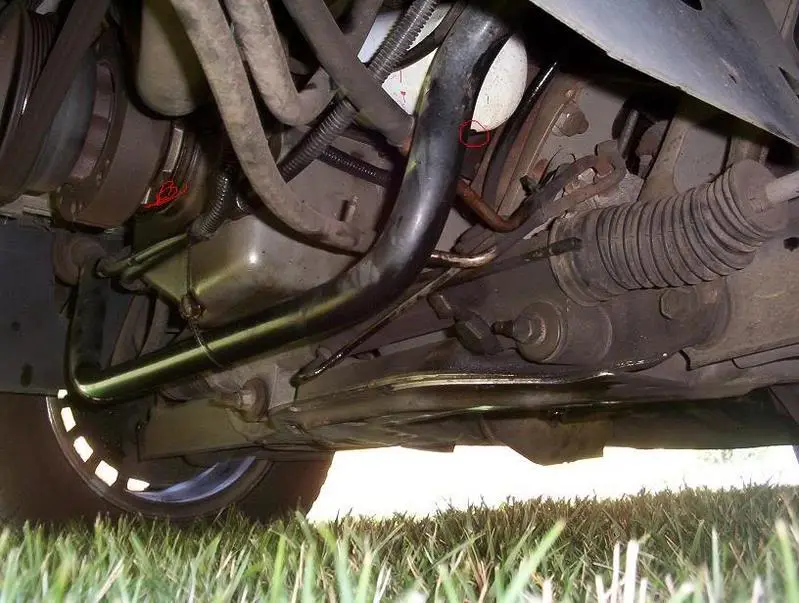

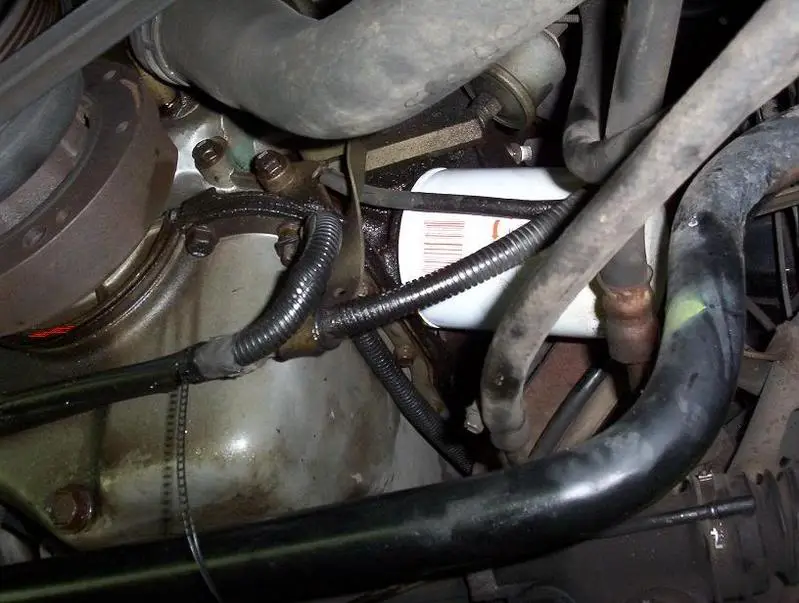

pay attention to the red marks thats where oil leaks in the front and the drip on my oil filter

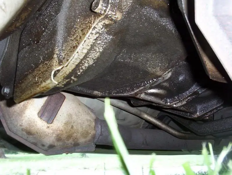

heres the bellhousing shots, you can see where it drips, if not it hangs out on that silver metal piece furthest down

sounds like you got a rear main seal leak, dont feel bad every 5.0 in existance has a rear main seal leak, as far as the seats go, I think you can just bolt em in. (the gt seats)
Mine diddnt and i know it wasnt replaced because it had the stock clutch in it and you could tell the tranny was never out. Car only had 73k when i bought it though maybe thats why.
