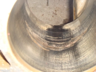

well, i don't think it matters now anyway because i think i'm gonna have to have the cylinders bored...
Might as well go .03 over now and get new pistons...

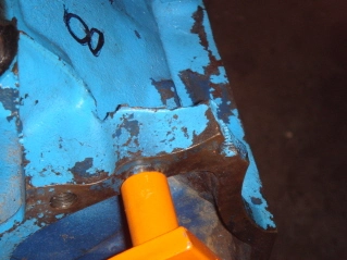

oh and could you guys take a look at the block picture I have. I don't know if this broken bolt hole will affect anything much but if it does, can it be fixed?
If not, should I just junk the engine?

I would think the price of a fresh basic 302 .30 would be the same if not cheaper than having you block fixed and bored. I remember Summit used to sell blocks for under a grand that were made by Ford.

I am not sure about your broken bolt thread, but having the block bored shouldn't be more than 150 bucks. I know many other people have had that broken thread before and have fixed it by welding the piece back on and having it re-tapped or something.

That looks like the lower bell bolt, it's probably best left as is, you've got 5 others plus the two alignment pins to keep the bell aligned & tight to the block. Also be a good excuse to look for a roller block too. What's the block's casting numbers ?

I thought boring cost a whole heck of a lot more than 150 bucks...

As for the broken bolt hole, I guess I'll just leave it if it won't harm anything.
My bud also recommended welding a washer to it.

I think with machining, you'll have to check local machine shops for pricing. Ask them if they use a torque plate when they bore, because they should. They will need your block with the main caps, and if they are a good shop, they will ask for one of the pistons that will be going into the block as well so they can do it more accurately. I paid $110 to have my 302 done, but that was about 5-6 years ago. Good luck on the build!
