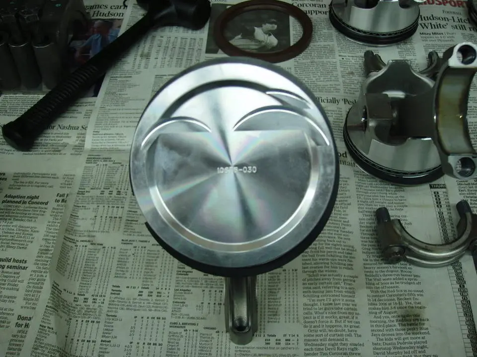

this is an srs fordged piston from chp that i run.dont mind the bearings they were just being test fit.

Are these CHP's notched for standard and twisted wedge heads? I assume so given the dual notch. What the compression ratio of that one(given a 64cc head)?

CHP/Probe pistons have valve reliefs for both inline and TW heads in their dished and flattops. If it's a dome, they only have one set of valve reliefs and you have to specify.
