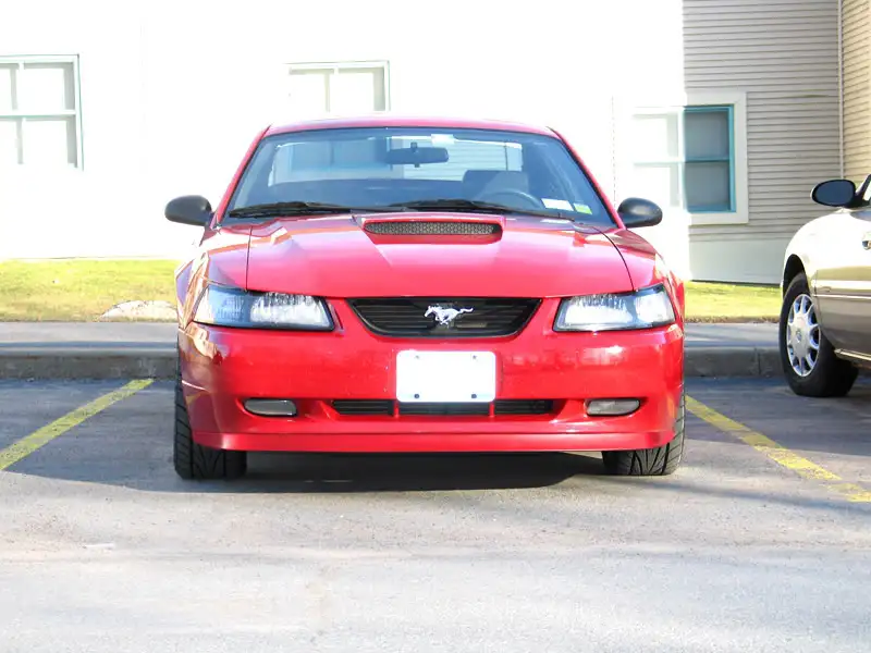

i just did a quick chop of my car with a painted chin..should give you a good idea:
wow thanks all for the replies dtnodya, i think that pic looks prety good. I think i will go with the red, seeing as pretty much nobody has that too. Is there anyway to exactly match up the color, can I get a can directly from ford or something? I want it to blend well obviously.

what is the color code on your door? performance red i believe was only on the Limited 35th Editions in 99..i could be wrong tho
btw the pic DTN posted is of my car :p
The red car in the pic I photoshopped is Nighthawk's .... My car is "chrome yellow" .. I just noticed that he pointed that out already .. :D
