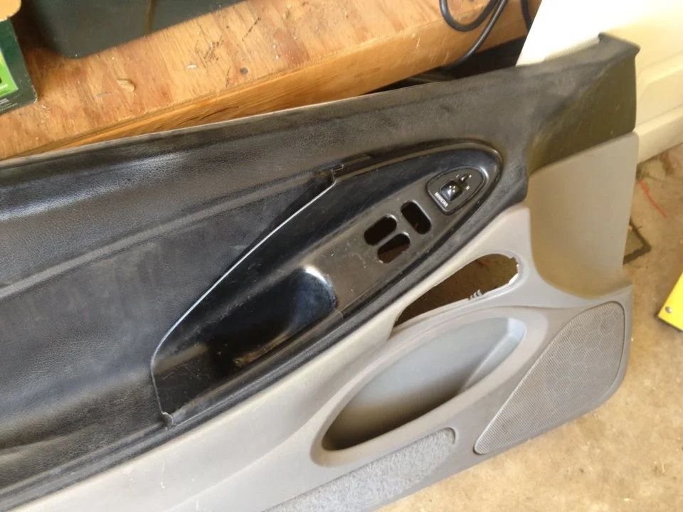

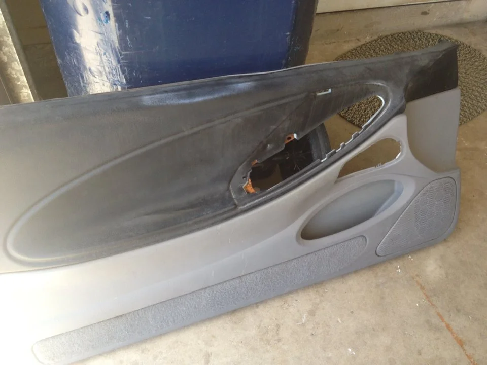

Well fellas I found a door panel in the wrecking hard for 25 bucks. It's ok just needs a little tlc. I'm gonna go ahead and freshen up the passenger panel while I'm at it so I dont have the whole "old shoe new" thing going on. What paint do y'all recommend? I need something for plastic and vinyl.
Thanks

I painted my entire interior with the duplicolor flat black plastic and vinyl dye. Used a couple coats of adhesion promoter and a couple light coats of dye. Looks amazing. Biggest thing is to make sure it is SUPER clean first. Keep in mind the duplicolor won't be an exact match. Didn't matter for me. I painted everything. I had an all blue interior and now it's all black.
