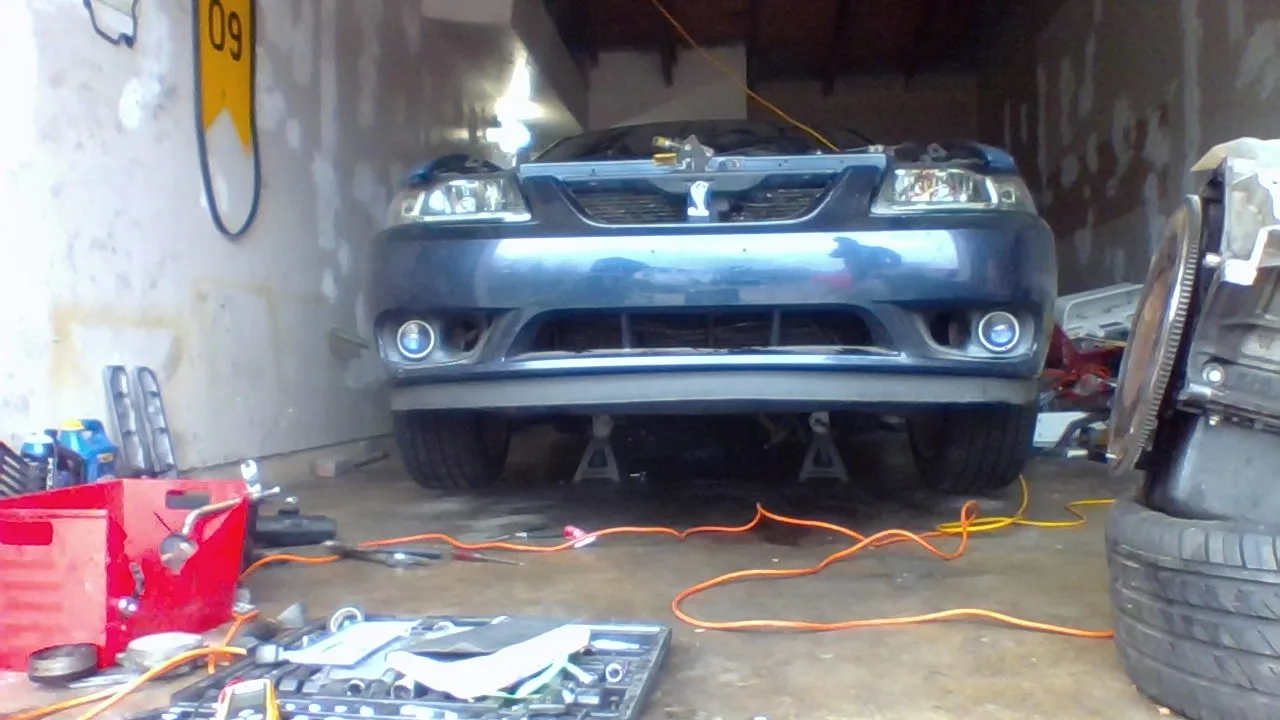

I broke my phone working on the car but I will try and post at least some picture.
