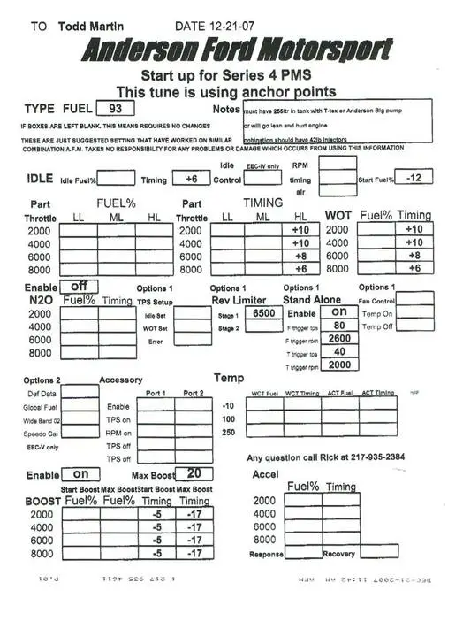

Hi i just got my start up tune from anderson ford motorsports (RICK ANDERSON) and it does not look right to me there are no fuel adjustments. Can this be a mistake or is this right?? It seems a little weird to me. Please take a look pms users and let me know What you think. My mods are ----
TFS track heet intake
TFS Track heetheads
Stock block
Procharger P1-SC @ 11psi
30 Psi injectors with procharger fmu
Pro-M univer mass air
75mm throttle body
aluminum drive shaft
3.73 Gears
Fluidyne rad
T5 with steeda shifter
bassani x pipe
bbk short headers
Flowmaster AM Thunder catback

yeah that combo should have at least a bigger fuel pump. he didn't put any fuel adjustments in there because you don't have the added fuel to support it. that seems like a fairly safe tune to me.
